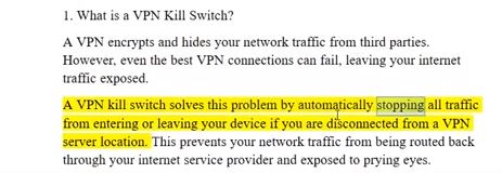

Check the VPN settings in your 360 and see if the Kill switch setting is turned on. If it is, try turning it off and test.
Thanks for the suggestion, but the kill switch has never been turned on.
