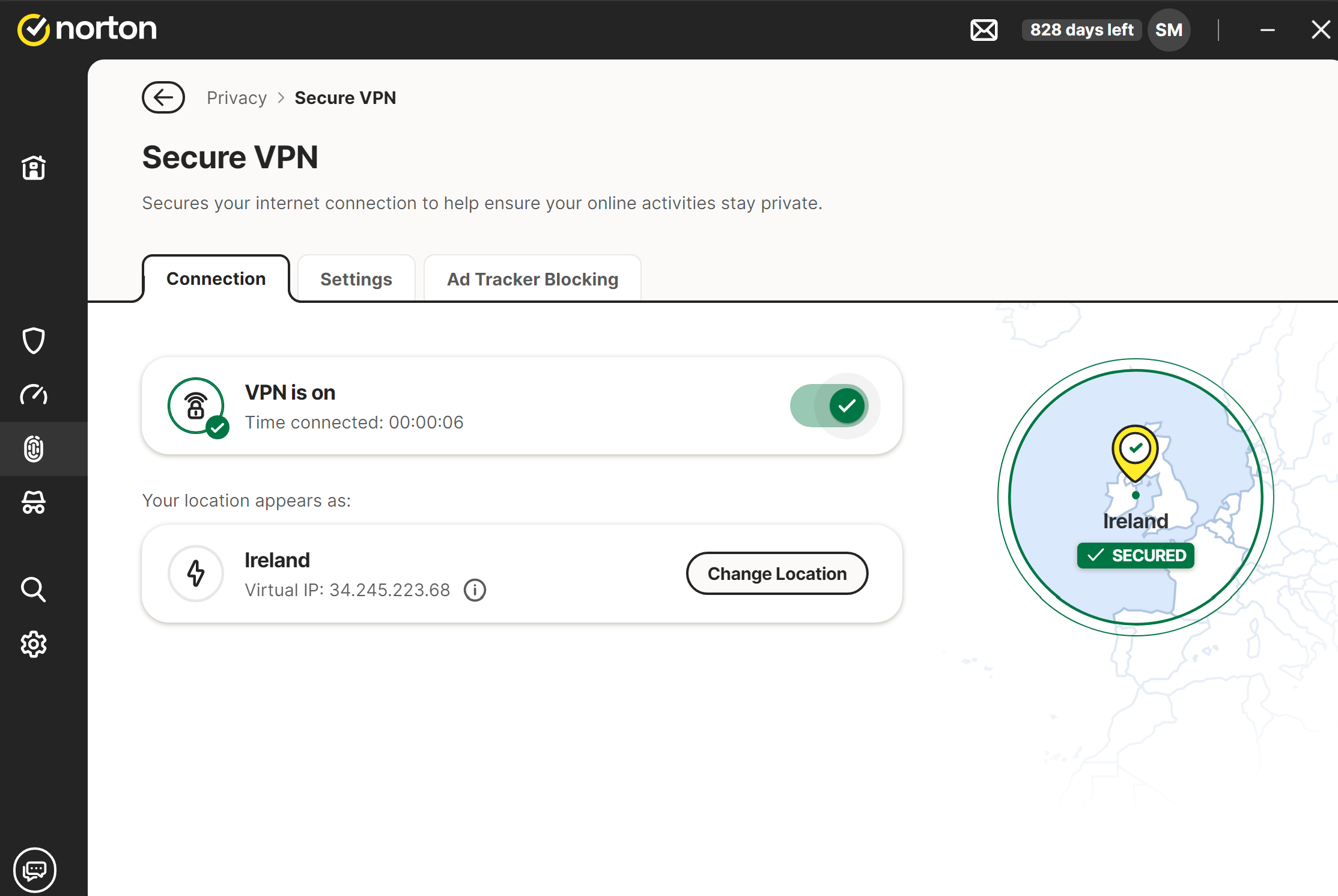

I have no idea why this worked but it worked for me.
Thank you so much Stephen.

I had to reinstall Norton 360 deluxe after my subscription lapsed. Having done so Norton VPN wouldn’t connect. I tried all the solutions mentioned here including multiple uninstall/reinstall/repair.
I looked at network adapters in Device Manager and saw there was a yellow triangle against the Norton vpn Adapter. I uninstall it and restarted the computer and hey presto the Norton VPN reconnected.
Hope that helps someone else

I tried most of the above steps, some over and over again. Cleaning registry, uninstall, reinstall, repair, etc. etc. Until I read about removing norton vpn in device manager. After uninstalling them (I had 3 I think), I rebooted the computer and tried to establish a vpn…..worked. I watched in the device manager as I clicked in Norton to open a vpn, and it installed ad new norton vpn in device manager. Maybe this will help someone else.
