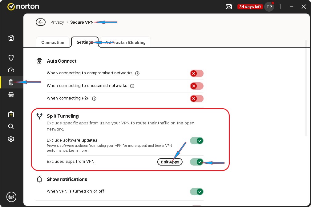

Have you tinkered with VPN settings for split-tunneling applications within Norton? Adding the printer programs. Just trying to get the one laptop in a scenario where printing works and VPN is enabled for better protection away from your local network.
I could not find anything I’d could identify as a printer program. My Brother laser has a program called iPrint & Scan, but it appears when I print, it uses a Windows driver, not the iPrint & Scan program. I did put that program in the VPN exclusions anyway, but it made no difference.

Which single VPN is it that you actually want to use on BOTH computers? Running more than one will cause serious issues. The Norton VPN will prompt you that it needs to disable itself to add an executable to split-tunnel. Once that is done reenable the VPN and recheck. If that isn’t working for you support is the best path forward.
