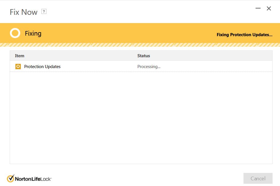

Norton antivirus - "fixing protection updates" is stuck, not completing
Issue abstract: Stuck “fixing” protection updates
Detailed description: auto updates always enabled but today this issue developed where the “fix” just keeps running after updates completed
Product & version number:
OS details:
What is the error message you are seeing? NA
If you have any supporting screenshots, please add them: yes but you won’t allow?
Have you tried a system restart. Restart, not shutdown and startup again. Often fixes require a restart to complete.
done “restart” and still issue persists - it’s stuck on “Fixing” process. Does live update “no updates found” but says there is an issue “Fix now” , click “fix now” and it does “Fixing Protection Updates” … “Processing…” but it never finishes

Edited: A possible cause is, If you are using an older 22.xx version of Norton the intelligent update service is no longer active.
Norton version 22.21.5.44
This just happened within the past week, everything was good and working flawlessly up to then

@scott_miller4 Version 22.21.5.4 is no longer supported. No product upgrades or A/V definitions are being pushed.
