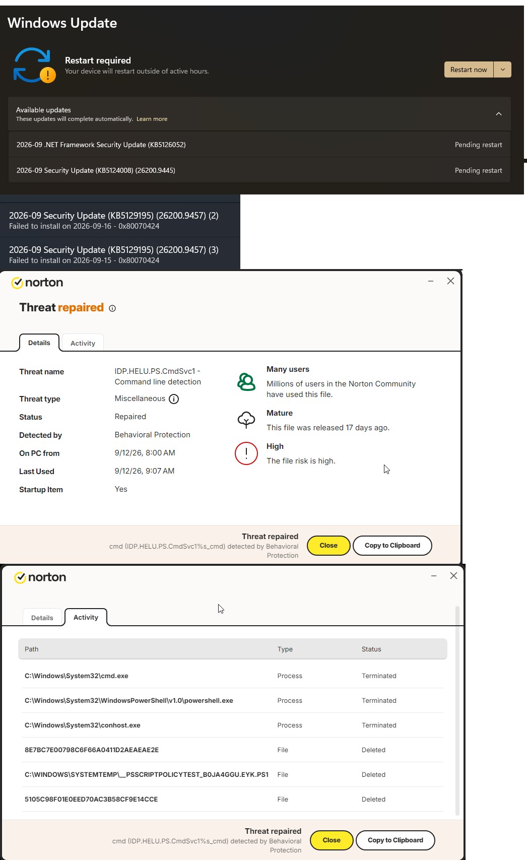

Issue abstract:
Norton 360 Behavioral Protection detected IDP.HELU.PS.CmdSvc1 - Command line detection during a Windows Update operation. Norton terminated legitimate Windows processes including cmd.exe, powershell.exe, and conhost.exe, and deleted a temporary PowerShell __PSScriptPolicyTest_*.ps1 file.
While Norton protection was active, Windows Update repeatedly showed Restart required, and restarting the PC multiple times did not complete the updates. After I temporarily stopped Norton protection and restarted Windows, the pending Windows Update completed successfully.
I would like Norton to confirm whether this detection is a false positive and whether it has been fixed in the latest Norton 360 26.9 release.
Detailed description:
On September 12, 2026, while Windows Update was installing September Windows updates, Norton Behavioral Protection generated the following detection:
Norton reported the threat as repaired and performed the following actions:
  • C:\Windows\System32\cmd.exe — Process — Terminated
  • C:\Windows\System32\WindowsPowerShell\v1.0\powershell.exe — Process — Terminated
  • C:\Windows\System32\conhost.exe — Process — Terminated
  • C:\WINDOWS\SYSTEMTEMP\__PSSCRIPTPOLICYTEST_B0JA4GGU.EYK.PS1 — File — Deleted
  • 8E7BC7E00798C6F66A0411D2AEAEAE2E — File — Deleted
  • 5105C98F01E0EED70AC3B58CF9E14CCE — File — Deleted
Norton showed:
  • Detected by: Behavioral Protection
  • Status: Repaired
  • Startup Item: Yes
  • On PC from: 9/12/2026 8:00 AM
  • Last Used: 9/12/2026 9:07 AM
At the same time, Windows Update repeatedly showed updates as Pending restart. I restarted Windows several times, but the updates would not finish.
I then temporarily stopped Norton protection and restarted the computer again. The Windows Update immediately completed successfully after Norton was stopped.
This makes me suspect that Norton’s Behavioral Protection was interfering with a legitimate Windows Update/PowerShell servicing operation.

Supporting screenshots:
I will attach screenshots showing:
  • Norton IDP.HELU.PS.CmdSvc1 detection details
  • Norton Activity page showing terminated processes and deleted files
  • Windows Update pending restart/failure information
  • Current Norton 360 version information
