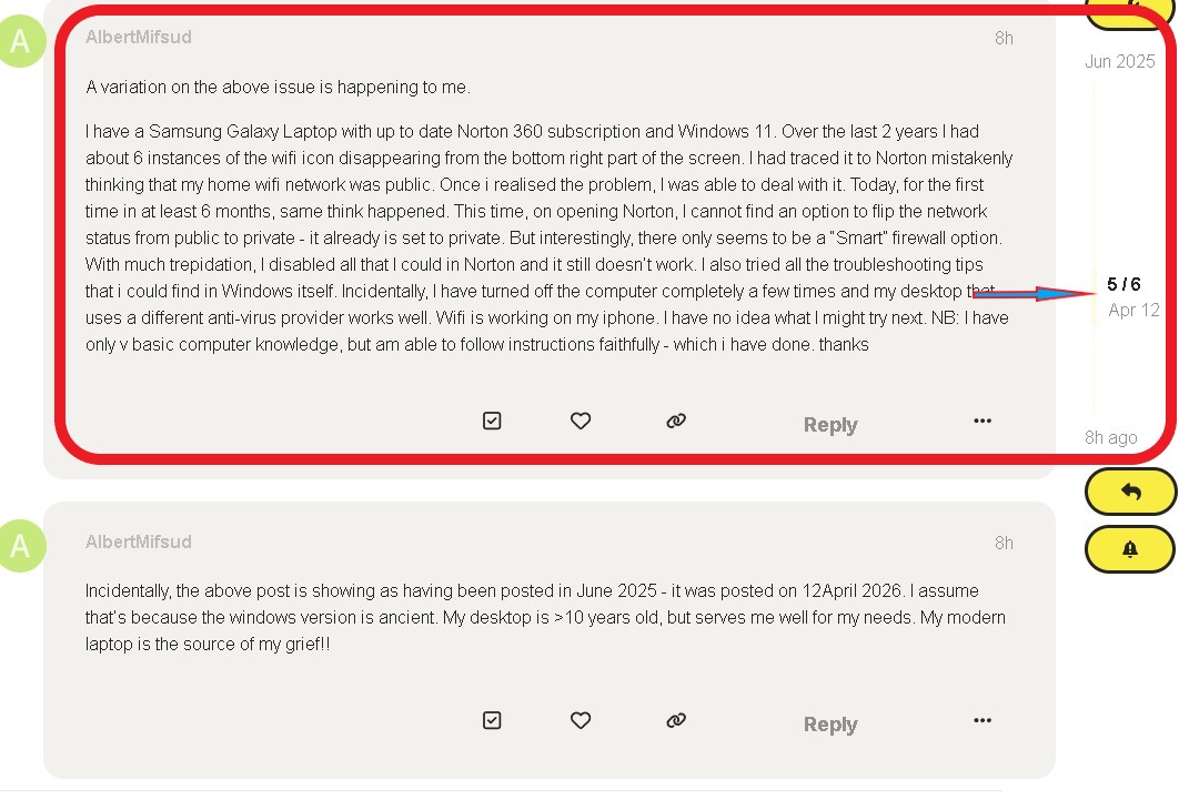

A variation on the above issue is happening to me.
I have a Samsung Galaxy Laptop with up to date Norton 360 subscription and Windows 11. Over the last 2 years I had about 6 instances of the wifi icon disappearing from the bottom right part of the screen. I had traced it to Norton mistakenly thinking that my home wifi network was public. Once i realised the problem, I was able to deal with it. Today, for the first time in at least 6 months, same think happened. This time, on opening Norton, I cannot find an option to flip the network status from public to private - it already is set to private. But interestingly, there only seems to be a “Smart” firewall option. With much trepidation, I disabled all that I could in Norton and it still doesn’t work. I also tried all the troubleshooting tips that i could find in Windows itself. Incidentally, I have turned off the computer completely a few times and my desktop that uses a different anti-virus provider works well. Wifi is working on my iphone. I have no idea what I might try next. NB: I have only v basic computer knowledge, but am able to follow instructions faithfully - which i have done. thanks
Incidentally, the above post is showing as having been posted in June 2025 - it was posted on 12April 2026. I assume that’s because the windows version is ancient. My desktop is >10 years old, but serves me well for my needs. My modern laptop is the source of my grief!!
@AlbertMifsud Your previous post shows April 12, 2026 in the far right column per this screenshot:
