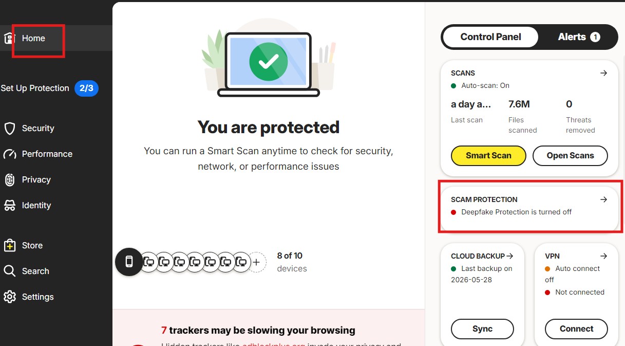

Are the videos from YouTube? This might be related to the DeepFake scanning in 360. From the main 360 interface, click on Scam Protection and turn off DeepFake Protection.
I have that feature disabled and still Norton consumes 100% of my GPU. Oh, and the videos are youtube videos. I should also note that I have 3 other computers running Windows 11 and Norton 360. I have not seen this issue on those machines. They do have different hardware and the software installed on these machines is different (they have different uses so not all the same software is installed).
