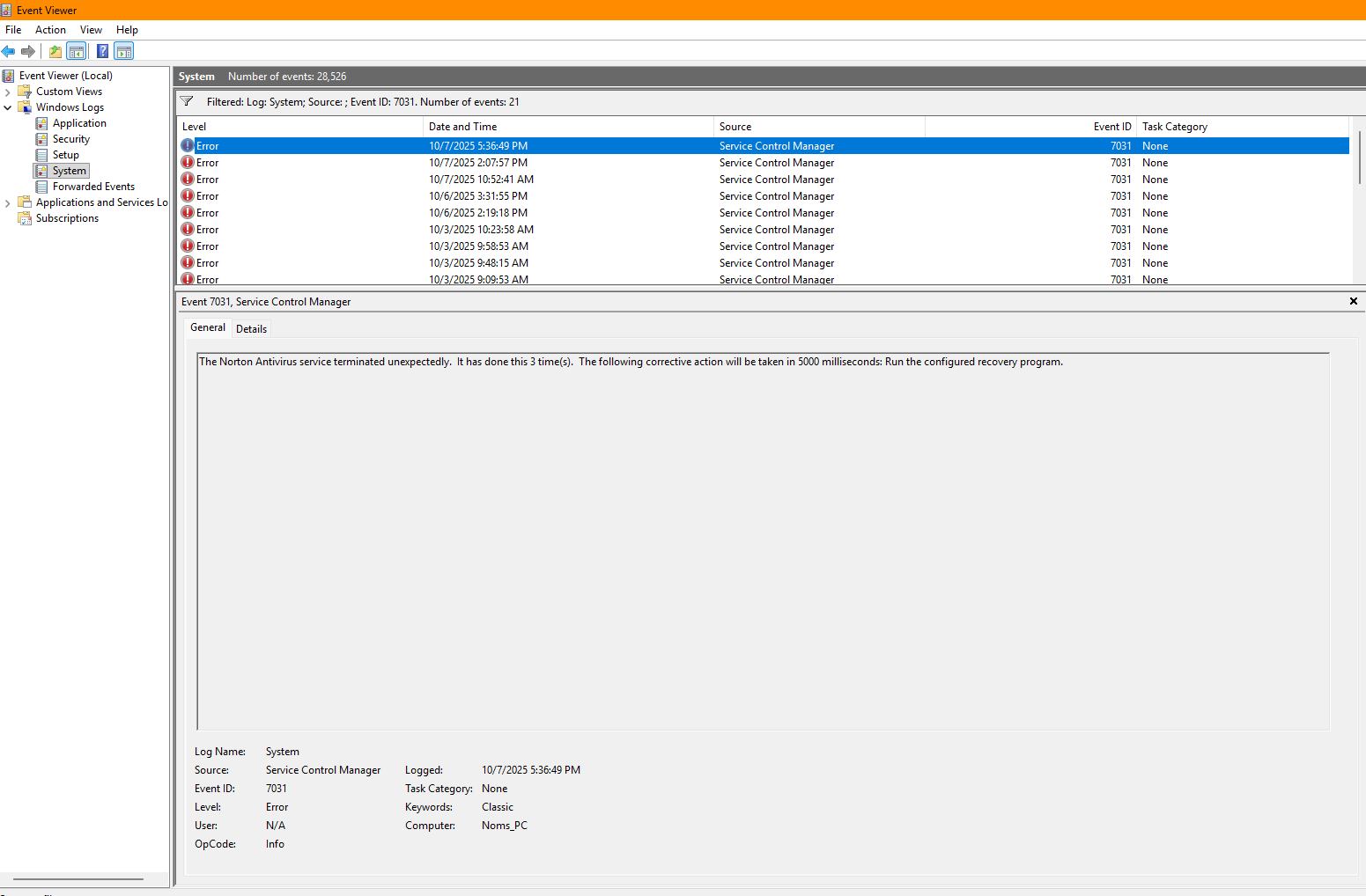

Event viewer shows Norton crashes then my network cuts out in a weird manner. Only my Desktop loses connection and nothing else crashes. Any ongoing connections like calls/meetings still work for 1 - 3 mins oddly. This has happpened since Sept 23rd almost daily now.
I’ve tried flushing DNS, disabling smart firewall, disabling Windows firewall, Windows updates, repairing the Norton within the program’s settings, restarting Norton Windows Services, and various programs/browsers to see if anything works. The only fix is rebooting my PC all together (I even replaced my router just in case)
Error
“The Norton Antivirus service terminated unexpectedly. It has done this 3 time(s). The following corrective action will be taken in 5000 milliseconds: Run the configured recovery program.”

What “specifically” does the DNS warning say? Do you have a screenshot to share? Screenshot of your event viewer specific to this issue would also be great to review. Is your VPN active when this happens and what is logged in your Norton history that is related?

Tragically my idiot self clicked Clear Log instead of Filter Current Log so I’ll need to wait for another crash. No VPN actively in use (2 running in background in case I need them and always have been for years)

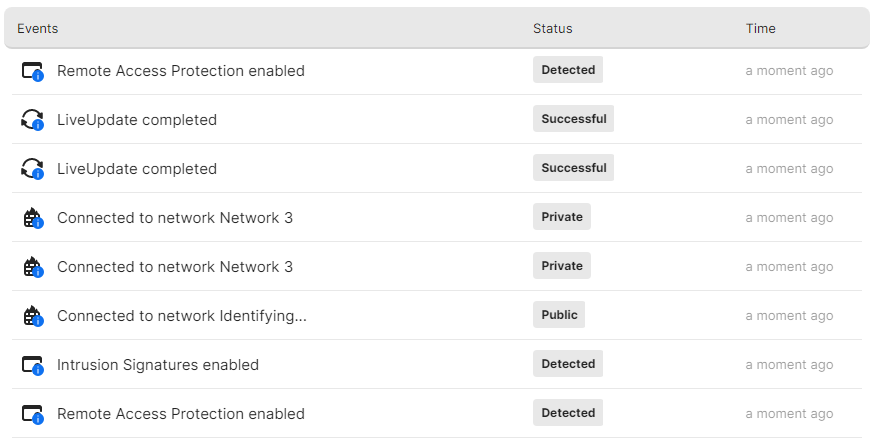

Norton Security History just shows allowed ‘Rule Windows Networing In Allowed UDP(17)’ up until the crash.

@Nononom12 is your Norton history filling up with the UDP 17 entries? If that is the case have a look at this thread from earlier this year:

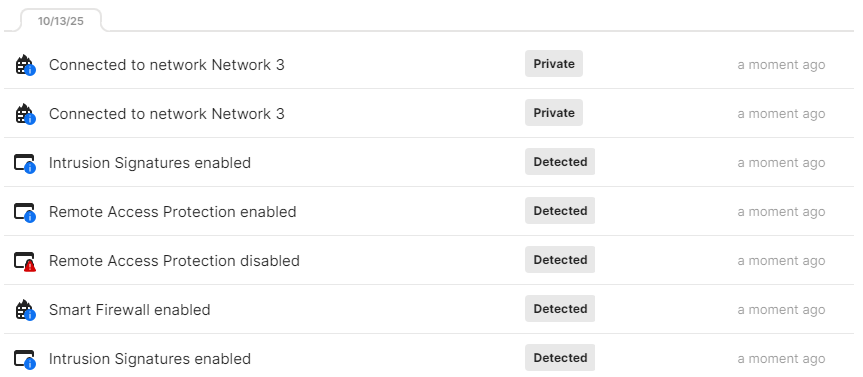

Happened again this morning. Smart Firewall was disabled at the time and Security history doesn’t have any smoking guns. Event viewer same old Norton crashed right before it happened
