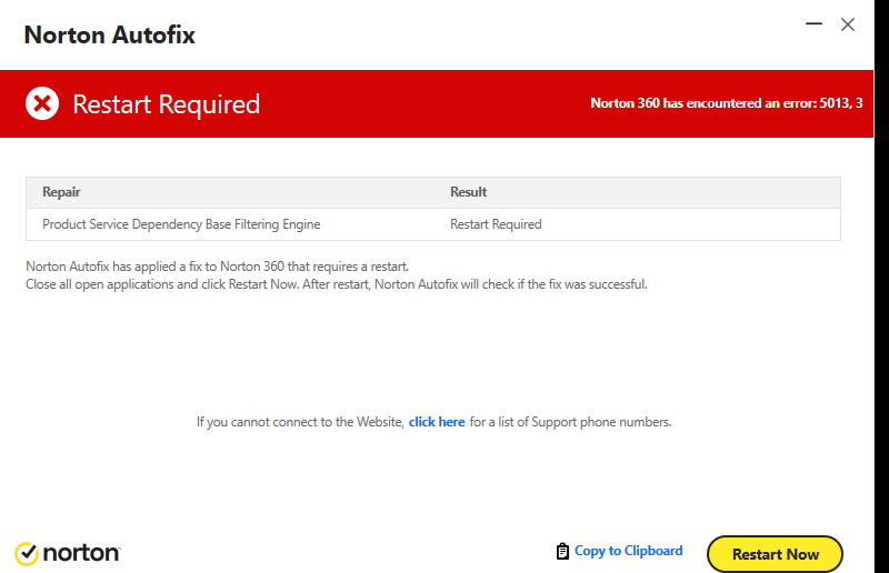

Norton error YOU ARE UNPROTECTED, please click here to repair
When I click this is what I get:
22.25.3.5
BucketID: 0CA3E5F2
Windows 10 Pro
19041.1.amd64fre.vb_release.191206-1406
Norton Autofix Results: 0 item(s)
This happened befroe, and it will happen for another 6 months before Norton Liveupdate stops working just like before. I get a pop up box in the right hand courner of my screen telling me there is a error with Norton. But I get the above when I click it.
I already removed Norton 3 times, and reinstalled. the pattern is to effective to be random. After a install It allowed me to update norton, it will fine for 3 - 5 days, then the pop-up errors start and continue for 2 or 3 months no matter what I do, then I will not be allowd to connect to Live update.
An Norton has followed the pattern 3 - 4 times like clockwork.
I checked all the usually thinks, I looked in the register, I looked in my processes, etc I cannot find ANYTHING or reason that Norton is doing this over and over. The next time I get the pop up I will update this post.

Hello @Robert_M2
Is Norton 360 version 22.25.3.5 your current installed version, and if so, are you intentionally remaining on v22?
Are you intentionally using an old offline installer?
Intelligent Updater has been deprecated for legacy Norton products

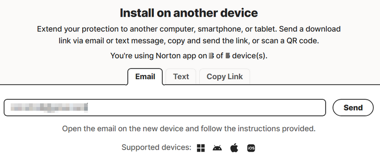

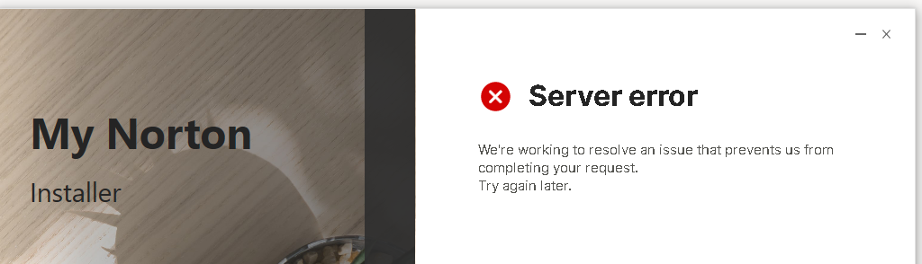

As you can see, I have 2 devices available, but there is a server error. I used the Agent’s tools and did those repairs. But still nothing is repaired, and Auto fix is NOW giving me the error after Support did their thing.
Win 10 Pro is up to date. I uninstalled Norton and reinstalled the latest version. I used the remove tool, and reinstalled. I have removed it and reinstalled via Safe mode. None of it helped. I did a system DLL scan and found:

  • “Server error” messages.

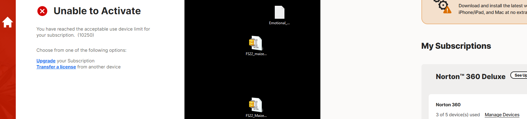

  • Device limit reached despite screenshot showing 3 of 5 devices used.

The combination of:
“Reached device limit”
and
“3 of 5 devices used”
alone would normally prompt a technician to check backend account records.
That’s not the kind of inconsistency that usually gets ignored.

I cannot download the file from Norton directly; it isn’t starting. Maybe it’s my server firewall, but I cleared Norton and its domain for all downloads. With no luck.
So you were running Norton 360 v26.x
v22 because – Norton LiveUpdate issue?

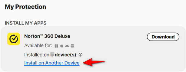

You cannot pull a fresh pre-activated download installer from your Norton account because – server firewall?
Are you behind a “server” or do you mean your “router firewall”?
Can you clean uninstall Norton and run Microsoft Defender Antivirus a few weeks (as test) to prove “Norton is causal”
Can you send yourself a link to the pre-activated download installer from your Norton account?

Why does Norton think the device limit is exceeded when the account shows available seats?
Why is this installation repeatedly ending up in an unprotected or activation-failed state?

Scary to think how vulnerable Norton V22 was.
I am running the lastest..
Okay, you’re running Norton 360 v26.6
