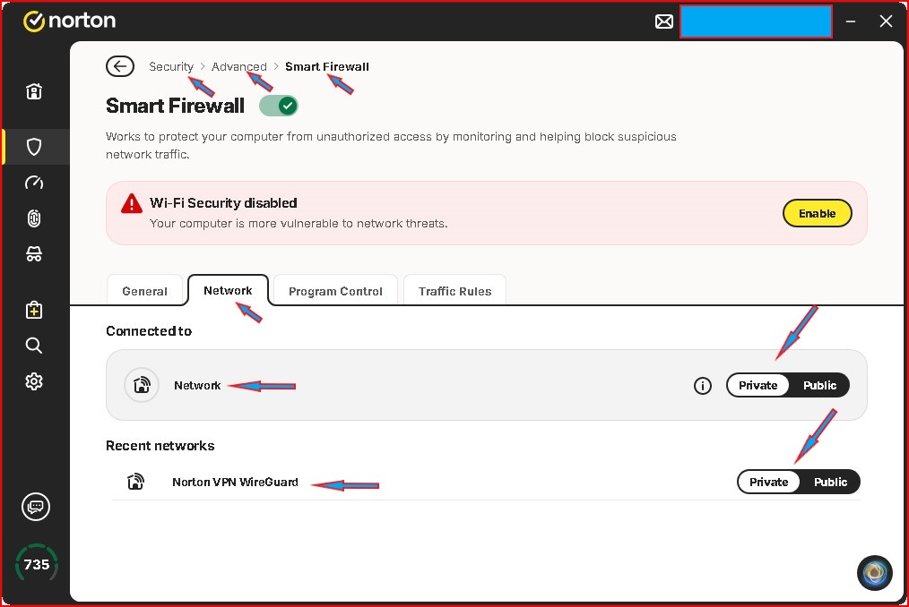

The way to reset the firewall is to go to Security / Advanced / Smart Firewall / General
And then click restore default settings
Also, go to Traffic Rules and click more and then restore and then restart
You can also do the same for program control

-When your computers are blocked is your network type set to private? If so that setting will allow local network connectivity to other devices on that network. Changing your network type to public will isolate other devices one from another. Using a VPN should follow those settings as well.
My Windows is the latest (What you show). My Norton is 26.5.10994 (Build 26.5.10994.984). Not sure why mine is different because I install all updates as Norton sends them. My Internet connection is coax cable (Spectrum) to a modem to a router to WiFi (Bluetooth is enabled for phones but the system is WiFi) to computers/printers. I believe you have the “specs” for “private” versus “public” reversed. Security is much tighter on “public” networks (your local McDonald’s for example.) In theory, the firewall should allow access to all connected devices on a “private” network. In my case, the Norton Firewall is blocking print jobs sent to either of my printers, but allows “trouble-shooting” programs to find and verify the printers as “ready to print”–although Windows shows them as “off-line.” I can print by turning off the Norton Firewall, but it is a royal pain turning it off and then back on for every print job.
