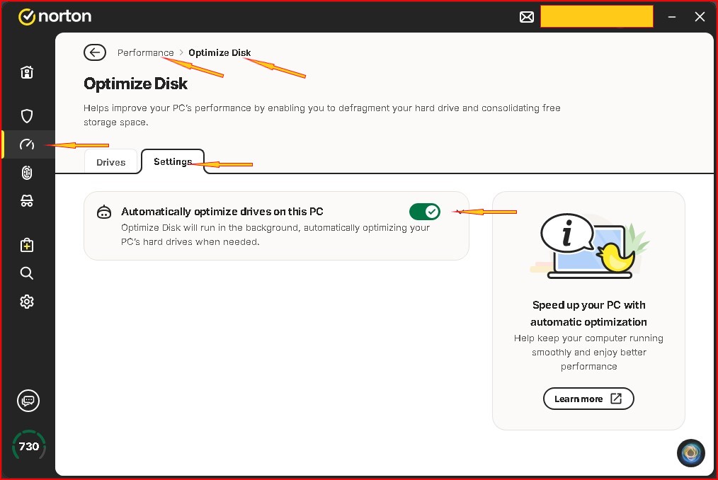

It had somehow turned on the “optimize” feature by itself, and after looking in the windows control panel, system, defragment section, it was DEFRAGMENTING, NOT RE-TRIMMING, MY SSD!!
I immediately stopped it, went into norton, turned off the optimize feature.

@Dukmiester2 Check this setting in Norton 360.

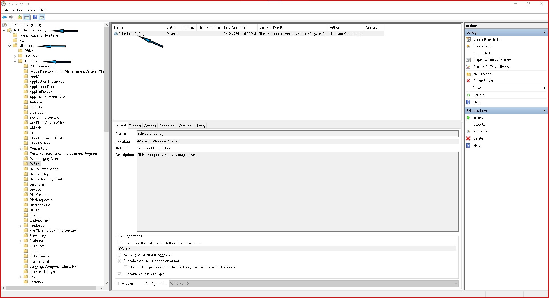

Disable defrag in Windows task scheduler:

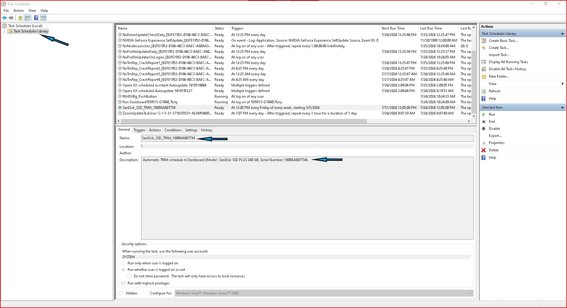

You can also set your 3rd party SSD management suite, if one is installed to run retrim in task scheduler. Or via its setting which will add the task itself.
