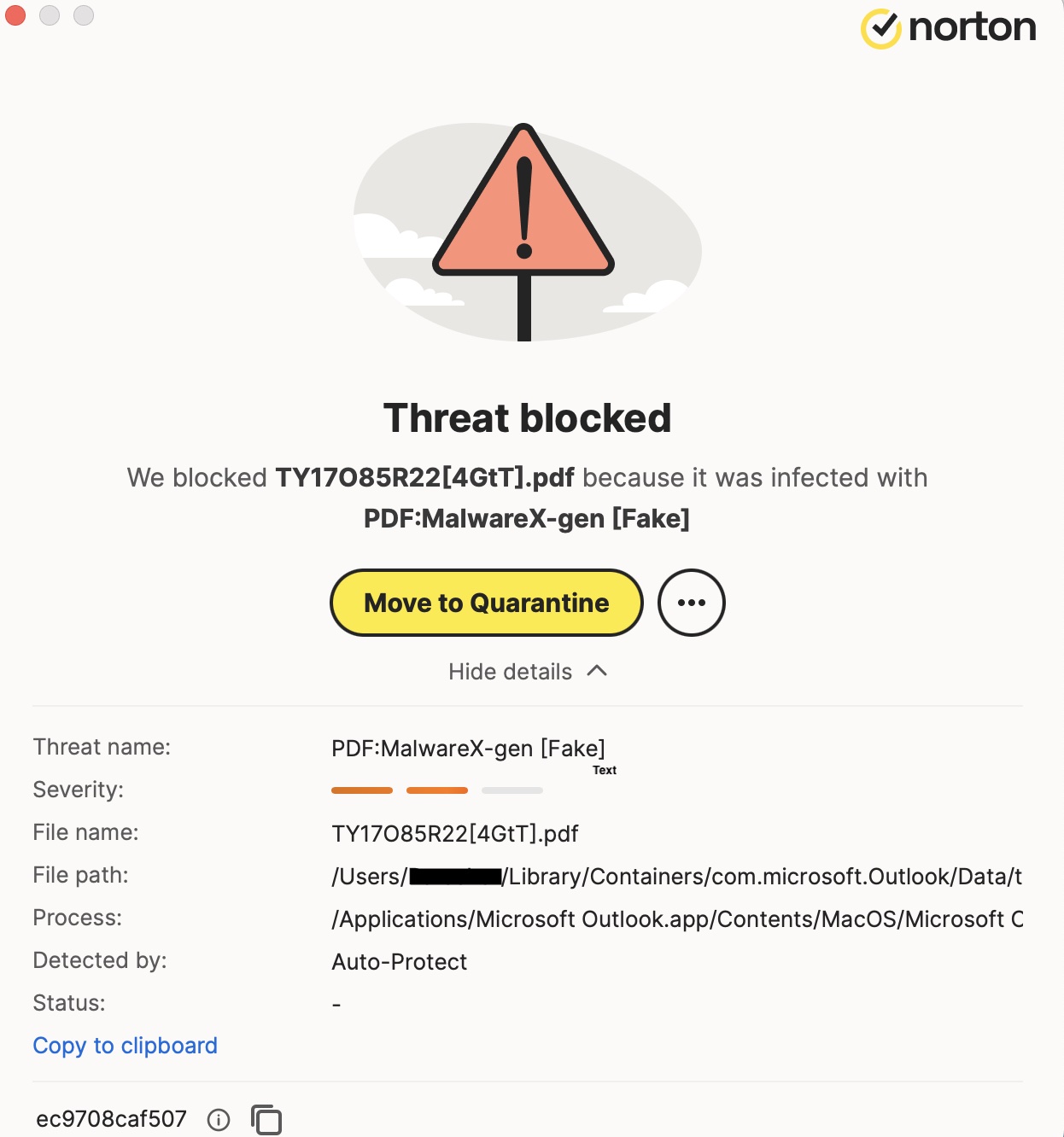

Norton keeps identifying threats when opening Microsoft Outlook even after quarantined files are removed
Issue abstract: Norton keeps identifying “PDF:MalwareX-gen [Fake] threats when opening MS Outlook
Detailed description: For the past week I noticed that whenever I open Outlook, Norton keeps identifying these threats. Each time I quarantine and delete the files. And yet, they keep coming back. The file names are slightly different but the file path is the same: “Users/XXXXX/Library/Containers/com.microsoft.Outlook/Data/tmp/Outlook Temp/Q7GX3QN4C9[6fm7].pdf”. If Outlook is closed, the folder is no longer viewable. through Finder…b/c it’s a temporary folder?
When I use Apple’s built-in Mail app, Norton doesn’t detect any threats even though both Mail has the same Google, MS Exchange, Outlook .com accounts as Outlook. So I’m not sure why the threats are detected when using Outlook but not Mail.
Regardless, I would like assistance to make sure my Mac is not infected with malware and if it is, how to remove it because it doesn’t appear that Norton is doing so (which raises the question of why it’s not detecting the threat when using Mail?).
Product & version number: Norton 360. 25.9.0
OS details: Sequoia 15.6.1
What is the error message you are seeing? “Threat blocked”

I went to the websites for my 7 personal email accounts and deleted any file with any attachment in Sept/Oct 2025. As I suspected, there were only a handful and they were known. Deleted them and then deleted them from trash folders.

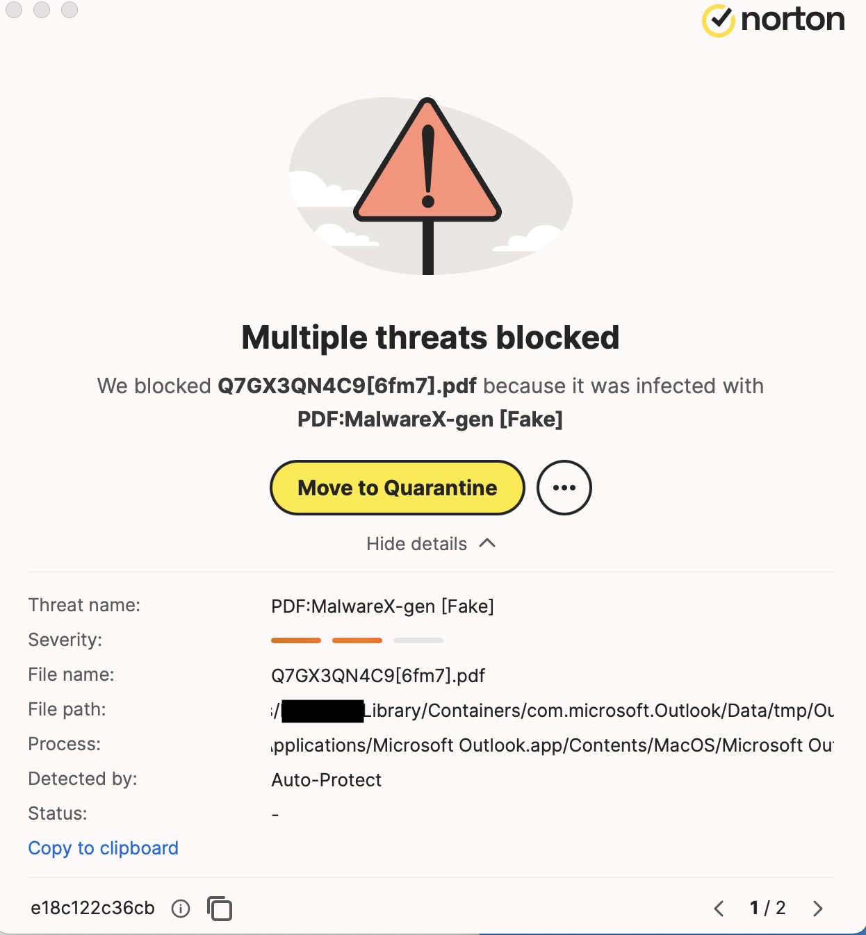

Next I made sure the Norton Quarantine was empty and then opened Outlook. Norton instantly found 3 different .pdfs that it said were malware threats. I moved them to quarantine.
I then closed Outlook and reopened it. Same thing but this time Norton identified 2 of the 3 previously identified threats.
Repeated the process of closing/opening Outlook and Norton again identified the same 2 of the 3 previously identified threats.
Deleted all of the identified threats from Quarantine at this point. Verified that Quarantine was empty. Closed Outlook. Reopend Outlook and Norton identified the same 2 .pdfs as threats.
At this point I’ll move on to try Malwarebytes later today and will report back.

Thanks for your help. I synch 6 email accounts (3 Gmail and 3 Outllook/Office) in Outlook and the same 6 plus a Yahoo account in Apple’s email app, Mail.
In the beginning Norton detected the threat only when opening MS Outlook (even after quarantining and deleting the threats). Once or twice it has detected them in Mail but not with the consistency as in Outlook.
I managed to isolate two .pdfs and used the preview feature to look at them. Both were “McAfee invoices” which is nonsense because I’e never used that program. I deleted the files permanently, fans a full scan and no threats.
I then deleted the two Gmail accounts I saw in the invoices, opened Outlook and Mail and no threats. I added one back and no threat when opening Outlook nor Mail. Added the 2nd Gmail accounts in and Norton identified threats in Outlook and Mail. So I deleted that account, ran a full scan and Norton didn’t detect any virus.
