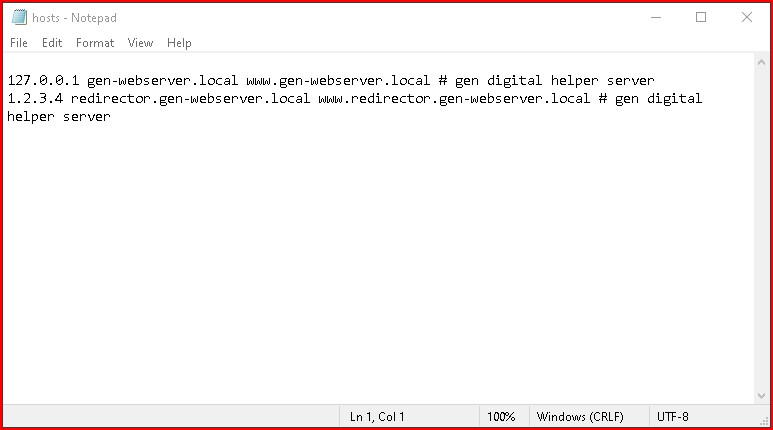

Here is my hosts file before I restarted my PC and ran a full scan
After I restarted it Norton (I assume) added these entries at the end of the file
I ran a full scan and Norton detected malware in the hosts file
After you quarantine this file your hosts file is basically deleted
What’s going on?
One thing to note you cannot get rid of the stuff norton added at the bottom even if you restore the file. I believe they added that code maybe 2 days ago. Even if you make a new hosts file using microsofts instructions. Something has gone horribly wrong here.

Great? No. As soon as you restart your computer Norton edits the hosts file to look like this adding
127.0.0.1 gen-webserver.local www.gen-webserver.local # gen digital helper server
1.2.3.4 redirector.gen-webserver.local www.redirector.gen-webserver.local # gen digital helper server at the bottom.
If you do clean the file using Norton it will delete the hosts file. Then when you restart your computer it will make a new hosts file that looks like this.

The code that’s added
1.2.3.4 is a real IP address is it even safe for us to use our computers seeing how our traffic is being routed through these 2 new entries?

Here’s what I did. This post is a little longwinded, but still.
Went on my main laptop around 9PM, did a smart scan got the malware warning and it quarantined. Panicked checked the other computers, same issue. Restarted a few times, saw that norton replaced the file with their own hosts files. Removed theirs and put the quarantined file back in, scanned that file, still got warnings and requarantined. Some of the tests I didn’t restart computer, i just scanned it got quarantined i added back in, scanned agian, bam quarantined again.
This morning around 6AM, added quarantined file back to computer after removing norton one, scanned, got warning. Removed the norton created hosts file after a restart, added the quarantine file back and still got a warning. Left to do errands. Came back around 12PM, scanned, lo and behold the quarantined file after another test like I described. (that has the microsoft and norton text) didn’t get marked as malware. Added the quarantined back to the other two computers, and again, they did not scan as malware.

In all three instances now, yes, the file contains both the microsoft instructions and the norton additiond
I am doing a system restore to roll back my computer to an earlier date and see if anything changes. I did a restore also last night and this morning on both the other two computers, which did roll the hosts back to their original incarnations before scanning and quarantine but norton did add their additions to the hosts files. During those experiments once restored the files were scanned again and got quarantined again
