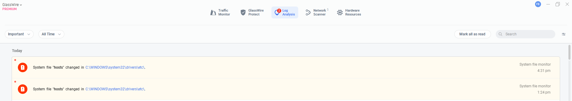

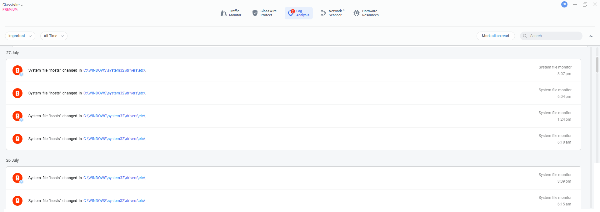

I also use GlassWire, which provides me with information when an application edits the host file.
The host file now only changes at startup.
With the previous version 26.6.11052, during startup and shutdown.

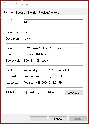

@Feelgood I have asked whether any of you have your hosts file attributes set to read only. I have mine set that way, hosts is NOT being over written on my machines.

Going forward on my side. The Windows hosts file on ALL my machines are set to “read only”. The issue is resolved for me personally. If anything gets written into hosts going forward there will be a new issue.

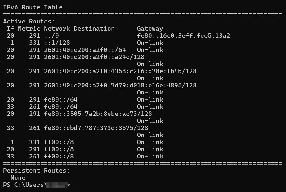

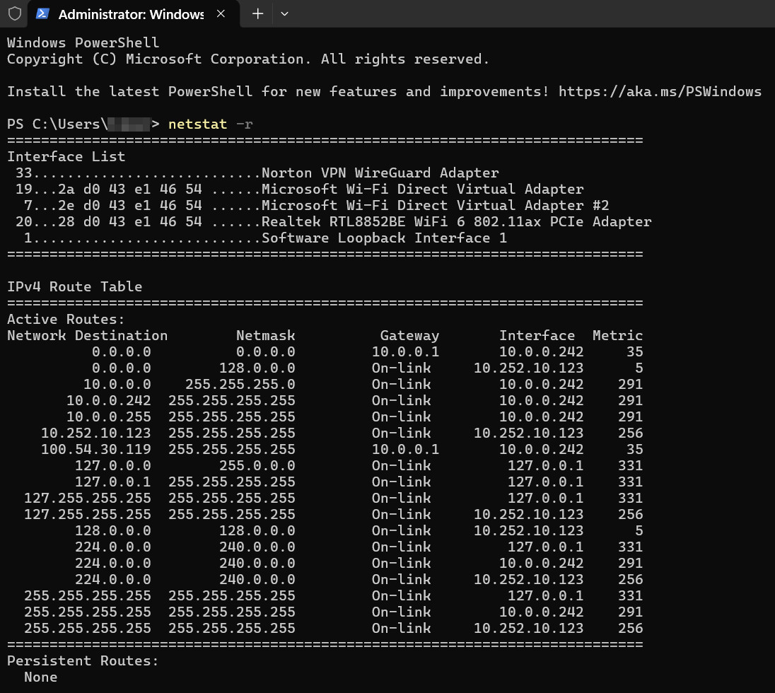

For those who still have the hosts entries from Norton you can open an elevated command ( run as admin ) type is netstat -r and have a look at your routing tables on the specific device you are using. Take note of whether there are “persistent routes” or none in the table.
Not seeing any persistent routes is good. Nothing is sending outbound traffic that shouldn’t be going out.
