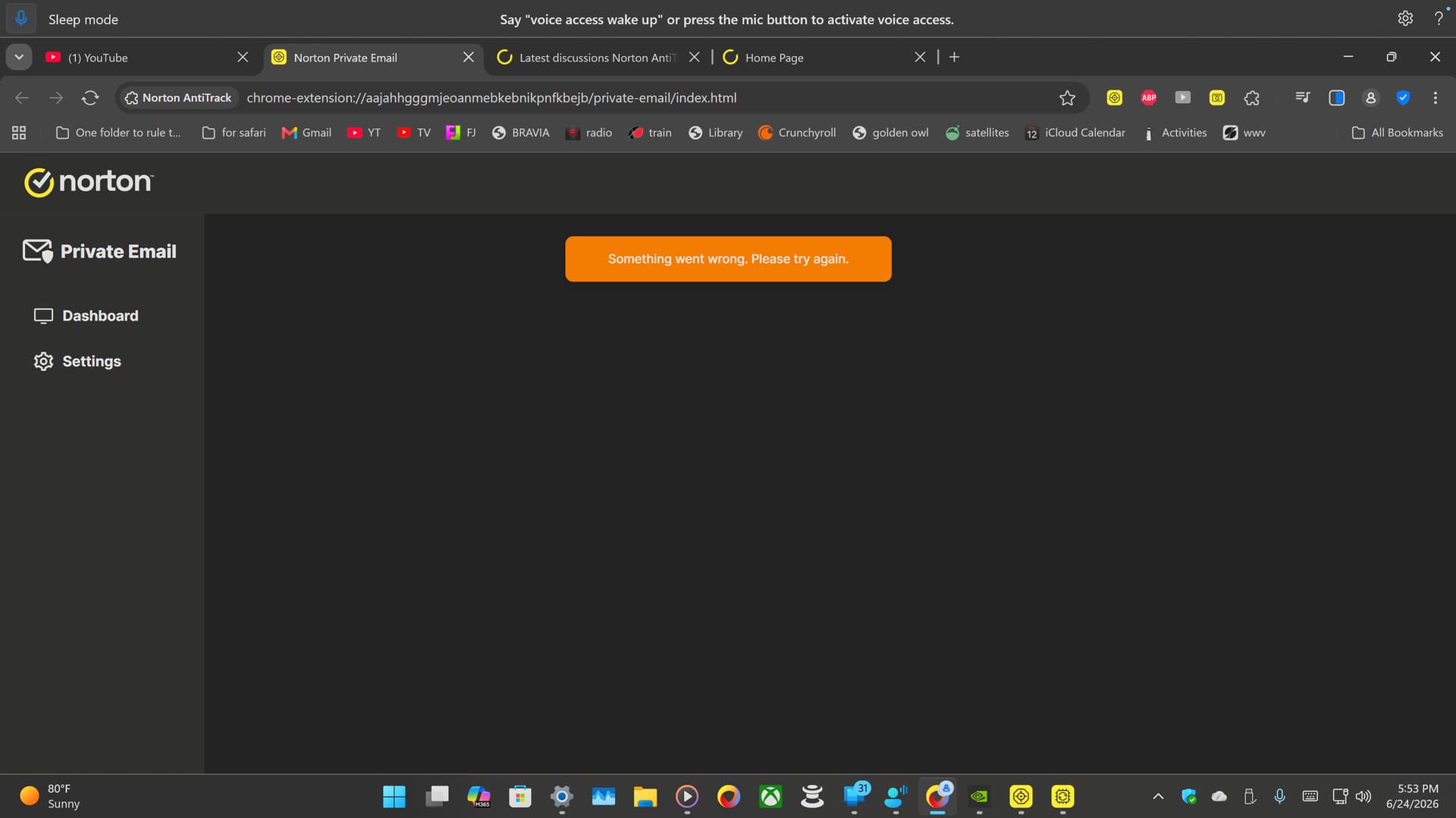

The “Something went wrong. Please try again” error in Norton Private Email (part of Norton AntiTrack) is typically caused by browser extension conflicts, server sync hiccups, or using an unsupported default web browser.

The fact that you can see the dark mode framework (the left sidebar with Private Email, Dashboard, and Settings) means the page layout itself is loading, but the main content window is failing to fetch your active email masks from the server.
This partial loading failure is usually tied to a secure login token timeout, an ad-blocker conflict, or a broken browser zoom setting. Try these targeted steps to make the data appear:

The structural layout loading correctly while the central data panel stays entirely black narrows the problem down to a breakdown in Chrome’s tracking protection API, an authentication mismatch, or a script roadblock.
Because the dashboard navigation text is active, you can use these precise steps to force Chrome and the Norton servers to sync data properly:

When you click Settings or Dashboard in that left column, does the text turn white/highlight to show it registers your click, or does the page ignore your clicks completely? Knowing if the page is responsive helps narrow down if Chrome is frozen or if the data is just blocked.
