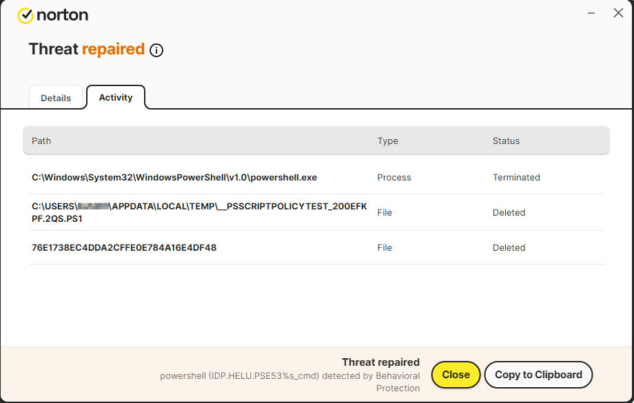

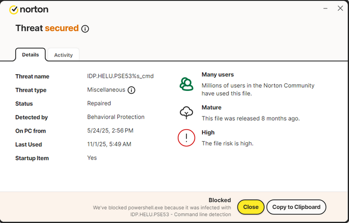

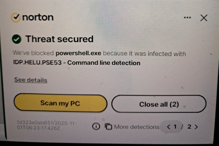

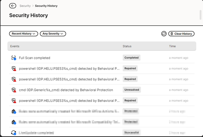

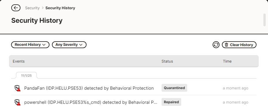

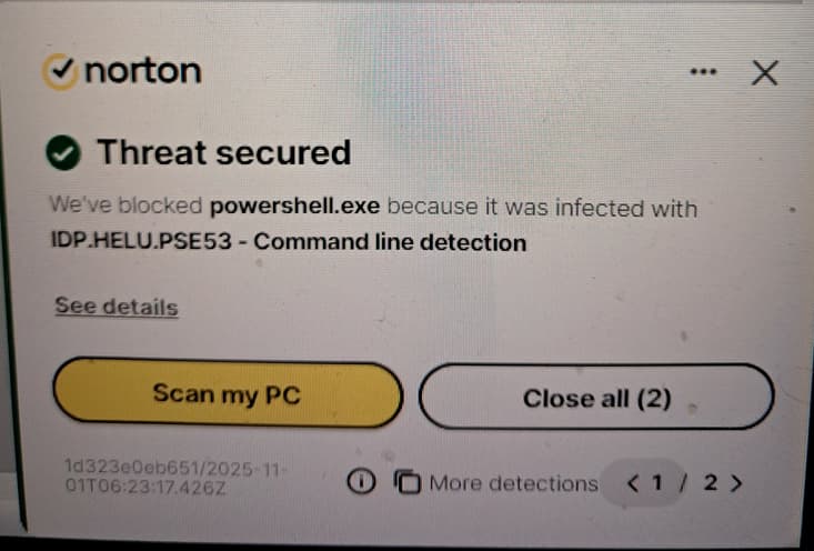

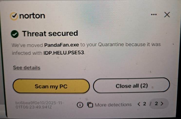

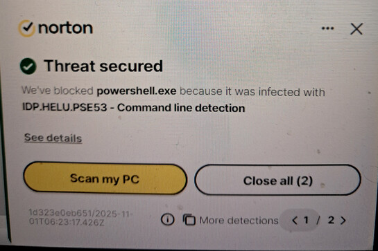

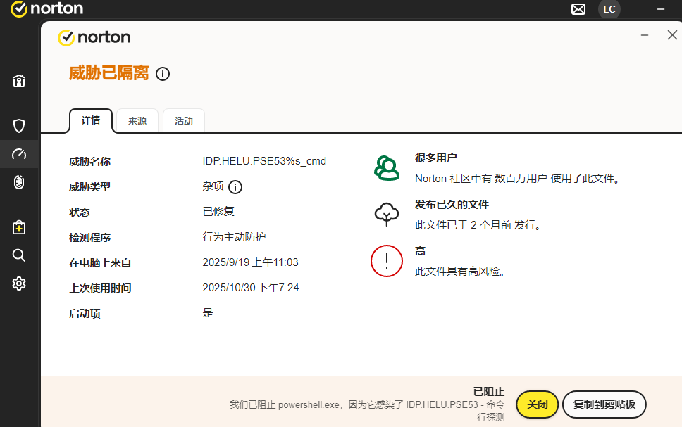

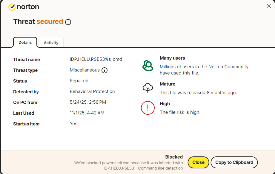

Norton showing powershell.exe infected with IDP.Generic/IDP.HELU.PSS53
Issue abstract: Norton showing powershell.exe infected with IDP.Generic/IDP.HELU.PSS53
Detailed description:

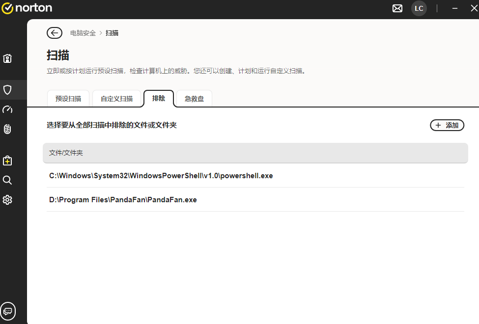

I am using a VPN service called Pandafan (www.pandafan.zone). Because I work in China, this software allows me to use services like Google and YouTube. However, Pandafan recently had an update, and after the update, when I run it on Windows 11, Norton pops up with an alert and blocks Pandafan.exe, which prevents me from using Pandafan, and at that point, I can’t access Google normally. When I try turning off Norton’s ‘Proactive Protection,’ Pandafan works normally again. Why is this happening, and is there a way to fix it?
OS details:Windows 11, 25H2

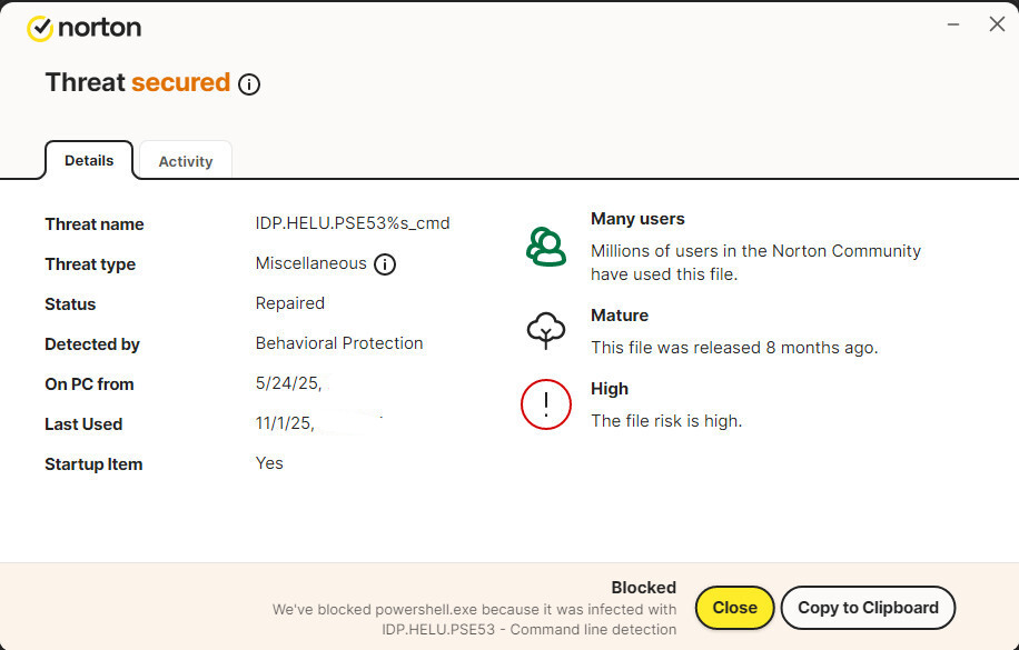

Hello @Lucas.C
Do you trust PandaFan?

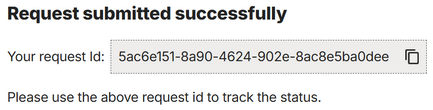

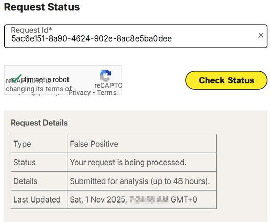

Did you submit False Positive report?

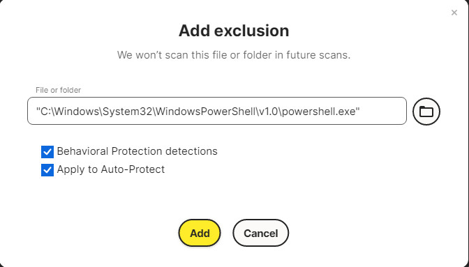

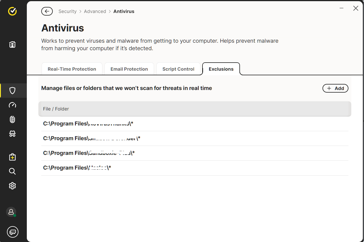

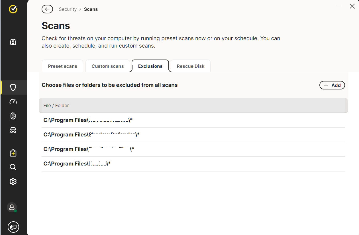

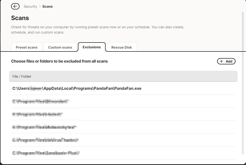

Did you try adding Antivirus and Scans exclusions…if you trust PandaFan & disagree with Norton detection?

If Norton flags powershell.exe with IDP.Generic/IDP.HELU.PSS53, it is most likely a false positive, especially after a recent Windows update. This happens because PowerShell is a legitimate system tool that malware can sometimes exploit, causing Norton’s heuristic (behavioral) detection to get a false alarm.
What the alert means
  • IDP.Generic: “IDP” stands for Identity Protection, and “Generic” indicates that your antivirus detected suspicious, non-specific behavior rather than a known malware signature.
  • IDP.HELU.PSS53: This is a specific code used by Norton’s heuristic engine. The letters “HELU” and “PSS” likely refer to the type of suspicious behavior that was detected—in this case, related to the PowerShell script (PSS).
  • Powershell.exe: This is the executable file for Windows PowerShell, a command-line shell and scripting language built into Windows.
Why this is likely a false positive
  • Recent Windows updates: Security software often becomes oversensitive to new, legitimate system file versions following an OS update. This is a common cause of false positives with heuristic detection.
  • Behavioral detection: The IDP (Identity Protection) component in Norton is designed to look for suspicious behavior. Since malicious software can use PowerShell for its own purposes, Norton may flag legitimate scripts or processes if their behavior appears to resemble malware.
  • Community reports: Users frequently report similar false alarms from Norton after a Windows update, specifically with PowerShell and the IDP.HELU identifier.

  1. Add an exclusion: After restoring the file, add an exclusion in Norton to prevent it from being flagged again.
  • In your Norton settings, go to Antivirus > Scans and Risks.
  • Under Exclusions, configure the list of items to exclude from scans.
  • Add the full path for powershell.exe, which is typically C:\Windows\System32\WindowsPowerShell\v1.0\powershell.exe.

Submit the file to Norton for analysis
This helps resolve the issue for other users and ensures future updates will not flag the legitimate file.
Go to the Norton Submission Portal at submit.norton.com.
Select the “Incorrectly Detected by Norton (False Positive)” option.
Fill out the submission form, including your email address and a brief description of why you believe the file is safe.
Upload the file. Attach the file that you restored from quarantine earlier.
Check for updates. Norton’s Security Response team will analyze the file and release a new definition update within about 48 hours to correct any mistake.

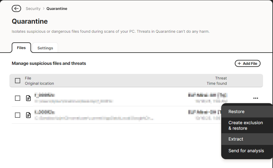

Norton 360 v25 → Quarantine offers Extract. I’ve used Extract to upload samples to VirusTotal.

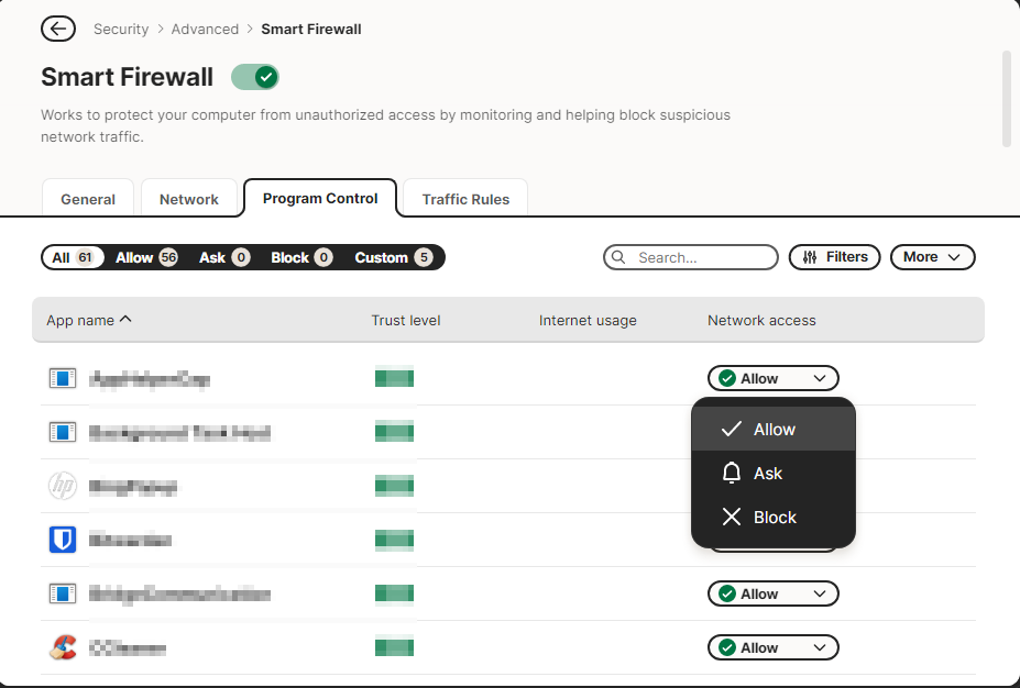

How to fix this issue

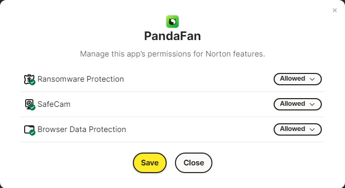

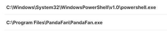

To allow Pandafan to run without disabling Norton’s protections, you can add an exception for the application in your Norton settings.
Open Norton 360: Double-click the Norton icon in your system tray or search for it in your Start Menu.
Go to Settings: Click the gear icon in the top-right corner to open the settings.
Find Firewall: Navigate to the “Firewall” settings.
Open Program Rules: Go to the “Program Rules” tab. This is where you can see which applications Norton is controlling.
Add the Pandafan executable:
  • Locate the Pandafan.exe application in the list.
  • Change its setting from “Block” to “Allow”.
  • If you don’t see it, you may need to add it manually by clicking “Add Program” and browsing to the Pandafan installation folder to select the executable file.
    Apply and Restart: Apply the changes. It is a good practice to close and restart Pandafan, and in some cases, reboot your computer, for the new rule to take effect.
This process tells Norton that you trust the Pandafan application and overrides its proactive block without leaving your system vulnerable by turning off all protection.

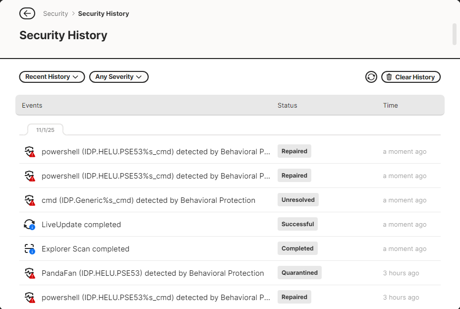

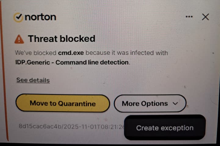

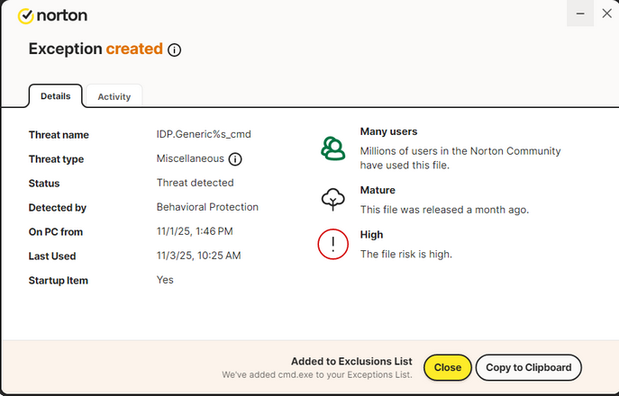

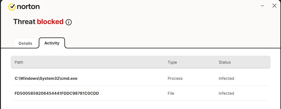

The Norton alert is triggered because the Pandafan VPN client is running a script via the Windows program powershell.exe . Norton’s heuristic or behavioral-based scanner, known as Identity Protection (IDP), flags this activity as suspicious, labeling the threat as IDP.Generic or IDP.HELU.PSS53. This often results in a “false positive” detection for legitimate software.
This type of warning can occur with legitimate VPN clients and system tools for a few reasons:
  • Behavioral Red Flag: By design, VPN software manipulates network connections to create encrypted tunnels, which can be interpreted as suspicious network behavior by security software.
  • Code Changes: A recent software update, like the one you mentioned, can make a program appear new and unknown to an antivirus program. Norton may then block it until it has established a reputation as safe.
  • Lack of Reputation: The VPN service you are using, Pandafan, does not have the reputation of a major provider. Combined with a new program update, this increases the chance of it being flagged as a threat.
Potential security risks
While it is possible the alert is a harmless false positive, the situation carries security risks that you should consider carefully, especially given your location.
  • Trust and ownership concerns: There are reports about Panda-branded VPNs having questionable ties to China, despite claiming to be based elsewhere. A lack of transparency about a VPN’s ownership raises significant privacy concerns, particularly for users in China.
  • Malicious activity: The Norton detection code IDP.HELU.PSS53 specifically indicates a potential script-based malware threat. Although it may be a false alarm, there is a risk that the Pandafan update contains malware that is attempting to run PowerShell scripts with malicious intent.

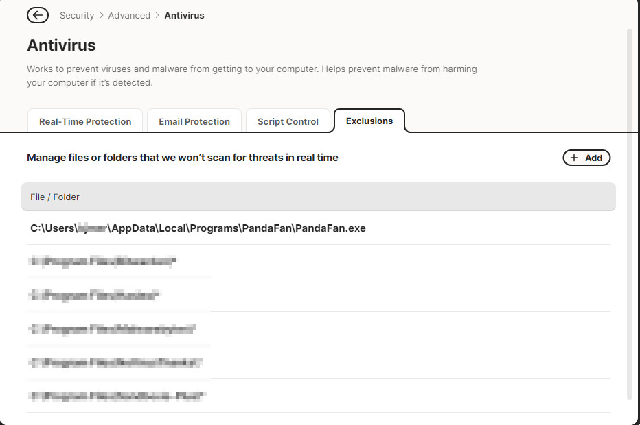

  1. Add an exception in Norton: Create an exception for Pandafan.exe to stop Norton from blocking it.
  • Open Norton 360 and navigate to Settings > Firewall > Program Rules.
  • Find the Pandafan executable and change its setting to “Allow”.
  • If you still have issues, you may also need to go to Settings > Antivirus > Scans and Risks and add the file path to the “Items to Exclude from Scans” list.

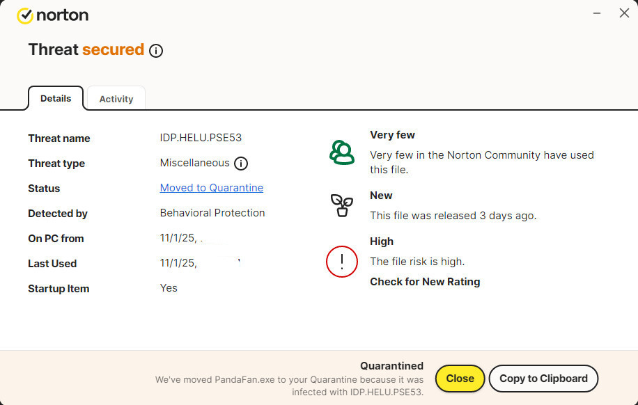

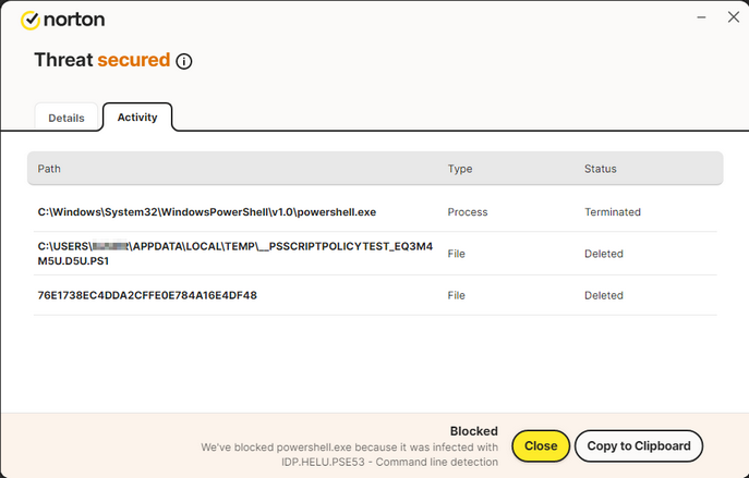

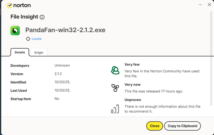

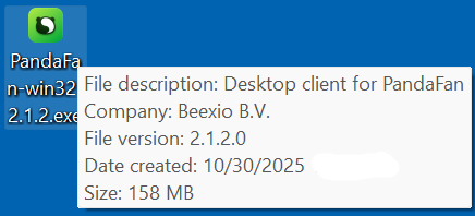

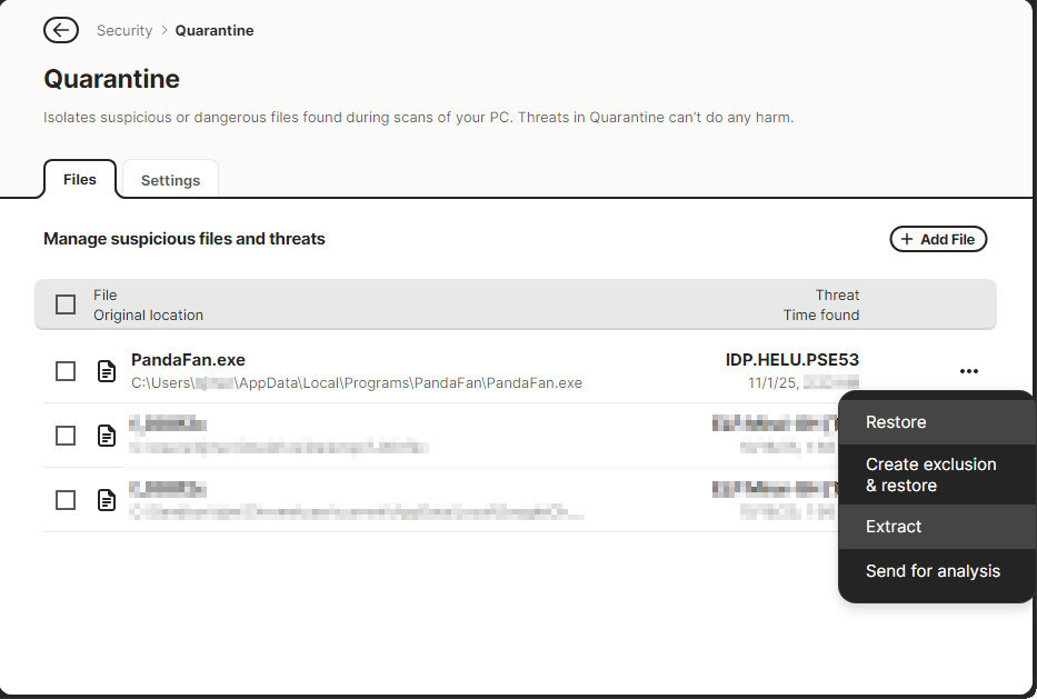

Um, is this your PandaFan?
Developers: Unknown
Version: 2.1.2
Identified: 10/30/25,
Last Used: 10/30/25,
Very few
Very few in the Norton Community have used this file.
Very new
This file was released 17 hours ago.
Unproven
There is not enough information about this file to recommend it.

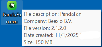

Downloaded from: https://xconf2.oss-accelerate.aliyuncs.com/panda/dl/client/win/PandaFan-win32-2.1.2.exe
File: PandaFan-win32-2.1.2.exe
File size: 158 MB (165,819,617 bytes)
MD5 checksum: 9E8F18F294CC4995037EAA8F455D3391
SHA1 checksum: 1B2B3EA7E56B08D94F047AD8F4D7C9890B5C9B2E
SHA256 checksum: 40168C1ED1CA213A8ADA47939F80640F7F51BA8F58876AB8682A7BB42C87CF6A
Date/Time: 10/30/2025

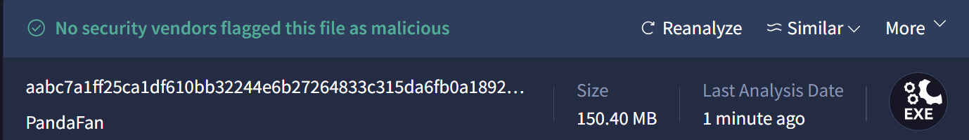

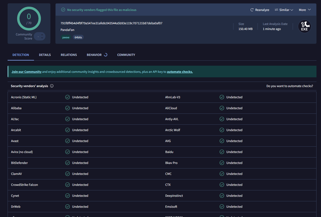

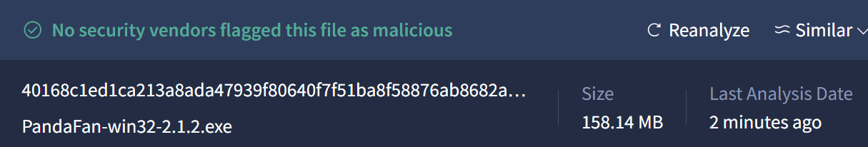

Note: PandaFan-win32-2.1.2.exe was not known to VirusTotal
Caveat: I’m not familiar with PandaFan
fwiw ~ my Norton and Malwarebytes do not detect PandaFan-win32-2.1.2.exe installer.
Note: I’ve not tested PandaFan installed.
Note: PandaFan-win32-2.1.2.exe installer is not signed.

Norton detection may be due to PandaFan recent update.
Maybe, Norton needs to gather telemetry.
PandaFan-win32-2.1.2.exe is not signed.
Maybe, try False Positive submission.
Yes, Thank you for your reply, I am slowly reading your message. That’s right, this is the Pandafan I use, and I currently trust this VPN software. If that’s the case, what advice would you have for me? Yesterday, Norton put pandafan.exe into quarantine,I took it out of quarantine and temporarily disabled ‘Proactive Protection.’ So, what should I do next?
and I uploaded the Pandafan.exe on virustotal, got “No security vendors flagged this file as malicious“.

I’d add Pandafan.exe with Antivirus and Scans exclusions…to see whether Pandafan.exe exclusions satisfy Norton engines.
Yesterday, I tried launching 2.1.2 download for Windows from https://pandafan.win/download…but, nothing happened.

Hello again @Lucas.C
fwiw ~ as test: current user install
1d323e0eb651/2025-11-01T06:23:17.426Z
bc6bea9f0e10/2025-11-01T06:23:49.941Z
Extract
File: PandaFan.exe
File size: 150 MB (157,708,800 bytes)
SHA256 checksum: AABC7A1FF25CA1DF610BB32244E6B27264833C315DA6FB0A1892E635A57C290D
Date/Time: 11/1/2025
File is not signed
Threat name: IDP.HELU.PSE53
Threat type: Miscellaneous - This is malicious software that could harm your data, computer, or network.
Status: Moved to Quarantine
Detected by: Behavioral Protection
On PC from: 11/1/25,
Last Used: 11/1/25,
Startup Item: Yes
Very few
New
This file was released 3 days ago.
High
The file risk is high.

https://submissions.norton.com/reportfalsepositive#pc = upstream request timeout
https://safeweb.norton.com/file_dispute = 5ac6e151-8a90-4624-902e-8ac8e5ba0dee
Edit: PandaFan.7z
Create exclusion & restore
Note: with Exclusions → IDP.Generic - Command line detection
8d15cac6ac4b/2025-11-01T08:25:00.607Z
Threat name: IDP.Generic%s_cmd
Threat type: Miscellaneous - This is an app that you may have unknowingly installed and that may harm your computer performance.
Status: Threat detected
On PC from: 9/2/25,
Last Used: 11/1/25,
Startup Item: Yes
Many users
Millions of users in the Norton Community have used this file.
Mature
This file was released 3 months ago.
High
Activity
Path | Type | Status
C:\Windows\System32\cmd.exe | Process | Infected
21A06CBFA324BD94702779796EAA524C | File | exceptions
Behavioral Protection remains not satisfied

C:\Windows\System32\WindowsPowerShell\v1.0\powershell.exe | Process | Terminated
C:\USERS\USER\APPDATA\LOCAL\TEMP__PSSCRIPTPOLICYTEST_200EFKPF.2QS.PS1 | File | Deleted
76E1738EC4DDA2CFFE0E784A16E4DF48 | File | Deleted
App permissions → PandaFan.exe → Allowed x 3 = Behavior Protection remains not satisfied

I’m still getting IDP.HELU.PSE53 - Command line detection
Threat name: IDP.HELU.PSE53%s_cmd
Status: Repaired
On PC from: 5/24/25,
Last Used: 11/1/25,
Startup Item: Yes
Many users
Mature
This file was released 8 months ago.
High
Activity
C:\USERS\USER\APPDATA\LOCAL\TEMP__PSSCRIPTPOLICYTEST_DH1DGDJD.RGG.PS1 | File | Deleted
upon calling PandaFan…I’m still getting = We’ve blocked powershell.exe because it was infected with IDP.HELU.PSE53 - Command line detection
5e5247c7f009/2025-11-01T09:49:33.798Z
Status: Repaired
Last Used: 11/1/25,
Startup Item: Yes
Many users
Mature
High
Activity
C:\USERS\USER\APPDATA\LOCAL\TEMP__PSSCRIPTPOLICYTEST_EQ3M4M5U.D5U.PS1 | File | Deleted
as test: added WindowsPowerShell with Exclusions
Status: Repaired
Last Used: 11/1/25,
Startup Item: Yes
Many users
Mature
High
Activity
C:\USERS\USER\APPDATA\LOCAL\TEMP__PSSCRIPTPOLICYTEST_IHGXG2SC.VTB.PS1 | File | Deleted
upon calling PandaFan…I’m still getting…Command line detection

I just add powershell.exe and pandafan.exe in exclusion list. You can try it.
Hello @Lucas.C
Oh okay…your Programs Files are on D:\ drive?

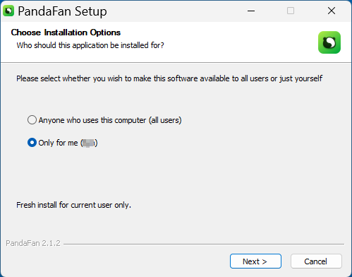

Your install is default current user only or Anyone?
my…fwiw ~ as test: was current user only
my…PandaFan.exe - Exclusions were AppData\Local
fwiw ~ as test: install for all users with added Antivirus & Scans → Exclusions
upon calling PandaFan desktop shortcut…after a few moments…I’m still getting…Command line detection
Last Used: 11/3/25,
Startup Item: Yes
Many users
Mature
This file was released a month ago.
High
Activity
FD5005859206454441FDDC98781C0CDD | File | Infected
Move to Quarantine | Create exception
Last Used: 11/3/25,
Startup Item: Yes
Many users
Mature
High
Activity
FD5005859206454441FDDC98781C0CDD | File | exceptions
with Create exception…I’m still seeing same Exclusions
and next PandaFan shortcut call…same Command line detection
and fwiw ~ excluding powershell.exe feels unwise. Just me.
Regards w Respect
