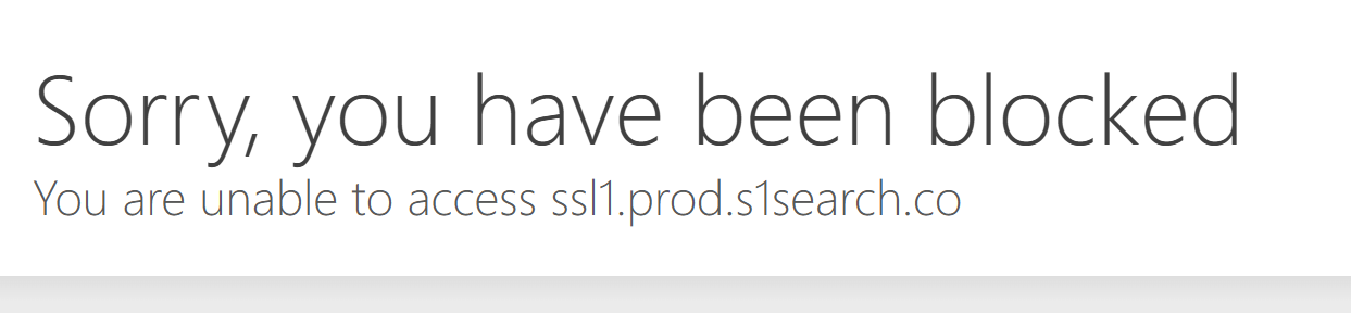

Norton stopped letting me get to social security login. Help

@barbara_laden The URL address, "ssl1. prod. s1search. co " as shown in your screenshot is NOT, I repeat, IS NOT related to Social Security within the US. I’ve broken the actual URL so that it doesn’t populate here as an actual internet address for safety sake.
Here is what AI has generated related to that web address:
AI Overview
ssl1.prod.s1search.co is a domain associated with a browser hijacker, often linked to the “One Browser Search” malware. It acts as a malicious redirection node, forcing user searches through its servers to services like Bing. It is frequently blocked by security tools (like Cloudflare) for serving malicious content or malicious behavior.
Key Details Regarding ssl1.prod.s1search.co
  • Purpose: This URL appears in the middle of a redirect chain designed to hijack searches, often starting from fake search extensions or malicious browser settings.
  • Symptoms: Users usually encounter this domain when they receive a “Sorry, you have been blocked” page while trying to use their browser, often resulting in a total inability to search.
  • Cause: It is part of the “One Browser Search” browser hijacking ecosystem.
  • Removal: The domain is associated with persistent threats. Removal requires scanning for unwanted browser extensions, resetting browser settings, and checking for malware on your computer.
If you are seeing this domain, it is highly recommended to run a full antivirus scan and review your browser extensions.
https://community.cloudflare.com/t/every-time-i-use-google-chrome-to-search-something-up-im-told-i-have-been-blocked/710105
@globus5000 Please review my last post to the OP. This issue has NOTHING to do with bugs, actual nor purported within Norton. It is a browser hijacking issue. Thanks in advance.
