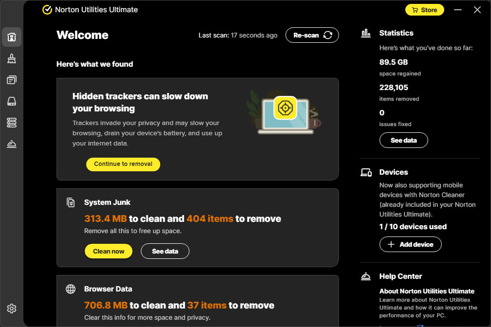

First I do a scan:
As you can see, there is 313.4 MB of system junk and 706.8 MB of browser dada.
I concentrate on the system junk.

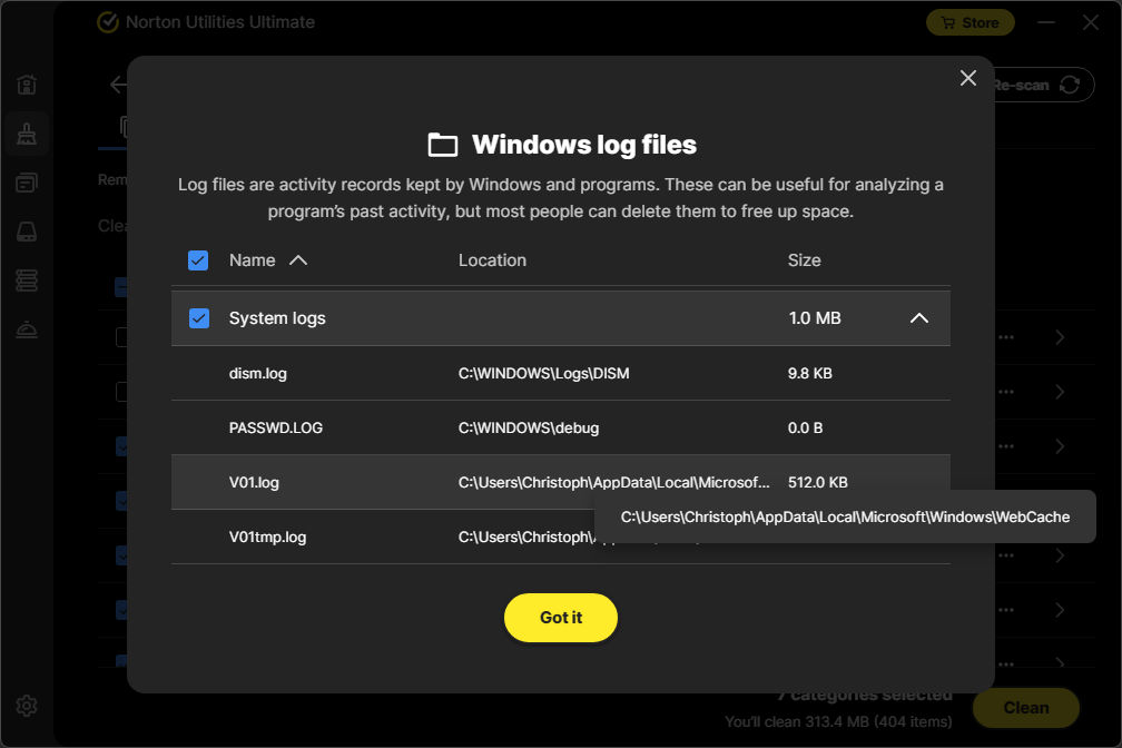

I press “See data” to check which files are selected:
I remember the path name and file name of file “C:\Users\Christoph\AppData\Local\Microsoft\Windows\WebCache\V01.log”.

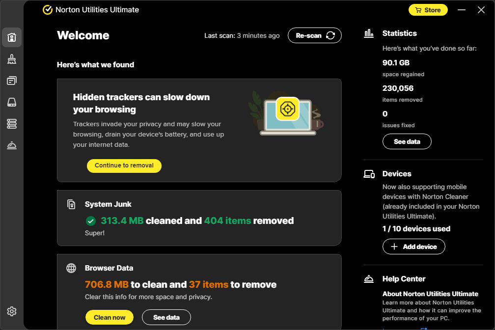

I press “Clean now” and got the message that it has worked:

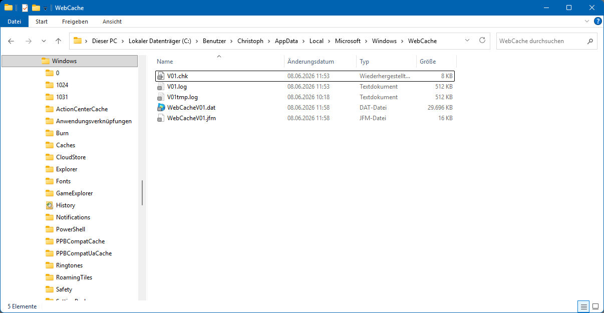

Now I start the file explorer and check the remembered path and file name.
I see that the file still exists:
