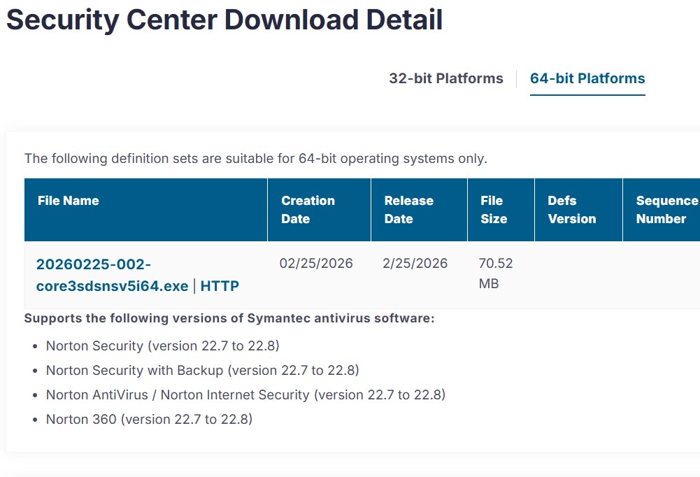

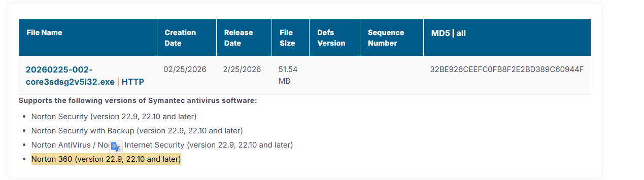

I am unable to perform an offline virus definition update for Norton v25.
What I did:
  • Downloaded the latest offline Intelligent Updater (x64) from the official Norton website
  • Ran the downloaded .exe file on the target machine.
  • The installation completed with the message:
“All updates failed to install on the machine.”
No definitions were updated.
Environment:
  • Norton version: v25
  • System: Windows 11 (x64)
  • Update method: Offline (Intelligent Updater .exe)
  • Internet connection: Not connected (offline machine)

However, on the download page there is another section that mentions:
“Norton 360 (version 22.9, 22.10 and later)”
Based on that information, we understood that offline updates were still supported, which is one of the reasons we proceeded with the purchase.

Hi. we have downgrades to norton v22, but can’t find which virus definition we are using, is it possible to find out?
If you have a version that is earlier than and up to version 22.6.xx.xx use the definitions below:
https://definitions.symantec.com/defs/20260226-002-core3v5i64.exe
