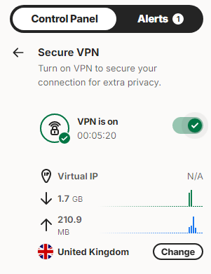

This is not consistent. I did not expect VPN to start automatically following shutdown/restart when disconnected. But this is also wrong/bad because of the N/A IP address. VPN is not functioning, my IP address is the local default.
Norton UI > VPN > Change > Fastest Location
  • Connected (but VPN is not functioning and IP address states “N/A”)

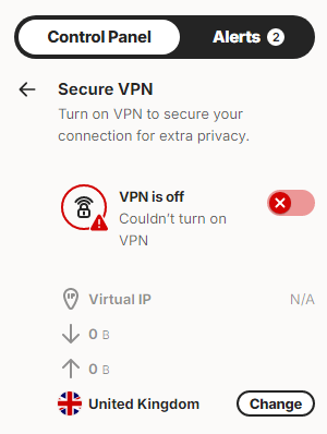

Norton UI > VPN > VPN is off > On (P2P-Optimized Region)
  • Couldn’t turn on VPN
Norton UI > VPN > VPN is off > On (Fastest Location)
Norton UI > VPN > VPN is off > On (United Kingdom)

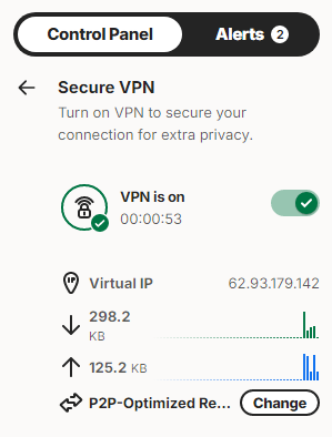

This is a repeat of the “exception”, sometimes “P2P-Optimized Region” does connect
  • Connected
Norton UI > VPN > VPN is on > Off

restart
E:\Picture\System\260523 175740 Norton VPN Fastest Location Couldnt turn on VPN.png

Norton UI > VPN > Change > P2P-Optimized Region
ok, but I did not expect this result!
E:\Picture\System\260523 181412 Norton VPN P2P-Optimized Region VPN connected.png

Norton UI > VPN
E:\Picture\System\260523 185730 Norton VPN United Kingdom VPN connected but IP NA.png
#This is not consistent. I did not expect VPN to start automatically following shutdown/restart when disconnected.
#But this is also wrong/bad because of the N/A IP address. VPN is not functioning my IP address is the local default.
Connected
