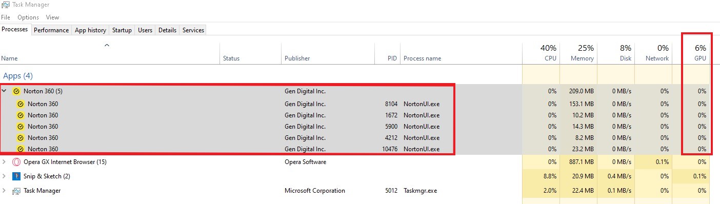

@PIRABAKARAPANDIYAN_P Could you please provide a screenshot of what is shown in Task Manager when you open the Norton UI? Below is what I see my side:

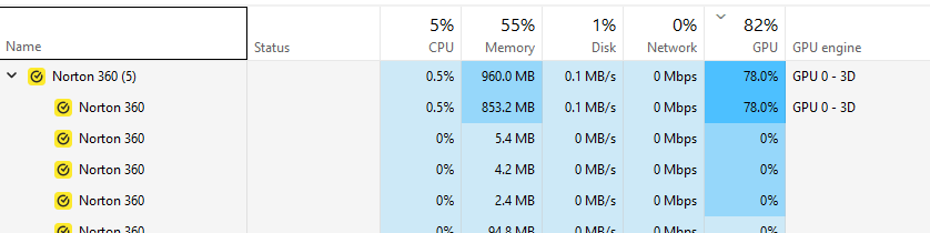

I am willing to volunteer to help diagnose this issue. This is additional data. Notice the GPU percentage. I have had instances where the GPU % will 100% and stay there.

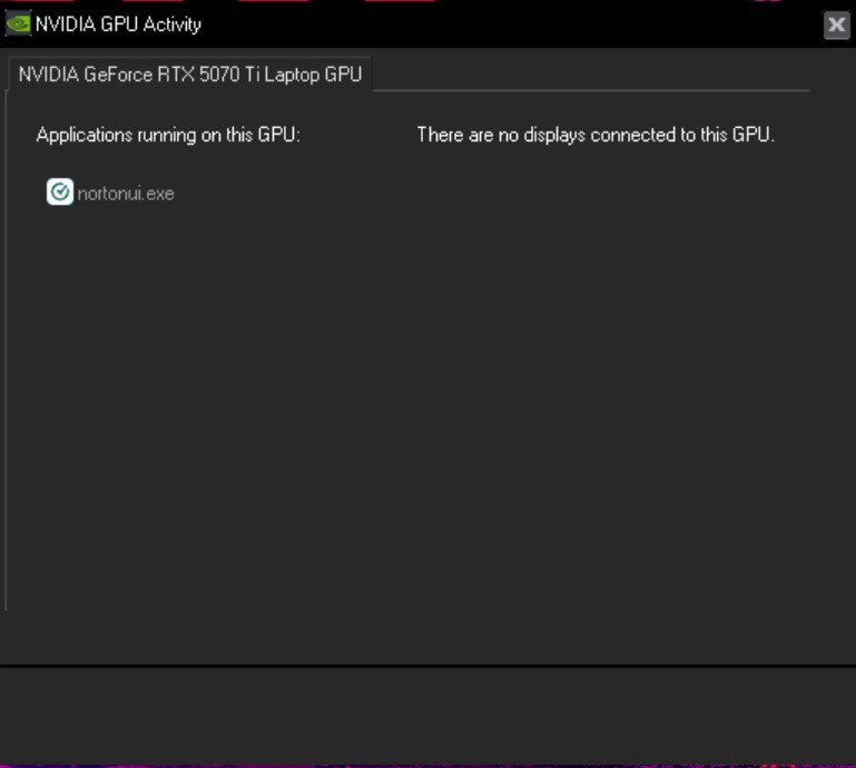

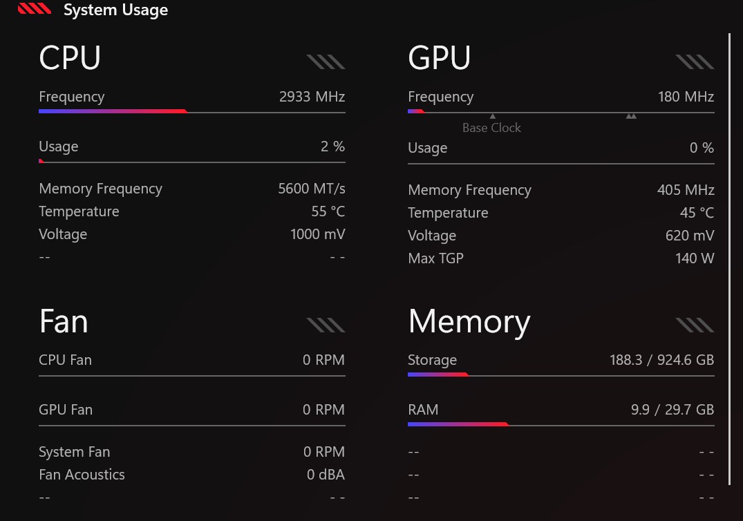

I’m experiencing this problem as well. After updating Norton 360 on 5/1/26 I noticed my NVDIA GPU activity monitor was lit up. nortonui.exe is using GPU for some reason. It didn’t do that before updating. I updated my video drivers and it’s still doing it, ran a full scan no malware found. I’d rather not re-install but I will if absolutely necessary. I don’t want my GPU getting burned up for a 2D UI. Screenies attached. I looked in task manager too, it intermittently shows GPU usage in there.
Seems like Norton pushed an update and it caused this. Keep us posted on a fix please.
See my above post in this thread.

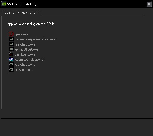

@360user125 My daily duster shows these apps running against my GPU. Norton UI isn’t present even with the UI open at the time of the screenshot. Note - This is an older GPU IMA.
I have integrated graphics on this laptop. I seem to remember my last laptop had discrete graphics and I seem to remember being able to allow and reject apps that can use the GPU. Check your settings for that.

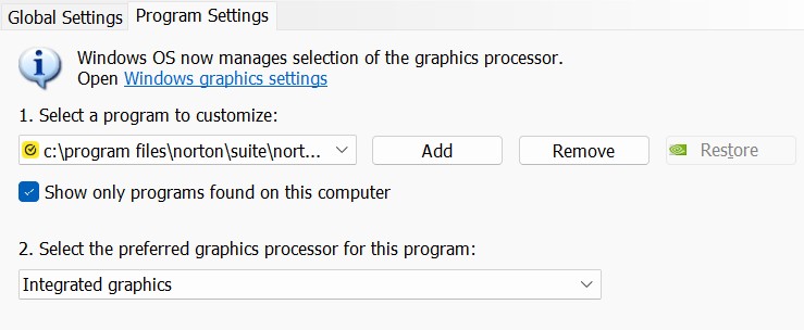

Tried to use nvidia settings to force nortonui.exe to use integrated graphics. That’s the first thing I tried. Didn’t work. There’s no reason my av should be using GPU IMO.
My suggestion was to see if you could set Nortonui.exe to not use the GPU.

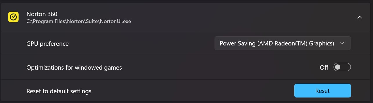

Just updated AMD drivers too. Set nortonui.exe to run on iGPU in both windows settings and nvidia. No dice. It’s AV so i imagine it has higher priority than other apps. I dunno next is re-install. Not a huge deal really, I’ll wait for another update from Norton before I NRnR tool it. :slight_smile:
