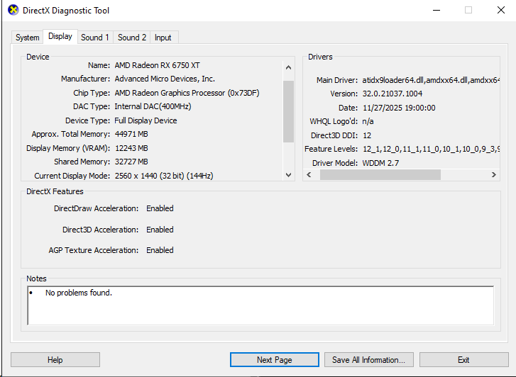

I have all the default settings enabled on my system, here is a snippet from dxdiag:

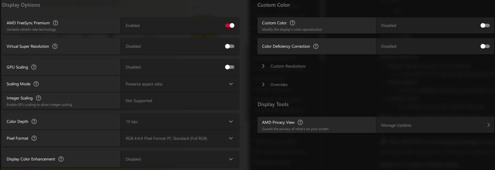

As for my GPU drivers, I’m not overclocking the card, and all the settings are set to default with the exception of one setting that was auto-enabled:
I assume this is because the monitor I have is FreeSync compatible.

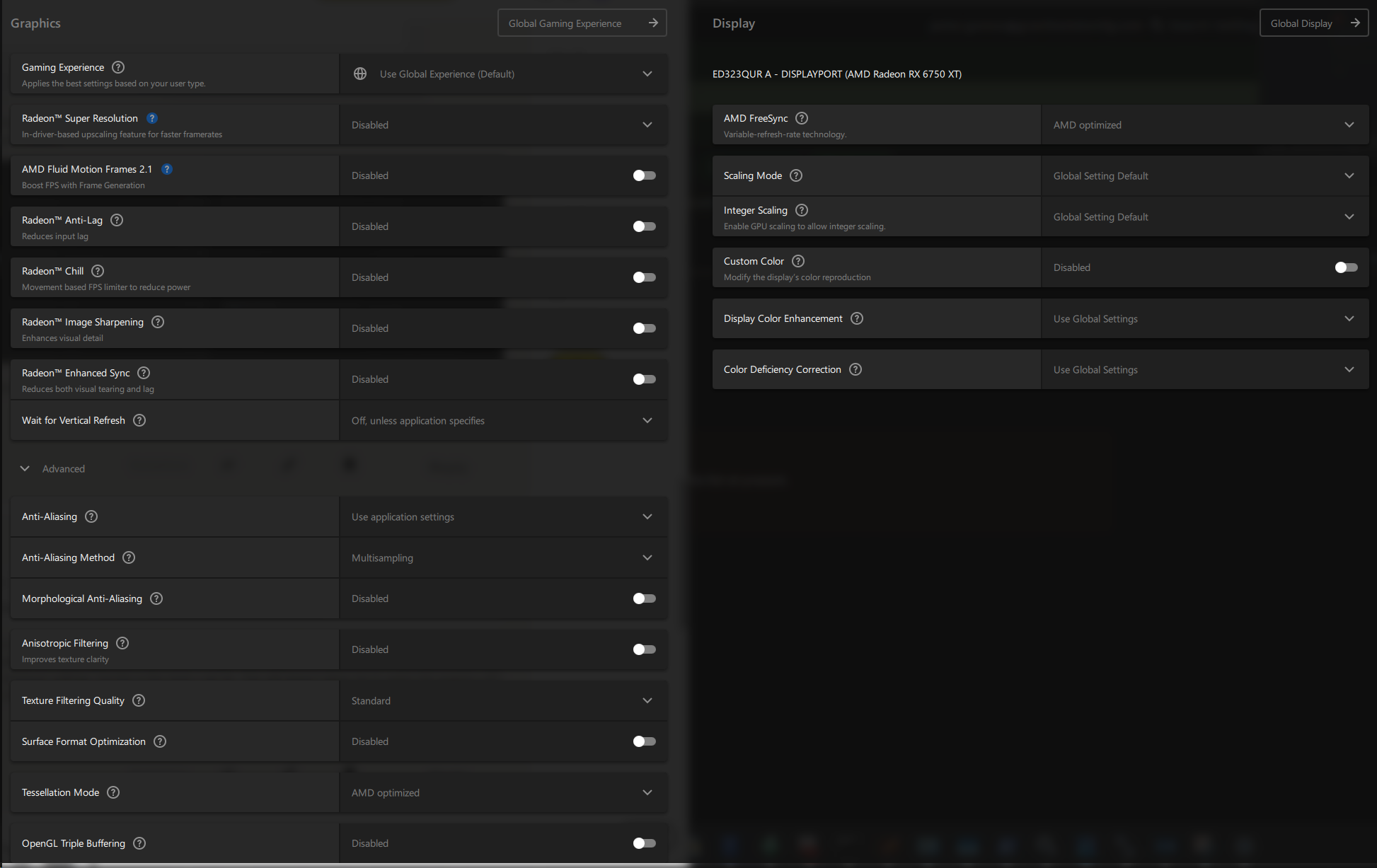

Also, I’m not able to force a specific API with my GPU drivers, the choice of API is made by the application itself. The best I can do is pretend that the program “NortonUI.exe” is a game and add it to my library and I can adjust the profile to select the bare minimum settings, but this is the most I can do. This still doesn’t allow me to switch the graphics API itself (OpenGL vs DirectX vs Vulkan).
-Pyro
For a visual reference, these are the settings I can change after adding NortonUI.exe as a “Game”:
Any of these options stick out to you? They are all disabled currently.

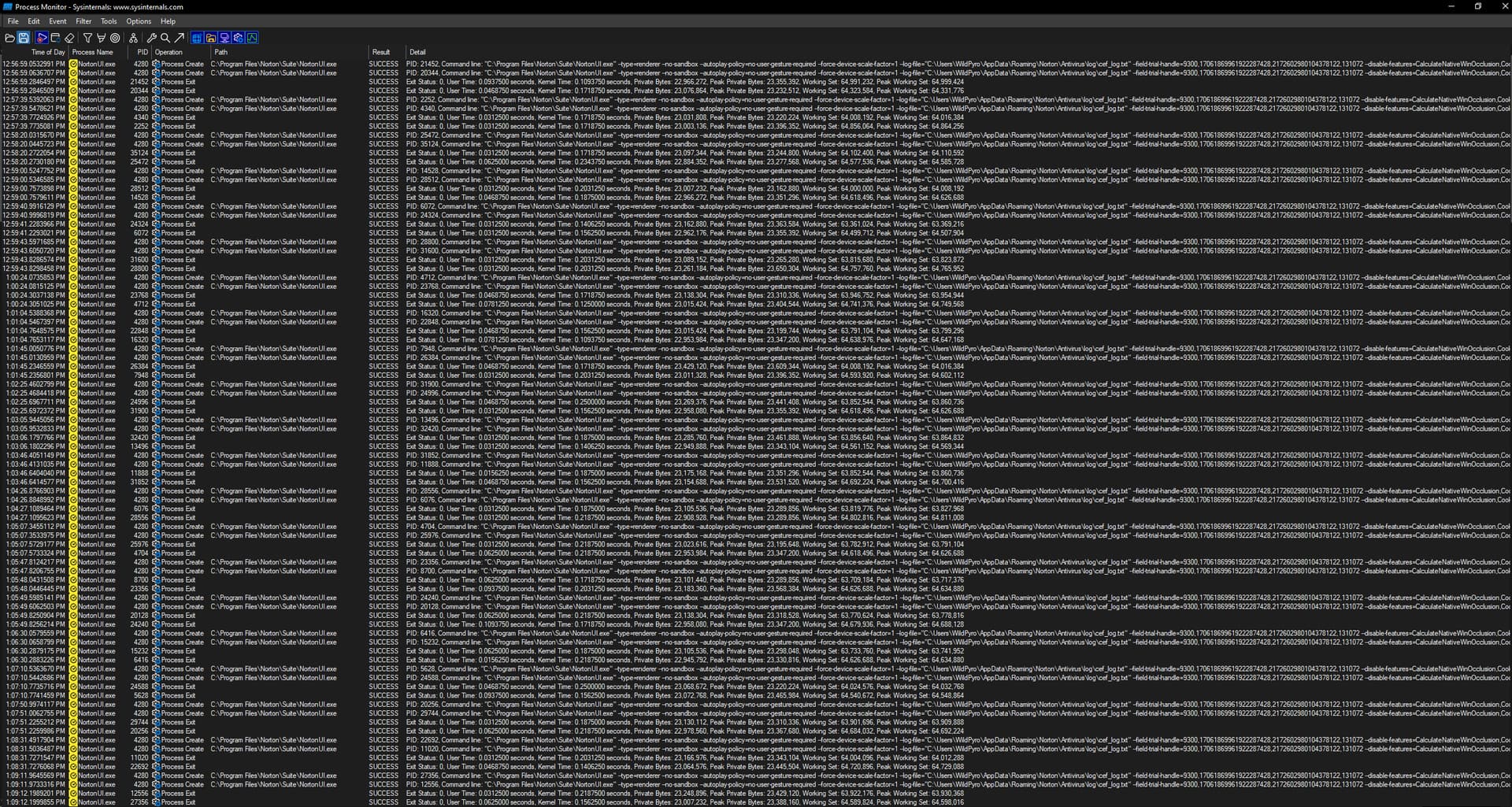

I did have a chance to try a clean boot state tonight. (All startup programs disabled, and all services except Microsoft ones disabled) and unfortunately, I’m still getting multiple errors:
PID: 2668, Command line: “C:\Program Files\Norton\Suite\NortonUI.exe” --type=renderer --no-sandbox --autoplay-policy=no-user-gesture-required --force-device-scale-factor=1 --log-file=“C:\Users\WildPyro\AppData\Roaming\Norton\Antivirus\log\cef_log.txt” --field-trial-handle=3204,291584864862848590,12491982115181163479,131072 --disable-features=CalculateNativeWinOcclusion,CookiesWithoutSameSiteMustBeSecure,SameSiteByDefaultCookies,SameSiteDefaultChecksMethodRigorously --disable-gpu-compositing --lang=en-US --log-file=“C:\Users\WildPyro\AppData\Roaming\Norton\Antivirus\log\cef_log.txt” --log-severity=error --user-agent=" (0.0.0) (Windows 10.0)" --disable-webaudio --force-wave-audio --disable-software-rasterizer --no-sandbox --blacklist-accelerated-compositing --disable-accelerated-2d-canvas --disable-accelerated-compositing --disable-accelerated-layers --disable-accelerated-video-decode --blacklist-webgl --disable-bundled-ppapi-flash --disable-flash-3d --enable-aggressive-domstorage-flushing --enable-media-stream --disable-gpu --disable-webgl --disable-gpu-compositing --allow-file-access-from-files=1 --force-device-scale-factor=1 --pack_loading_disabled=1 --device-scale-factor=1 --num-raster-threads=4 --enable-main-frame-before-activation --renderer-client-id=7 --mojo-platform-channel-handle=9852 /prefetch:1

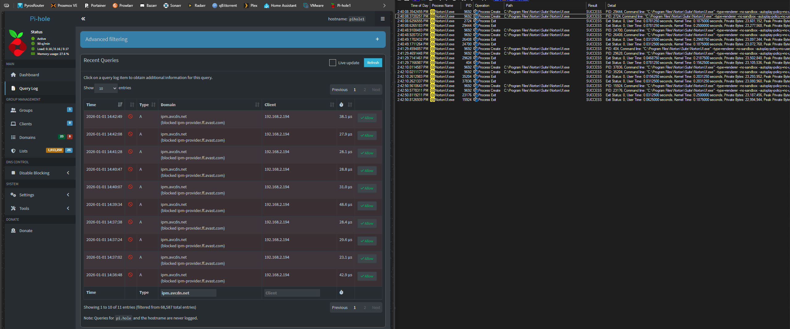

After re-installing Norton 360, it immediately started crashing and I watched my PiHole DNS queries for the ipm.avcdn.net URL and low and behold, it matches up PERFECTLY with the crashes on the right:
I have just white-listed this address and will report back after a few hours to see if the crashes have truly stopped. Thank you very much for bringing this to my attention!
-Pyro
