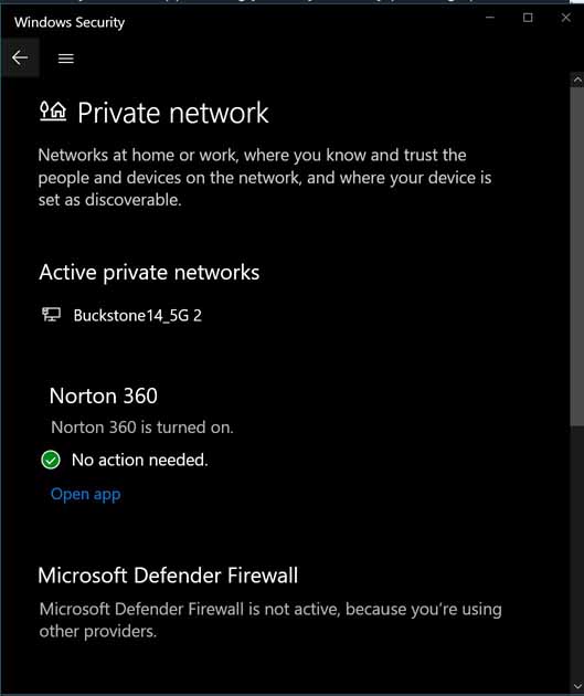

Windows Defender Firewall shows….
and Task Manager shows…
[Sorry, the forum is not allowing me to display more than one image - what a narrow perspective to adopt for an exchange of information forum!]
with LocalServiceNoNetworkFirewall sitting at the top of CPU utilisation [you’ll need to take my word for this].
This suggests to me that Windows Defender, in contradiction with what it shows above, thinks that there is no firewall running and is stepping in to fill the supposed gap. If that is the case, then it would appear Windows Defender is at fault.
But, I do not allow automatic Windows updates and I first noticed LocalServiceNoNetworkFirewall increased CPU utilisation between Windows updates, therefore any other influencing factor is most likely to have been introduced through a Norton 360 automatic update.
I do not know what interaction there is between Norton 360 Firewall and Windows Defender Firewall, but something is getting lost in translation between the two. Norton is not the only product affected, I have come across Kaspersky users complaining of the same issue.
