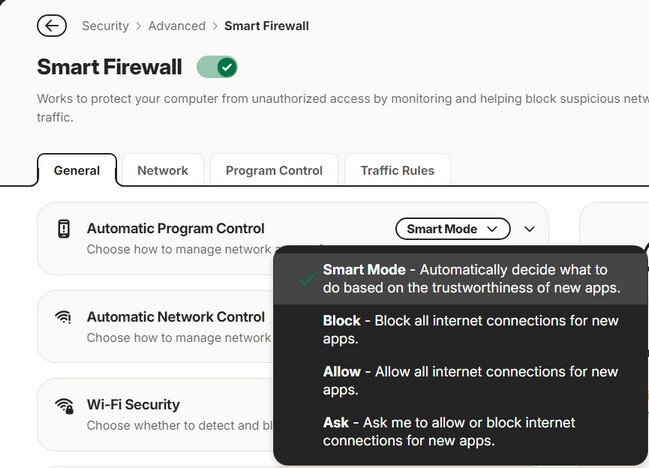

To stop persistent notifications about apps accessing the web in Norton 360, you need to adjust the Smart Firewall settings to “Allow” programs automatically or manually define rules for the specific apps that keep prompting you. This often happens when Norton is set to “Ask” for permission rather than using its automatic decision-making Smart Mode.

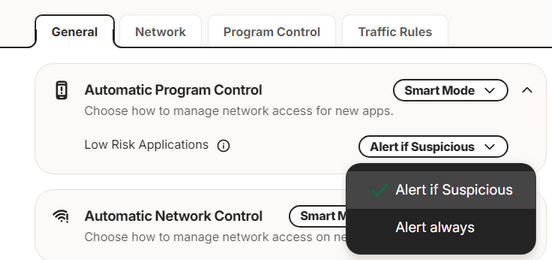

  • Automatic Program Control → Smart Mode
  • Low Risk Applications → Alert if Suspicious

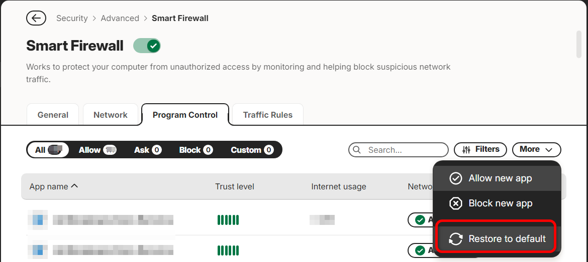

  • Program Control → Restore to default

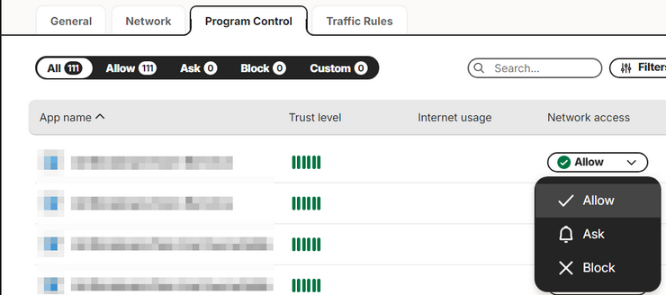

  • Trust Levels: In the Program Control tab of your Firewall settings, ensure the specific app isn’t just set to “Ask.” Manually change its status to Allow to override the Smart Firewall’s daily evaluation of the program.

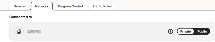

  • Network Type: If your home network is fluctuating between “Public” and “Private,” Norton may reset firewall rules for safety. Ensure your network is set to Private in Security > Advanced Security > Smart Firewall > Network.
