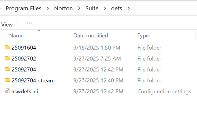

how’s your space?
Thank you for the follow-up.

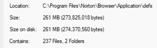

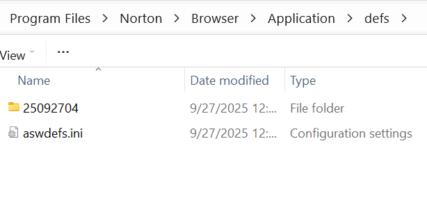

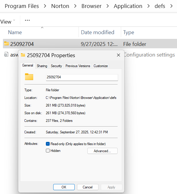

Overall drive space is the same.
The last time we chatted, there were two subfolders of definition files. Today, there is only the one, current folder of ~250 MB.
