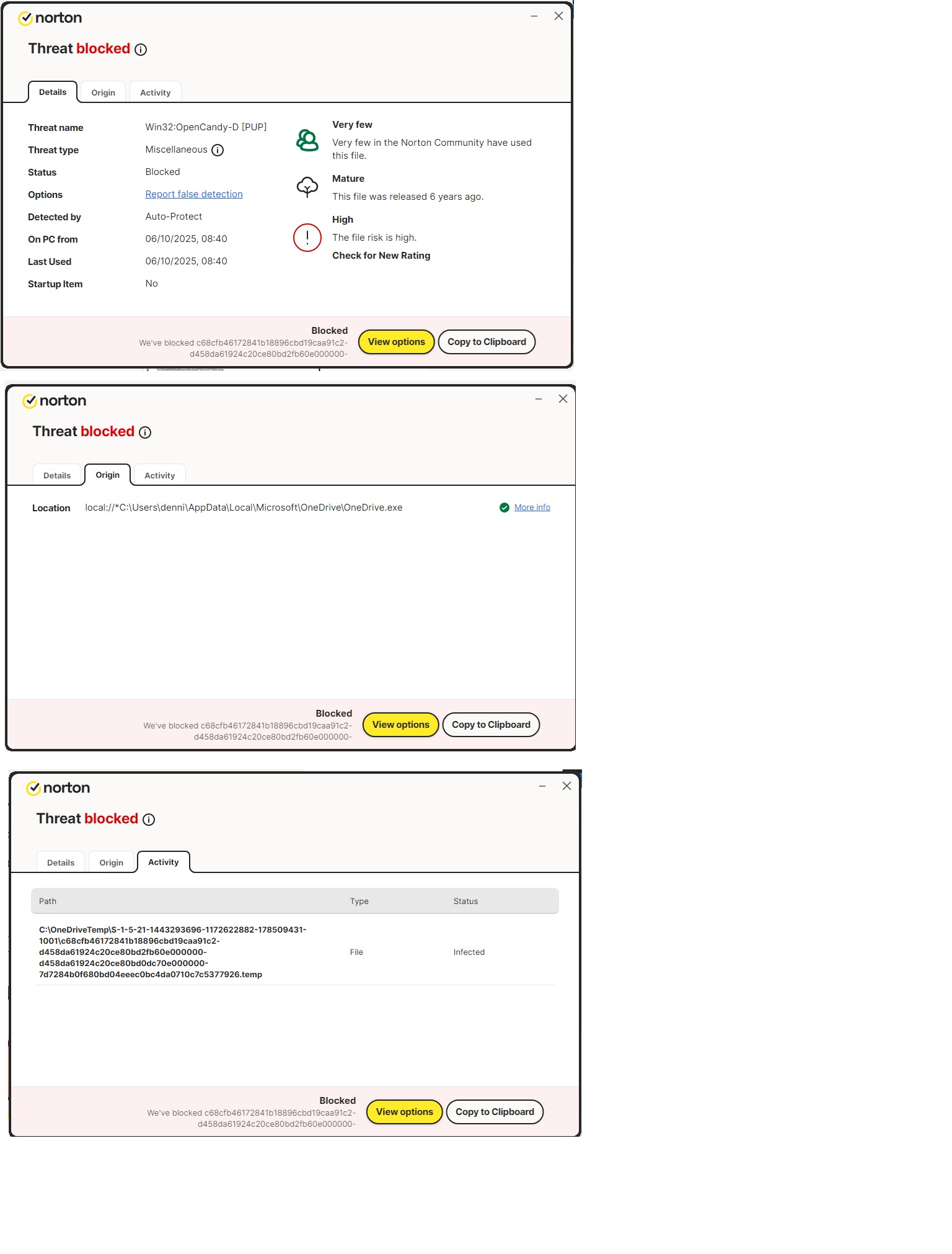

New laptop with pre-installed Norton for Gamers.
Every ~20 seconds I get a notification with threat for win32:pup-gen, win32:OpenCandy and variants of these PUP threats.
The origin is always onedrive.exe. I use OneDrive and have it installed myself.
How serious is this threat and how can this be solved?

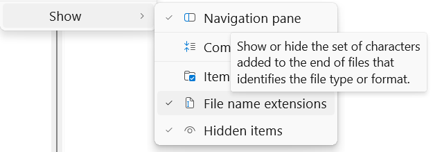

\AppData\Local\Microsoft\OneDrive.exe = head scratch

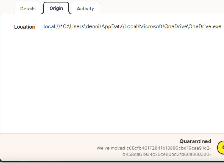

This one \AppData\Local\Microsoft\OneDrive.exe = head scratch I didn’t understand. But then the comment below from SoulAsylum. So I removed the file from the folder. Did full scan, restart, and didn’t get new threat notifications anymore. But can also not run OneDrive anymore, so that I will need to reinstall I guess.

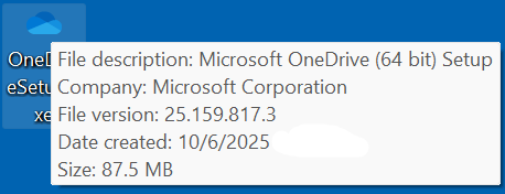

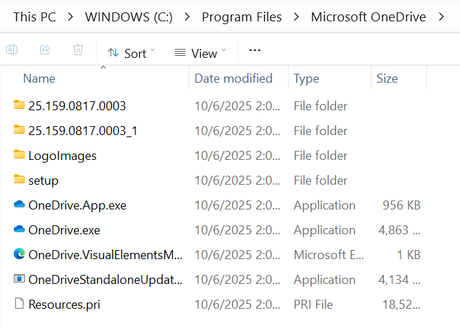

Hello @user9465
Is this your OneDrive from M$ website?
https://www.microsoft.com/en-us/microsoft-365/onedrive/download
File: OneDriveSetup.exe
File size: 87.5 MB (91,778,920 bytes)
MD5 checksum: 72AC202B786447776498CA176D059C5A
Date/Time: 10/6/2025
fwiw ~ as test:
OneDrive.exe with Program Files?
OneDrive.exe with \AppData\ = head scratch
Indeed, if the installation location changed for OD and you didn’t perform that malware most likely is at play. Guru Bjm laid that out nicely earlier.

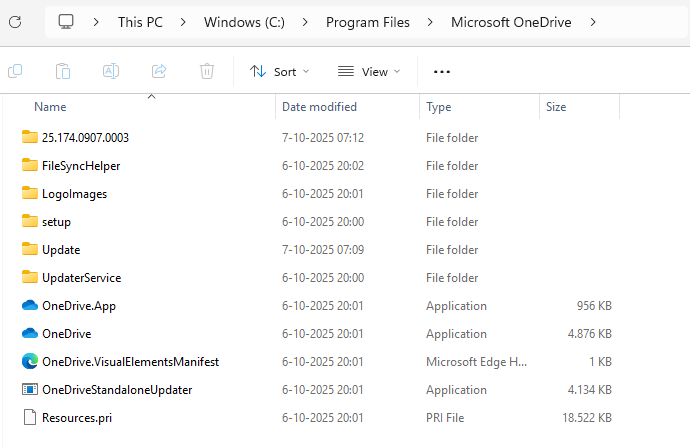

Hi bjm,
Thanks again.

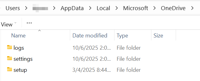

I removed OneDrive.
Indeed, I downloaded from the same location from Microsoft website. And re-installed it:

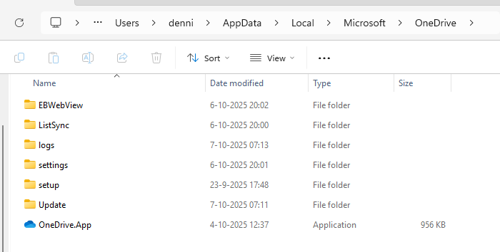

In AppData it look like this now:
<I can only do 1 snapshot per post as I’m new to this forum, so I’ll post it separately>
Before I removed OneDrive, in AppData it had more files and at least application files OneDrive.App and OneDrive. I guess like it’s now in Program Files.
For now, Norton is silent. OneDrive is syncing. I’ll keep you updated about the status.
Thanks for your help and time. Appreciated!
fwiw ~ my OneDrive…Apps → Installed apps → Uninstall…left residual files with Program Files and AppData…before & after my machine Restart (not Shut down).
Your Oct 06 with Oct 07 dates (maybe) suggests…you did not scour File Explorer for residual files…did not Restart machine…before your OneDrive re-install.
I’m curious…did you run Norton full scan &or Malwarebytes threat scan…after OneDrive re-install?

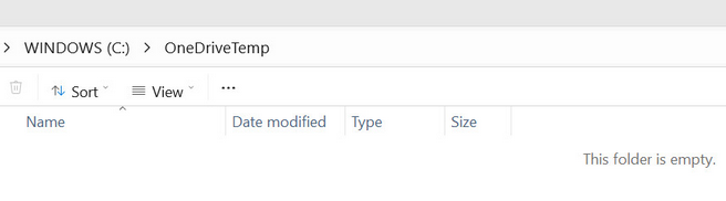

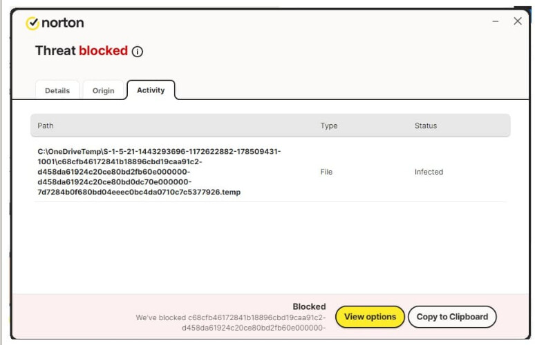

I’m curious…what your OneDriveTemp folder looked like when Norton was not silent.

OneDrive.App = OneDrive.App.exe
OneDrive = OneDrive.exe

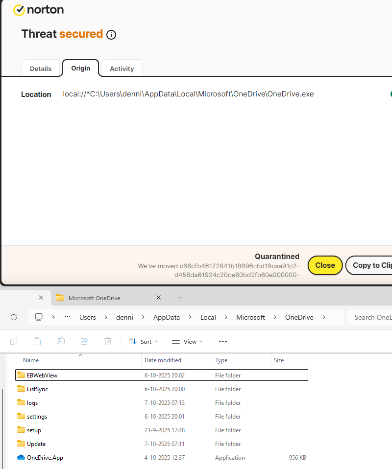

Urghh. The Norton notification is back. Strange enough, the OneDrive.exe file is not in the folder Norton says it’s the location.
again…I’m not familiar with OneDrive.

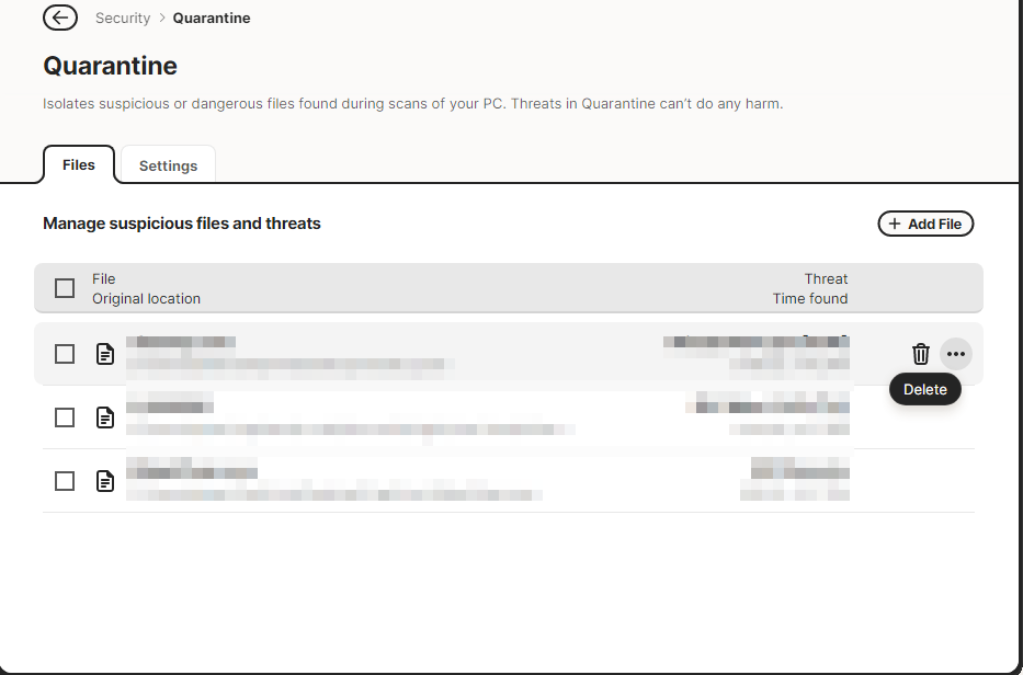

did you Delete… Norton 360 → Quarantine files?

No, didn’t delete the quarantine files yet, but will do. I’m not logged in Norton.

c68cfb…77926.temp Blocked
c68cfb…77926.temp Quarantined
