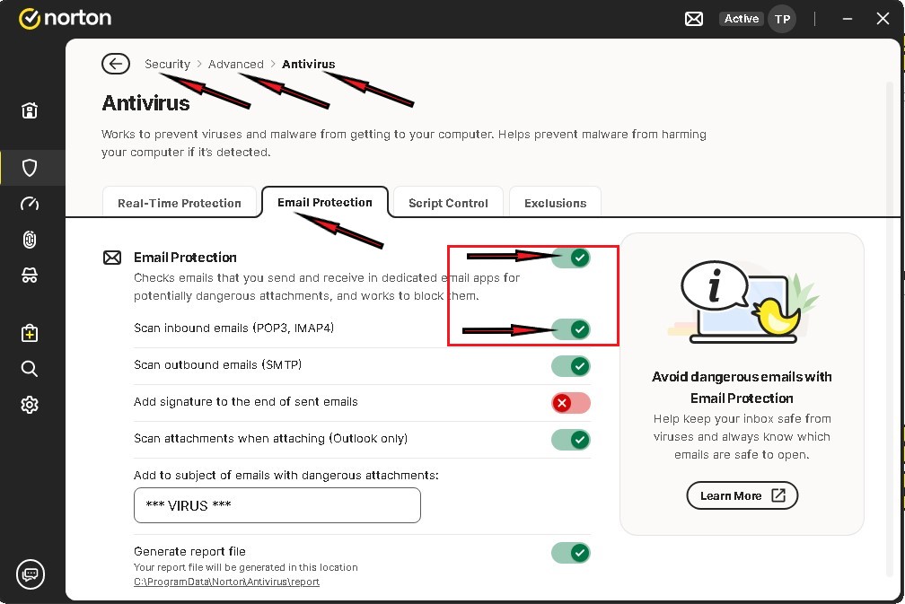

The latest Norton 360 with it’s Email Protection causes a problem with the VPN on and even with the outlook.exe exclusion in the Split Tunnel. You must turn off email protection. See my post on Cannot log in to email when VPN turned on - #14 by userharry

@Dale_Naleway As a suggested test, review the screenshot below for my suggestion. Disable the two settings I have boxed and test, ONE at a time. Re-apply the settings if there are no changes to your mail issue.
