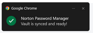

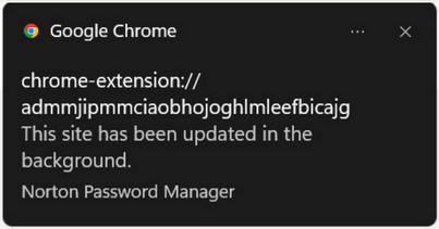

Installed Norton Password Manager 8.3.0.1361 on Chrome 148.0.7778.97 + “Keep my vault unlocked for 7 days” enabled + “Continue running background apps when Google Chrome is closed” enabled.
Upon machine Restart and after waiting for desktop to settle — call Chrome — “orange triangle” initially and after a moment vault unlocks.
Caveat: Chrome clear cookies/site data off. Chrome sync off. Passwordless Vault Unlock off. Google Password Manager off. W11 Fast Startup off.
