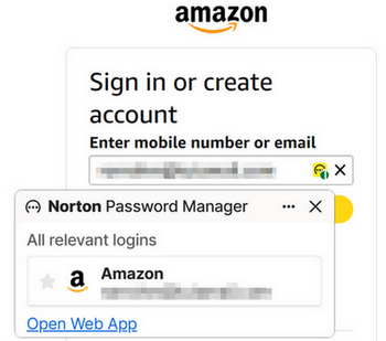

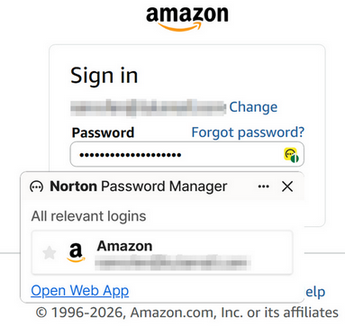

fwiw ~ as test:
click-to-fill working as usual my side
Norton Password Manager v8.3.1.1559
Chrome v154.0.8037.58
W11 Home 25H2
@bjm, thank you for the screenshots. I do get the popups from NPM, as you have captured, but NPM does not fill the e-mail nor the password into their respective fields. I did uninstall Google Chrome browser (v.153.0.8010.53) and reinstalled it with v. 154.0.8037.58 (Official Build) (64-bit) but that did not solve my current issue.
