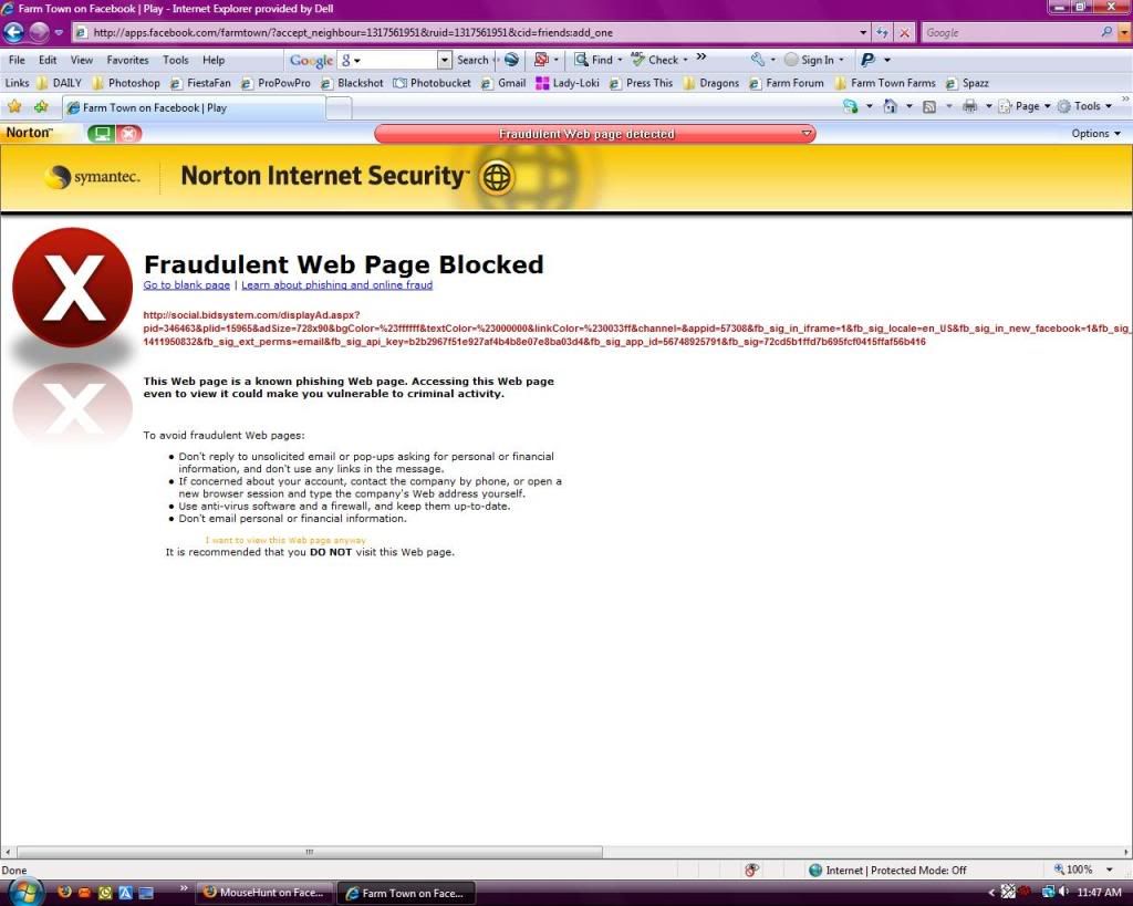

I just received the stock reply that my issue could not be reproduced and that no further actions would be taken.
The issue is plainly visible in this user provided screen-shot:
http://i169.photobucket.com/albums/u235/Loki052479/Farm%20Town/FT-Phishing-1.jpg
The toolbar indicates that the user is on the following facebook app:
http://apps.facebook.com/farmtown/
The error message provides a URL:
http://social.bidsystem.com/displayAd.aspx?pid=346463&plid=15965&adsize=728x90&bgColor=%23ffffff&textColor=%23000000&linkColor=%230033ff&channel=&appid=57308  (followed by several facebook variables)

Based on the screenshot provided to me by the client, it looks like they are using "Norton Internet Security".
I do not know the version number, nor is the version number emitted in the "Fraudulent Web Page Blocked" screen (probably a good feature request there).
My client has had multiple reports of this issue (he has 100s of thousands of users).
All of these reports started yesterday during the day. So it's quite likely that these users are using the fully patched version. Otherwise reports would have started last week.

I should point out that in the screenshot the url that is being blocked is social.bidsystem.com.

I would say from the screen shot linked to with that first message showing an error message that the user was not using the current NIS 2009 I am and/or that it is not fully uptodate -- which is why the Symantec Staffer asked what software was being used.

After reviewing some Norton Antiphishing system configuration information, I can confirm that the cubics.com and bidsystem.com domains are on a "safe list"; pages and frames that originate from these domains should not be blocked as phishing pages.
If you are seeing this problem, please consider performing the following steps to be certain you are using the current antiphishing definition content in your browser session:
1. Run Live Update and apply any necessary updates; reboot your system if prompted by Live Update to ensure all updates are applied.
2a. If running NIS09 or N360v3, allow the Idle Timeout period to elapse.
-- This step is necessary so a Background Job can execute to produce a new antiphishing configuration file.
-- You can monitor the idle timeout or change its setting by clicking the CPU Usage link on the main UI
-- From the CPU Usage screen, check the list of Background Jobs and confirm the job named "Antiphishing Updates" has executed recently.
2b. If you are not running NIS09 or N360v3, the antiphishing configuration update occurs as part of the LiveUpdate session.
3. Close all browser windows, launch a new browser, repeat browsing the problem website.
If you still see phishing block page problems after performing the above steps, send me a PM and I will reply to you with further instructions on collecting debugging information from your system.

MJP -- Thought everyone would like to know that another user ProTruckDriver  followed your instructions and it fixed his inability to log into AOL with similar messages as here:
See  Re: NIS Blocking AOL sign in window. for his report.
