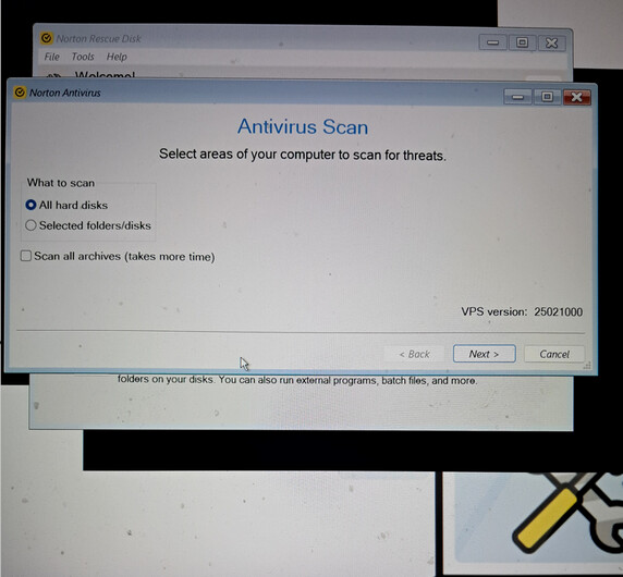

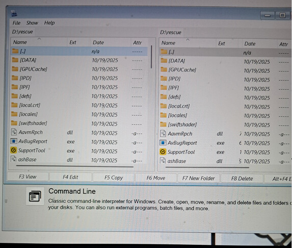

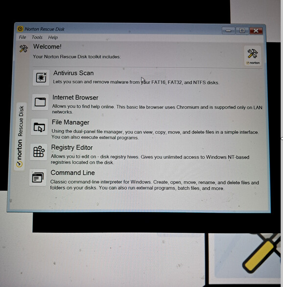

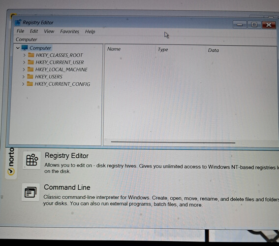

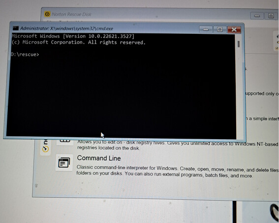

fwiw ~ as test:
W11 24H2 (Shut down - Fast Startup disabled)
VPS version: 25021000

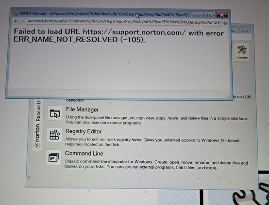

Command Line
Internet Browser
File Manager opened
Registry Editor opened
Caveat: Rescue Disk UEFI created before v25.10
Scan and resolve threats using Norton Rescue Disk here Last modified: 09/26/2025

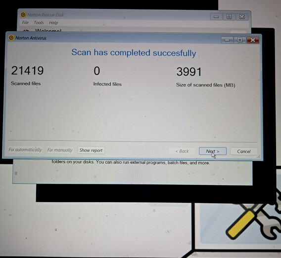

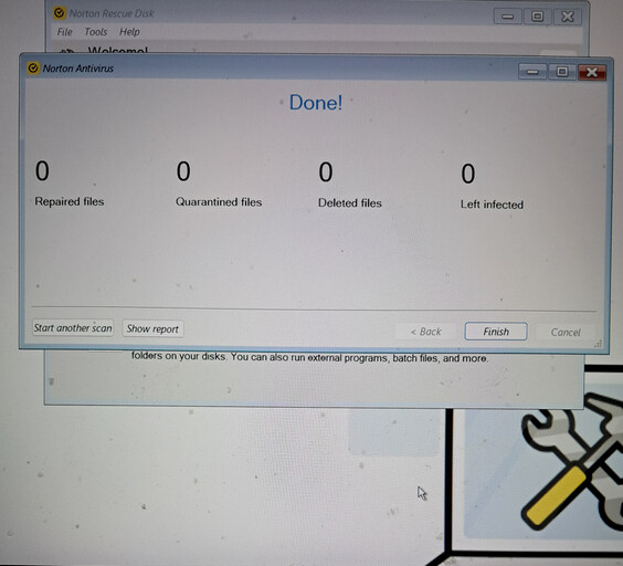

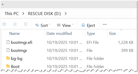

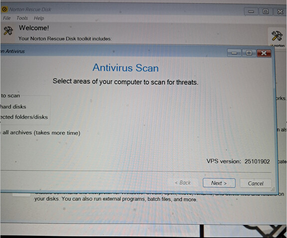

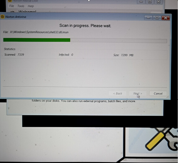

fwiw ~ as test:
Rescue Disk UEFI created with v25.10
test results similar to Rescue Disk created before v25.10
VPS version: 25101902
Registry Editor
File Explorer

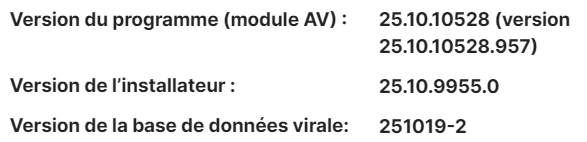

Norton version is :
The pictures in your post were exactly what I had before the problem occured.

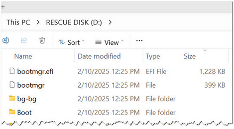

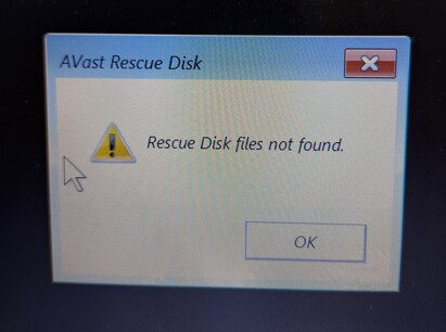

here below is the exact message I have after the choosing the boot. it’s strange because I’ve checked the USB key and I can see the files in it.
