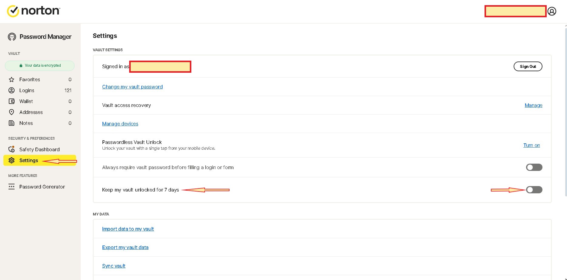

Never tried it - there is a way to keep Vault open for 7 days. Open PWM - click on 3 bars top right hand corner - click on .’Settings’ - scroll fully to bottom - ‘See All Settings’ - ‘Manage Devices’ - switch on ‘Keep Vault Unlocked for 7 Days’
EDITED by me:
Check this setting in PWM settings. Norton appears to now limit to 7 days for security reasons.
