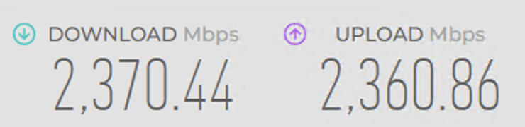

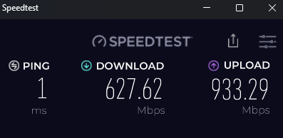

image below: with NetAdapterCx driver architecture.

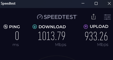

image below: with NDIS driver architecture

I updated my RTL8125 PCI-E to the NetAdapterCx Driver and it seems fine - maybe something with Norton and the USB adapter or the speed test server you’re connected to - I notice that my speeds vary drastically even without Norton and before and after switching the driver.

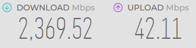

Hi @Geek007,
The bandwidth in your two tests is similar in download. Your system doesn’t seem to be affected although your upload seems to vary in that test.
My speeds are constant always. That’s why I am sure there is an issue here. I have a good service provider. Maybe 5 or 50Mb of difference is ok in tests but losing 380Mb is a bug to fix. Also, tests are done without any other device using the bandwidth to be fair.
Seems to be Norton the application that causes the issue when installed. Maybe an issue between Norton and Realtek. Maybe with Laptops only. That’s why more testing is needed, but there is definitely a bug here.

Yeah probably with the way Norton is interpreting the USB adapter and NetAdapterCX driver, both my screenshots were taken after the driver update but on different speedtest.net servers.
