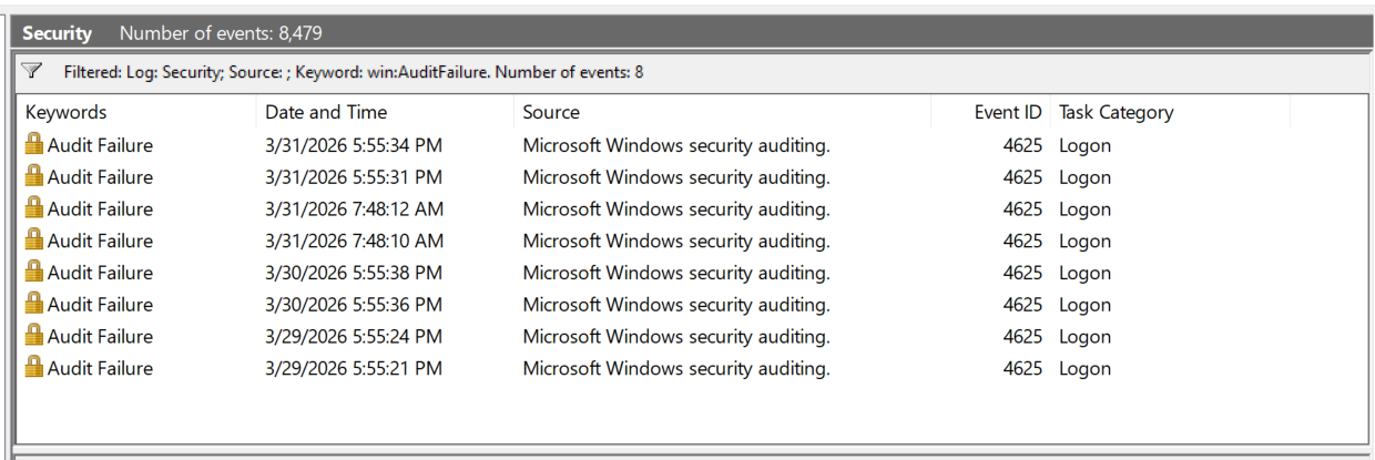

They would be visible under the Audit Failure category on Event Viewer
~ fwiw ~
As they’re daily in pairs it’s worth checking they’re ones from NortonUI.exe and mention password failure for the Windows user’s account - as there can be other occasional 4625 over time from other sources that are ‘Account currently disabled’ or similar.
Hello @jwsg
What Filter do you use?
~ fwiw ~ my 8 Audit Failure events are all: NULL SID
Log Name: Security
Source: Microsoft-Windows-Security-Auditing
Date: 3/31/2026
Event ID: 4625
Task Category: Logon
Level: Information
Keywords: Audit Failure
User: N/A
Computer: HPW11
Description:
An account failed to log on.
Subject:
Security ID: NULL SID
Just recently I got 26.3.10886 but this started in the last week or so with a 26.2 version.
I think those are more likely some ‘background’ 4625s that always seem to happen over time, scrolling down to Process Information: Caller Process Name: it likely won’t say “C:\Program Files\Norton\Suite\NortonUI.exe”.
The Windows Event log is always full of various events, most of which can be ignored, but seeing regular 4625s with a security ID of the Windows login and a source of NortonUI.exe, was unusual enough to mention - although it’s not something that affects everyone by the look of it.
