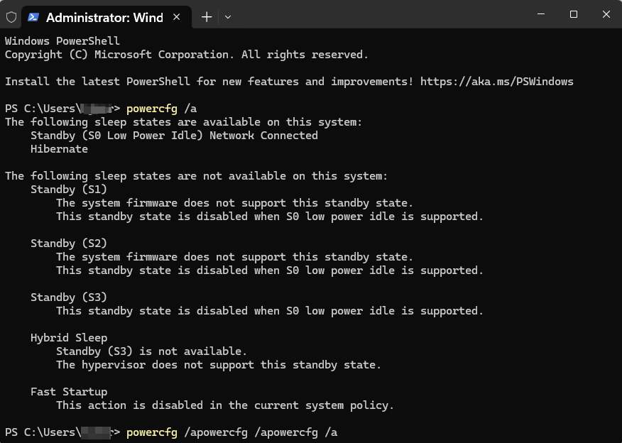

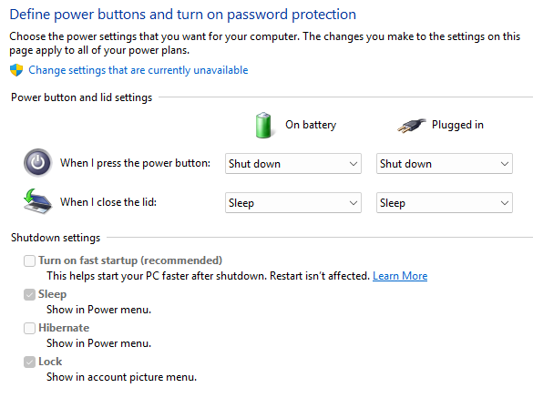

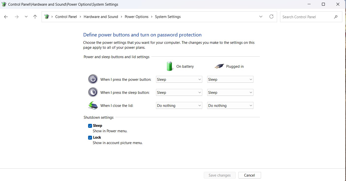

Do you run Windows Fast Startup enabled?
Are “times” associated with machine shutdown, machine restart, machine hibernate/sleep, background tasks/scheduled tasks?
Were my machine. I’d add mutual exclusions…as test…to see whether exclusions helps…your scenario. Just me.

My laptop does not have the option to hibernate or fast start. See screenshot.

If hibernation is already disabled, the Fast Startup option will not appear. Fast Startup depends on hibernation being enabled. You can check which states are available by running powercfg /a from an administrator command line.
~ for example: my W11 Home 25H2

Thank you for all of your time and assistance!
