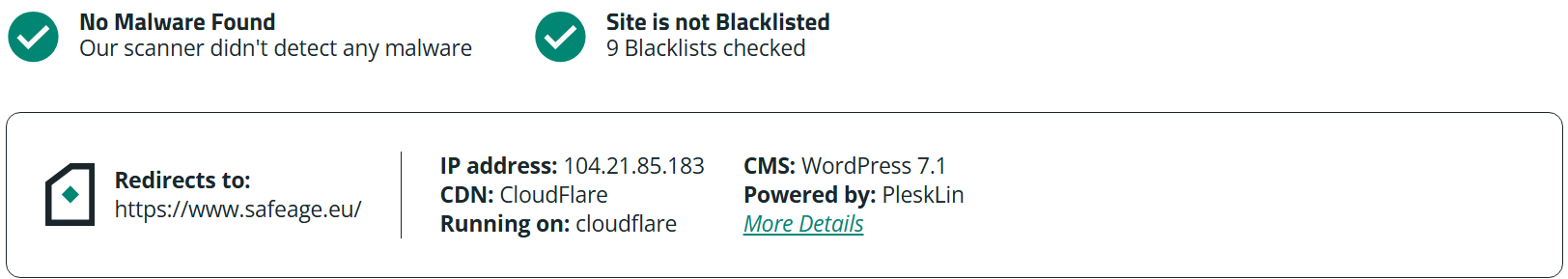

An independent Sucuri SiteCheck scan returns no malware and no blacklist entries. Google Safe Browsing reports “No unsafe content found” (checked 31 August 2026).
Of 36 reputation engines checked via aggregated scanning, only Norton, Avira and Gridinsoft flag the domain. Bitdefender, Dr.Web, Fortinet, SURBL, Spam404, PhishTank, OpenPhish and URLhaus all report nothing.

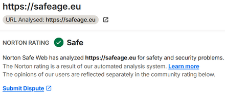

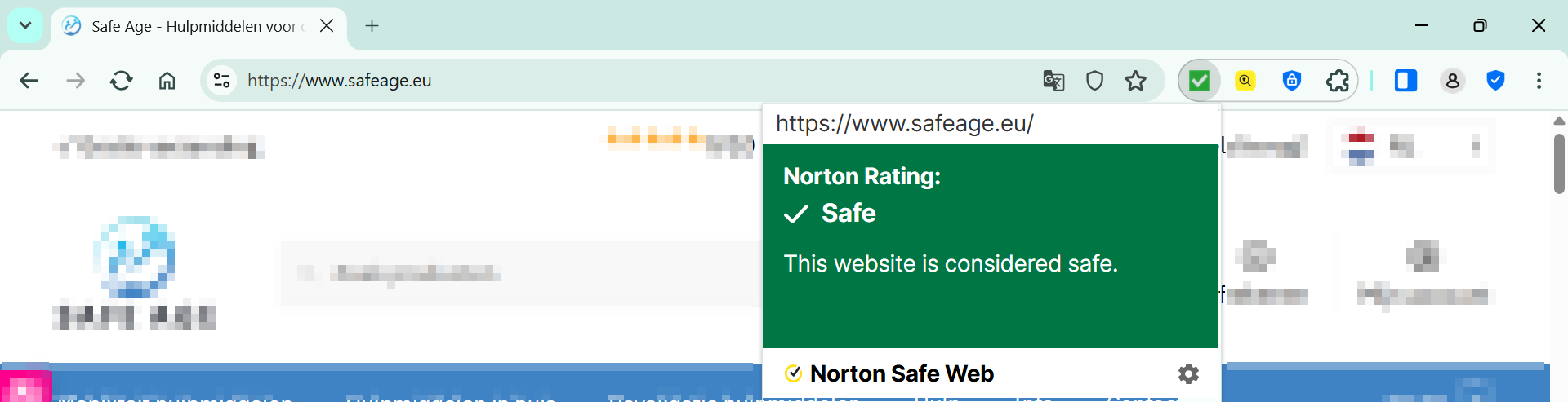

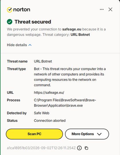

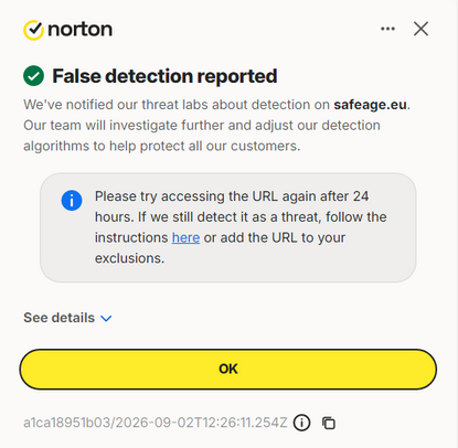

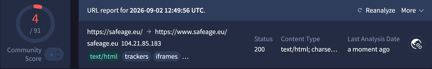

Hello @user13803
We’ll try to call attention:
https://safeage.eu/
Threat name: URL:Botnet
URL: safeage.eu
Alert ID: d1f658181781
a1ca18951b03/2026-09-02T12:26:11.254Z
https://safeage.eu/
AbuseIPDB » 104.21.85.183
We resolved the domain safeage.eu to IP address 104.21.85.183
104.21.85.183 was not found in our database
This IP was reported 0 times.

The site is clean by every independent measure: full server-side audit, Sucuri reports no malware and no blacklist entries across 9 lists, Google Safe Browsing reports no unsafe content, AbuseIPDB has zero reports for the hosting IP, and only three engines out of the whole field flag the domain.

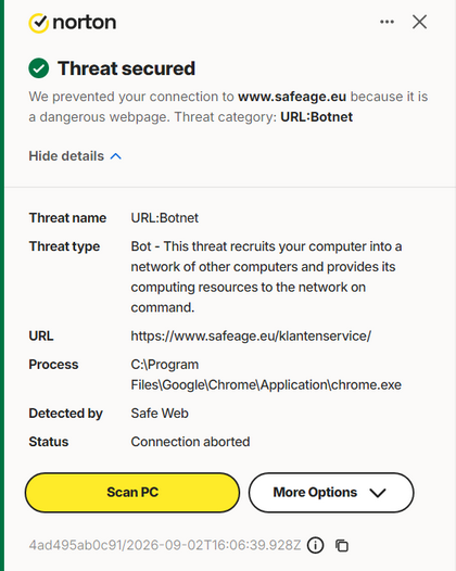

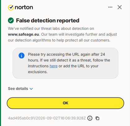

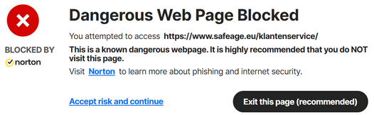

Hello @user13803
fwiw ~ my understanding:
https://safeage.eu/klantenservice
URL: www.safeage.eu
Alert ID: 69e411f79c3c
4ad495ab0c91/2026-09-02T16:06:39.928Z
https://safeage.eu/winkelwagen/
147c47c49209/2026-09-02T16:23:50.126Z
https://safeage.eu/mijn-account/
13604fb14667/2026-09-02T16:24:35.383Z
https://safeage.eu
288ed91671f4/2026-09-03T11:55:35.596Z
7dd9e916d069/2026-09-03T12:34:57.124Z
https://safeage.eu
05bf95be5c34/2026-09-03T17:31:11.839Z
https://safeage.eu
b01b1332d7b3/2026-09-03T20:45:58.907Z

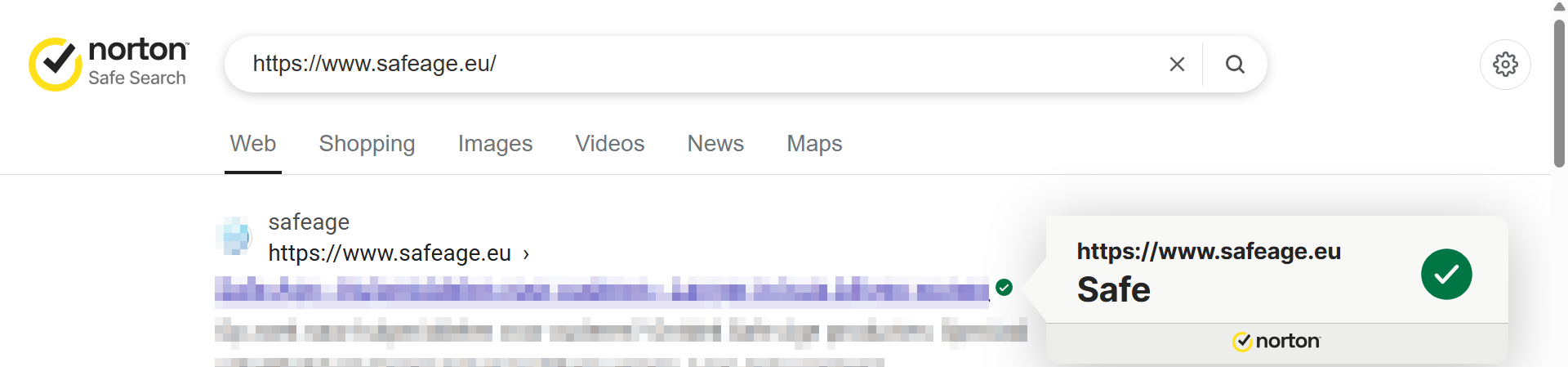

Hi @user13803
Thanks !
https://safeage.eu
Note: I still need Norton VPN IP address to reach safeage.eu
Testing in new Private Mode window and still getting ERR_CONNECTION_RESET
the block is network-based, my browser cache is innocent
