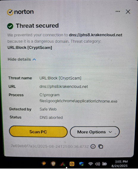

Here is the latest notification that just came in - it would not allow me to take a screenshot.
Threat secured
We prevented your connection to dns://phs8 (dot) krakencloud (dot) net because it is a dangerous domain. Threat category: URL:Block [CryptScam]
Threat Name: URL:Block [CryptScam]
URL: dns://phs8 (dot) krakencloud (dot) net
Process: C:\windows\system32\svchost.exe
Detected By: Safe Web
Status: DNS Aborted
a3fd5769d0d3/2025-08-24T20:25:40.613Z
I get the error message (same as above) if I try to view the entry in security history

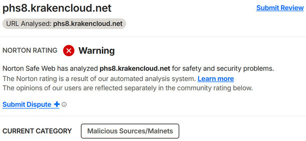

fwiw ~ phs8.krakencloud.net
7e69eb6f7a3c/2025-08-24T21:00:36.473Z
AI Overview
phs8.krakencloud.net is a domain associated with Kraken Technologies, a UK-based energy company that provides a cloud-based software platform for the energy and water industries. The domain has been flagged as malicious by multiple security databases.
Here’s what is known about the domain:
  • Malicious activity: Security analysis of the subdomain shows multiple instances of URLs being flagged for malicious activity. This activity includes association with the delivery of phishing and malware.
  • Legitimate owner: The parent domain krakencloud.net belongs to Kraken Technologies, which is part of Octopus Energy Group. The company uses its cloud platform to manage and optimize energy distribution for utilities and consumers. It’s possible the malicious subdomain was compromised or is being used fraudulently to exploit the trust of Kraken’s brand.
  • Security recommendations: As a security precaution, it is highly recommended that you do not click any links or download any files from this subdomain. If you have been directed to this address, assume it is part of a malicious campaign.

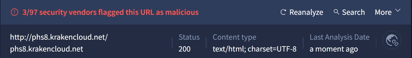

Use of the phs subdomain
  • The phs subdomain, followed by a number, is a common pattern for phishing and malicious activity, though not exclusively. Search results show other phs subdomains of krakencloud.net being flagged for malicious activity on sites like VirusTotal and URLhaus.
  • While phs8.krakencloud.net was not explicitly flagged in the provided search, the presence of similar subdomains with malicious tags suggests that it may be part of a malicious or phishing campaign.

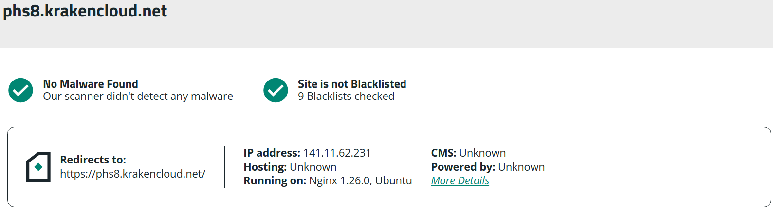

fwiw ~ my boiler plate
Related: Amsterdam, Holland EU
https://www.ip-tracker.org/lookup.php?ip=141.11.62.231
