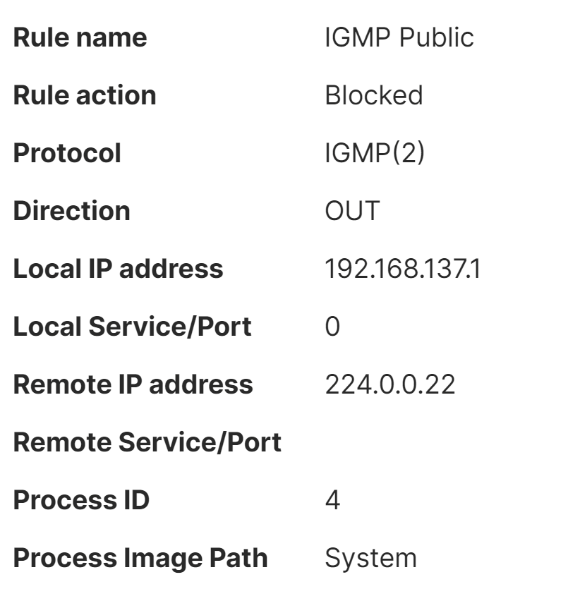

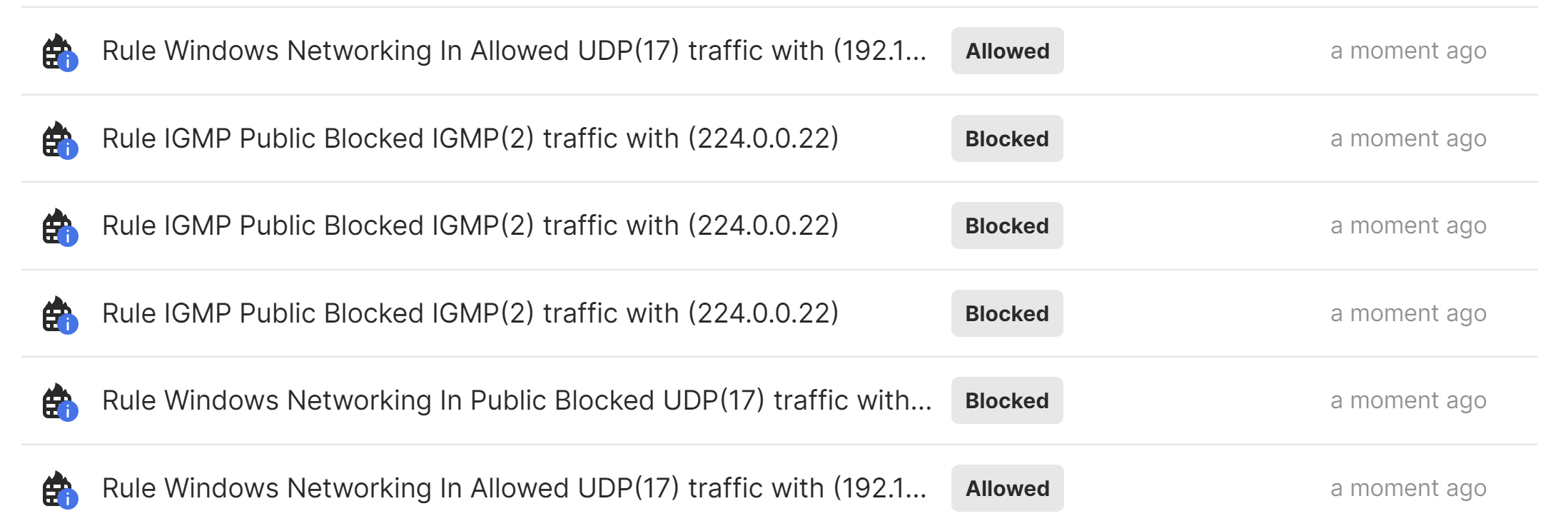

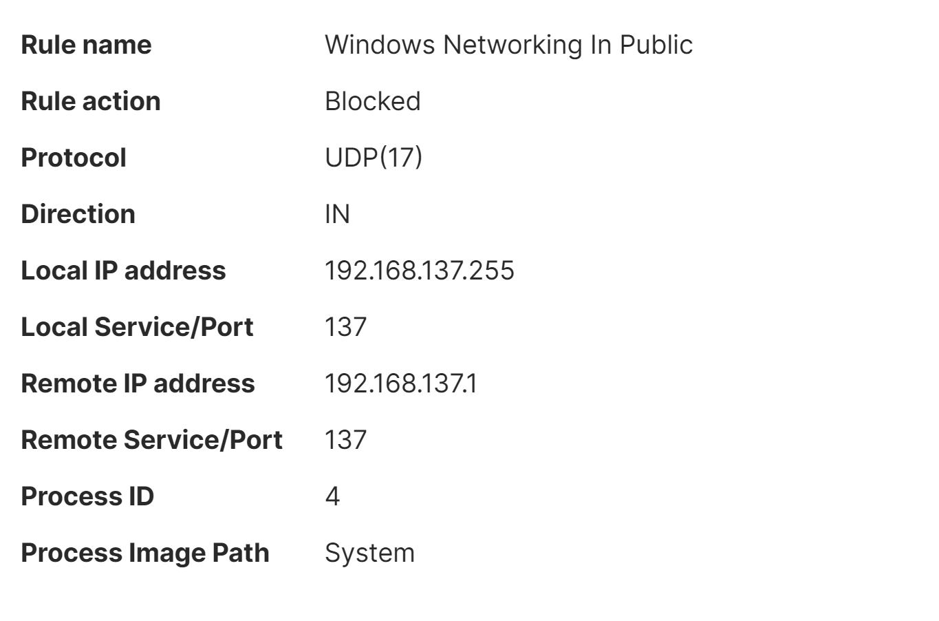

In your Security History, are there entries there stating Norton blocked the connection? If so move your mouse cursor to the right and an arrow will appear. Click it and open the advanced details. Can you get a screenshot and post here for us to review? That would help us help you figure out what the issue may be.

Does your Norton history show entries where this was blocked?

Screen cast to TV still not working. Nothing shows as blocked in Security History.
