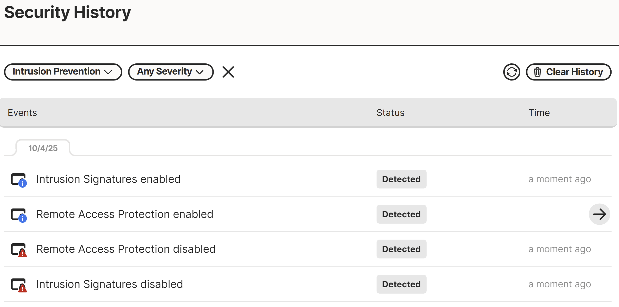

More curious behavior from the W11 optional “Wireless Display” App (“Connect” in W10 start list). On my W11 laptop when I use my W11 screen as a display to receive a screen cast from my W10 laptop I get Intrusion Signatures disabled and Remote Access disabled in my Security History. When I disconnect the cast both are enabled again.
Same when I cast the W11 laptop screen to the W10 laptop screen.

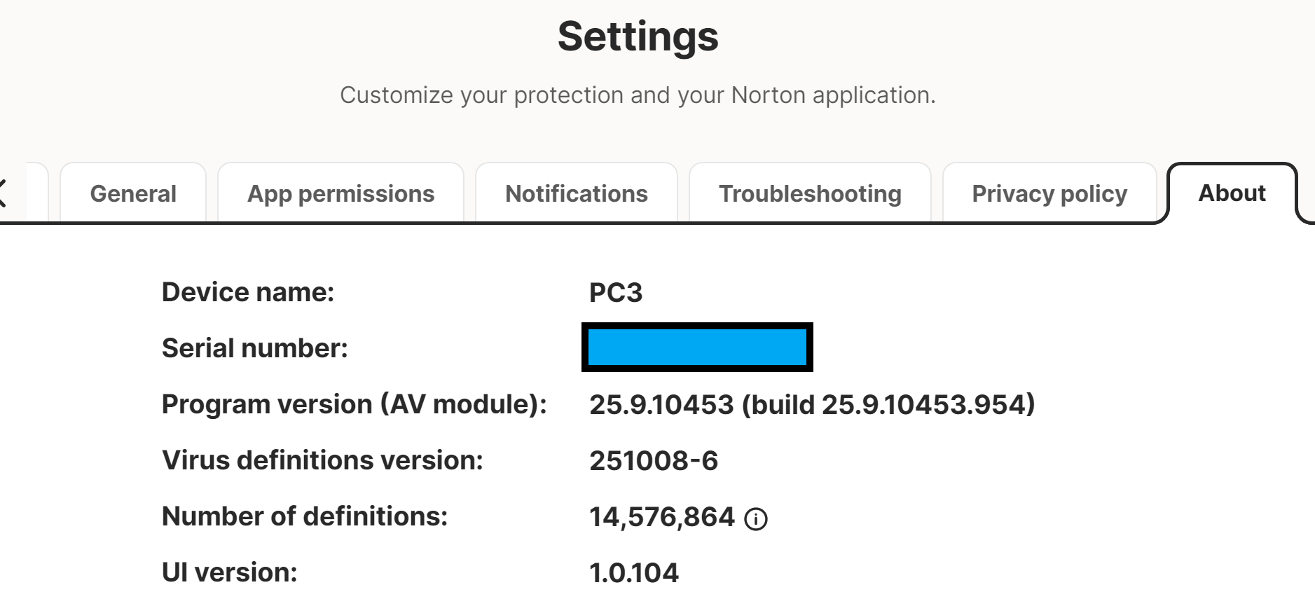

An update since norton has not solved this problem. [I have recently been updated 25.9.10453 (build 25.9.10453.954)]

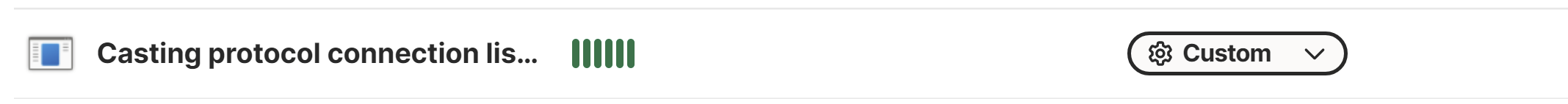

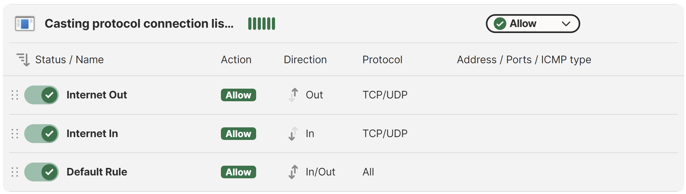

After unsuccessfully attempting to screen cast to my smart TV, I attempted to modify the norton Program Control entry for “Casting protocol connection listener”. norton would absolutely refuse to save my multiple attempted edits, and the time it did accept it, a moment later the program without my input changed to “Custom” and erased my inputs. Mumbled profanity. norton will not even allow a user to try and help themself while the “Kremlin” sits on their hands. As I watch the norton Program Control it just rolls through all the rules systematically alternating various rules from “Allow” to “Custom” and back to “Allow”, negating any user input and possibly even negating settings for rules that formerly had allowed various programs to function properly. Like screen cast used to work on my W11 laptop before recent updates.
With no input from me:
And back again, with no input from me:

When I again tried to edit the norton Program Control entry for “Casting protocol connection listener”, norton would absolutely refuse to save my multiple attempted edits and a moment later the program without my input changed to “Custom” and erased my inputs. Doesn’t seem like a user can fix norton even if they might know how.

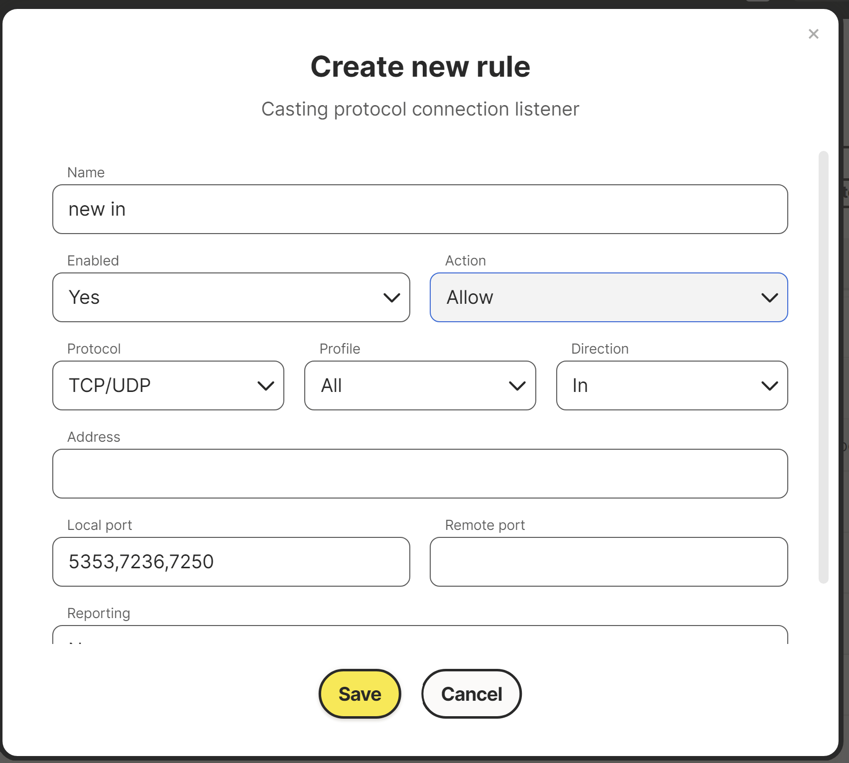

SA, saw your new rule suggestion on the citrix thread, thought I would try that. Unfortunately norton is blocking this at well. As soon as I hit Save the ports disappear, and then the Access button rolls to custom, and when Allow is selected the new rule has entirely disappeared. norton is not allowing me any changes.

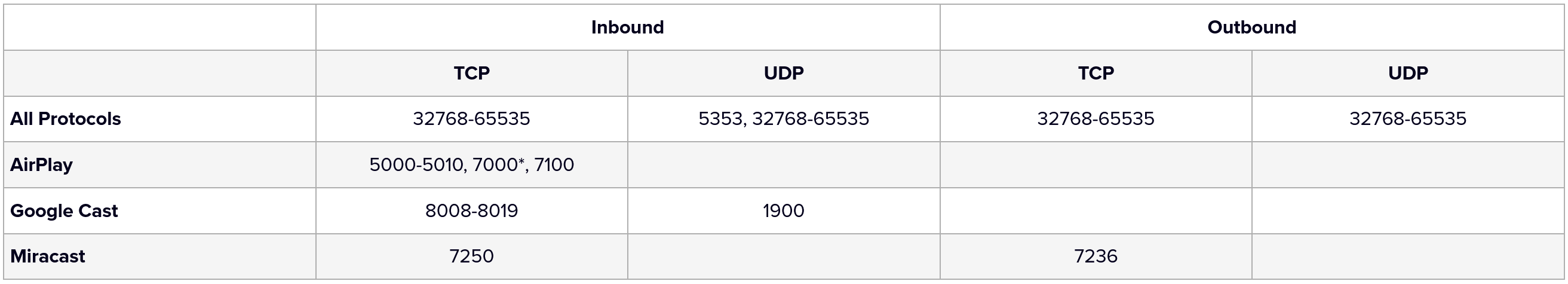

I came across a table that I have been working on verifying. What I like about it is it presents data in a format that is easier for me to assimilate, but it is from a page that doesn’t have any Citations. I’m going to try and verify the parts that pertain to Miracast, as that is what I believe Windows 11 (and 10) are using (and norton is abusing). Not going to worry about Air Play or Google Cast, but the table illustrates how AI can hoover up data that doesn’t really pertain to the input search question.

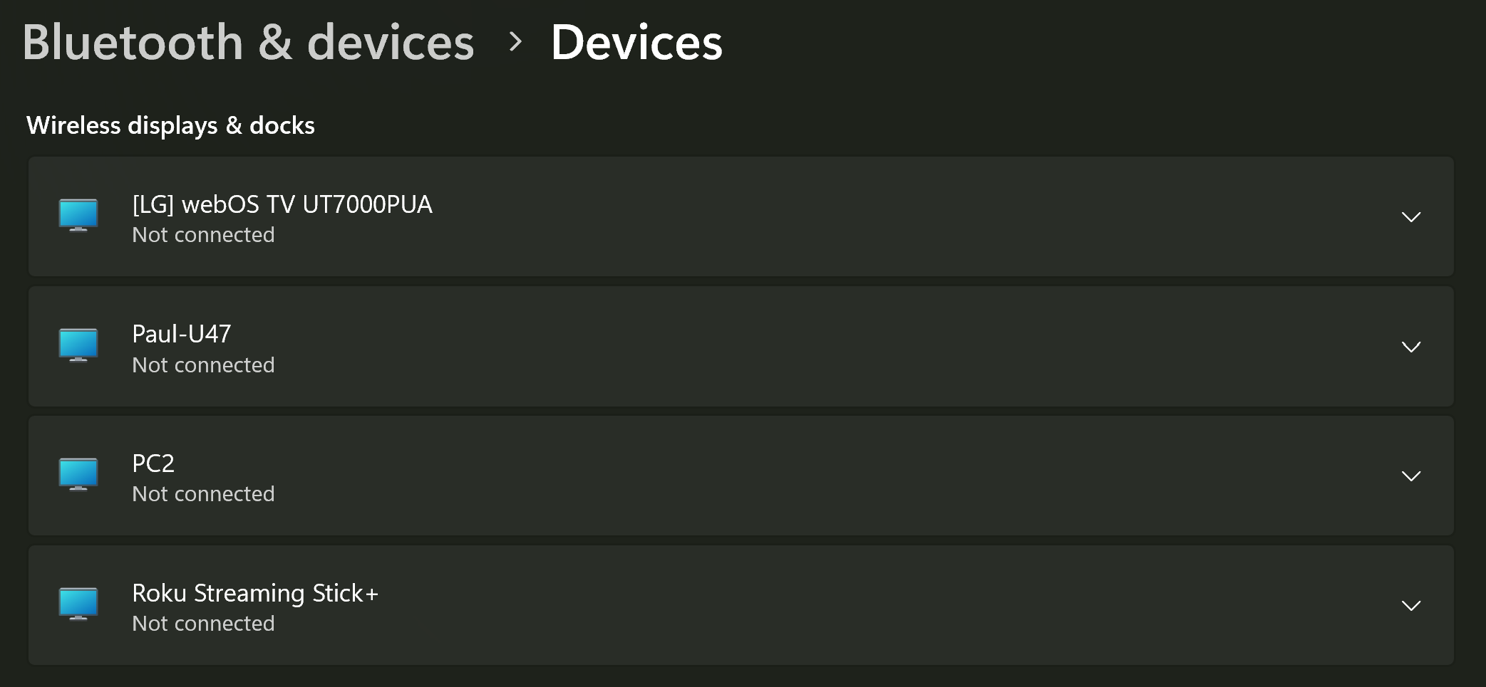

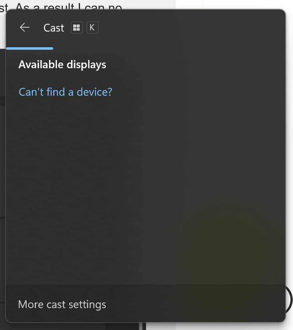

OK, a visual of the manner in which norton has broken W11 Miracast device discovery.
W11 Settings → Bluetooth & Devices → Devices → scroll to Wireless displays & docks.
In the image below you can see my LG smart TV, my Roku, and my two other laptops,
all 4 devices I have successfully screen cast to prior to a 2025 norton version update.
When I press the Windows key “ + K” combination right after startup and before norton finishes loading I can see my both my LG smart TV and my Roku listed as as Available displays on the Cast fly-out. After norton finishes loading when I press the Windows key “ + K” combination we can see that norton has inhibited wireless display discovery in the image below.
Got my device discovery back. Went to Intel support and downloaded the latest driver for my network adapter. Now I can again select my TV or Roku, but still cannot screen cast to them unless I turn off norton firewall.
