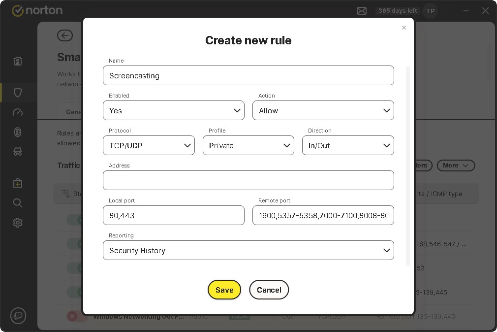

Do we have to create a new rule for all these? Crazy.
Screencasting uses various ports depending on the protocol, but common ports include TCP/UDP 1900 for discovery (SSDP/mDNS), TCP 80 (HTTP) and 443 (HTTPS) for initial communication, and a range of ports for data streaming like TCP 7000-7100 (AirPlay) or TCP 8008-8009 (Google Cast). Miracast uses TCP 5357 and 5358 for discovery and can use high-numbered UDP ports for the stream.
Hello SA. When I first noticed Screen Cast was no longer working for me, I thought if I researched and applied my findings I could get Screen Cast working again. Since I don’t currently use AirPlay or Google Cast, I only worried about Miracast. As you correctly mention, Miracast uses a few different ports for discovery, control, and a broad range of higher ports for the streaming of the display. I tried all of them in the user available inputs to the norton firewall. Most often the norton software would erase my inputs before I could finish my list of changes. A hamster wheel of norton induced malfunction.

If you can create a NEW firewall rule that looks like this one, just add your addresses and save then test.
Hello SA. I’ve already tried this, although I left out port 1900 as that is only for Google Cast. Also left out ports for AirPlay, as I don’t use that either. Sticking to miracast ports in an effort to keep it simple. Anyway, my efforts to correct the firewall did not work for me. Like you, my W10 machine can screen cast with the firewall on.
