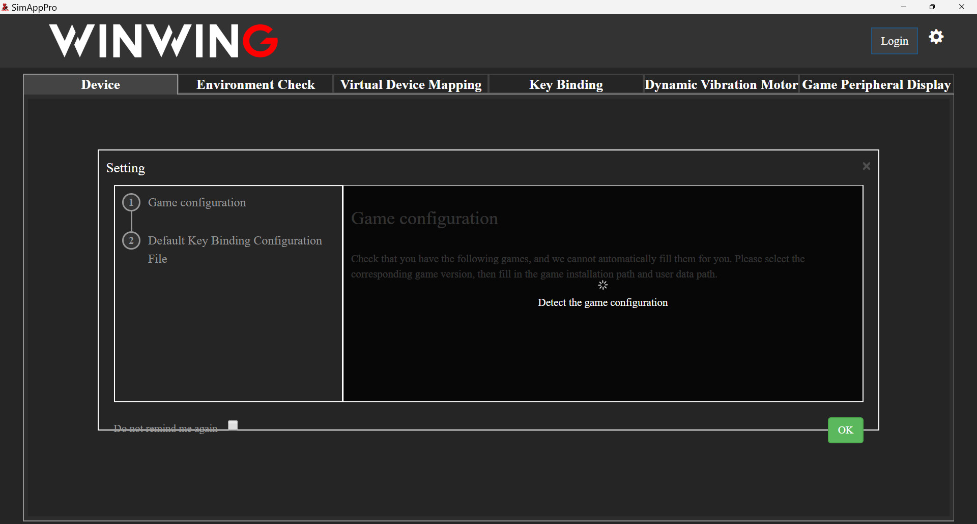

SimAppPro Simlogic.Exe

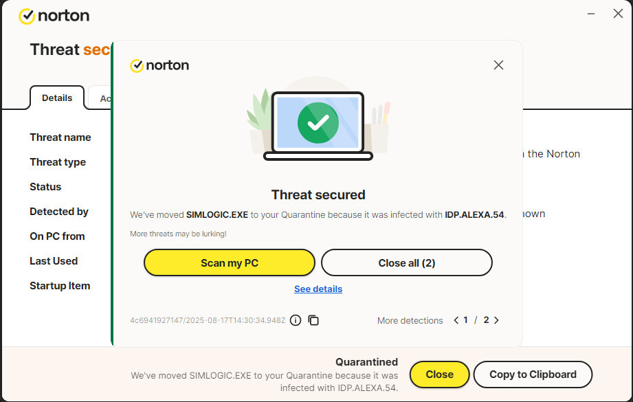

I use Flightsim Hardware from a company called WinWing and Norton is blocking Simlogic.exe and I am unable to use my hardware ! I have placed in exceptions SimAppPro and Norton is still querying the app.
Currently I have uninstalled Norton which I’m unhappy about after recently renewing my subscription
Anybody experiencing this ? Any Solutions ? I’m baffled because Winwing is a big company and expanding ! So why is Norton blocking a safe reliable app ?
I’ve only recently experienced this problem after Windows upgraded my pc to Windows 11
Thanks
Lee

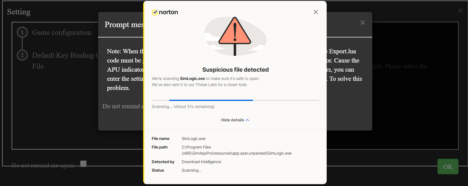

Is this your SimAppPro?
https://us.winwingsim.com/view/simapppro.html

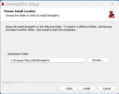

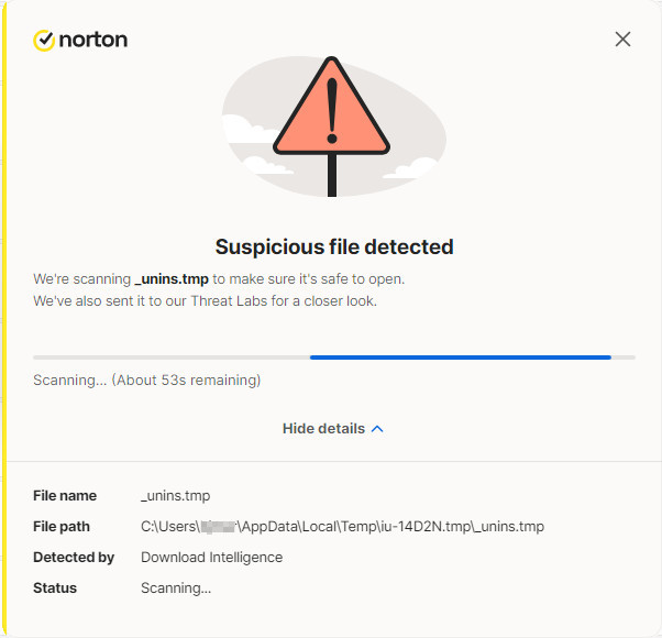

fwiw ~ as test:

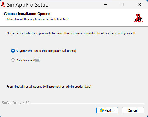

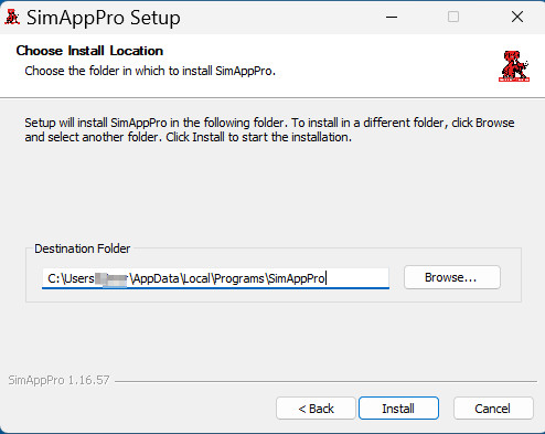

Did you want install for Anyone (all users)?
Anyone = Program Files
Only for = AppData

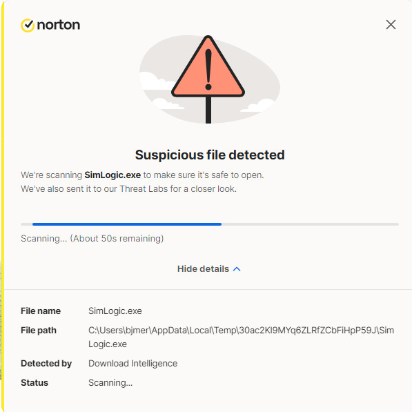

fwiw ~ as test: Anyone

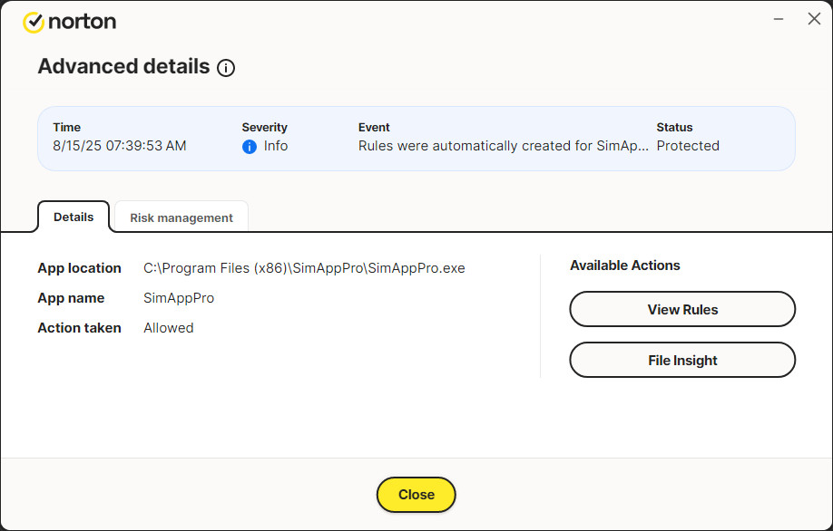

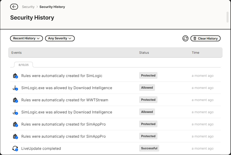

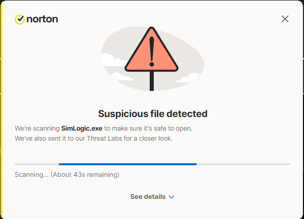

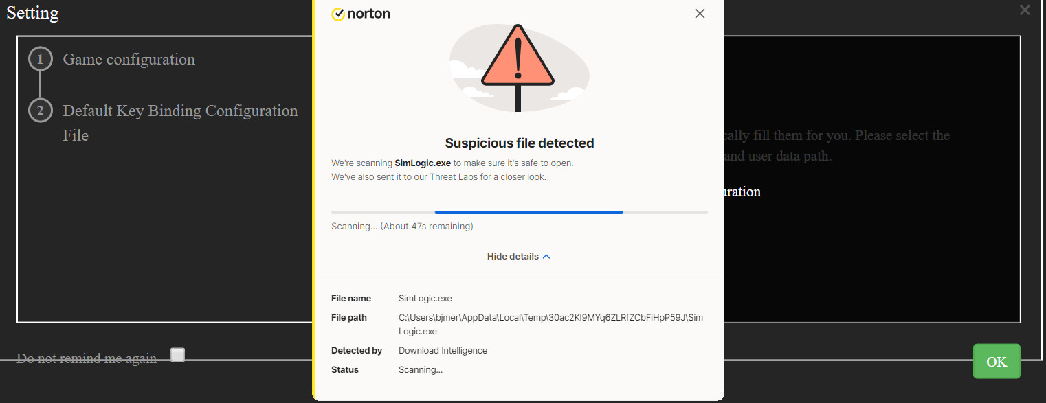

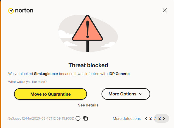

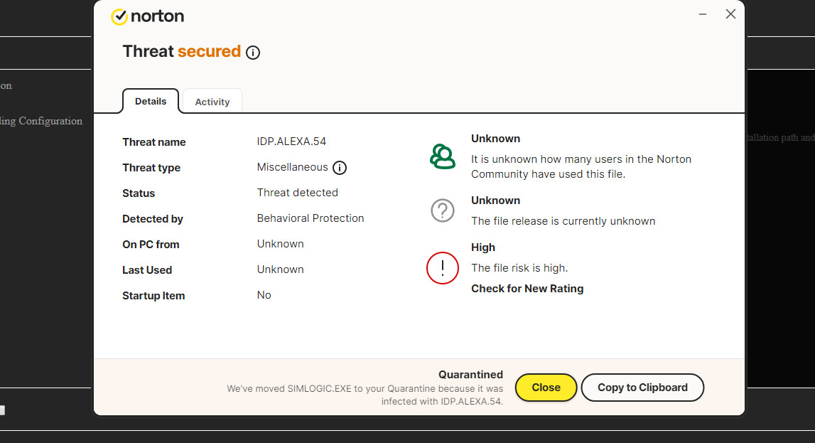

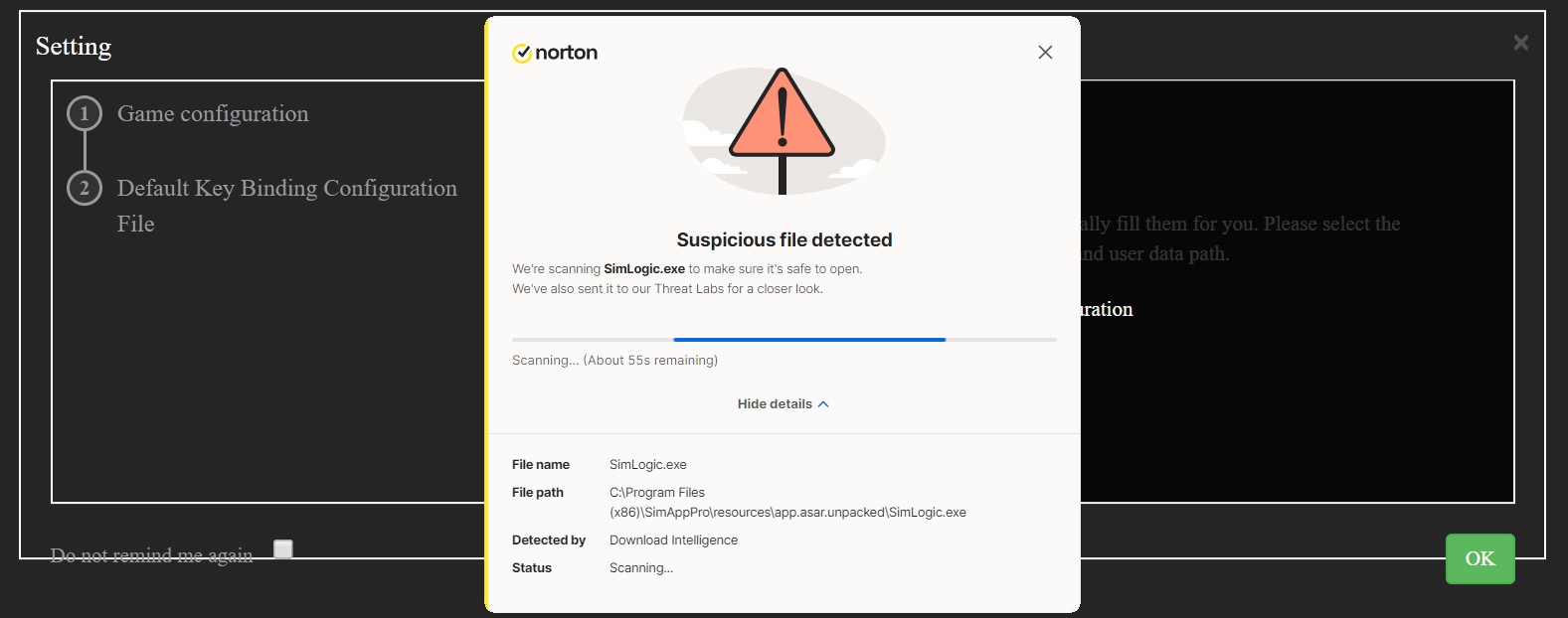

appears Norton is chewing on SimLogic.exe.
appears Download Intelligence completed chewing on SimLogic.exe.
appears rules were created and SimLogic.exe was Allowed…while Unproven
for example:
Caveat: I’m not familiar with SimAppPro nor have Login credentials
appears on subsequent launch → Norton is still chewing

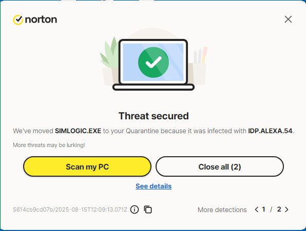

5614cb9cd07b/2025-08-15T12:09:13.071Z
5e3aaed1244e/2025-08-15T12:09:15.903Z

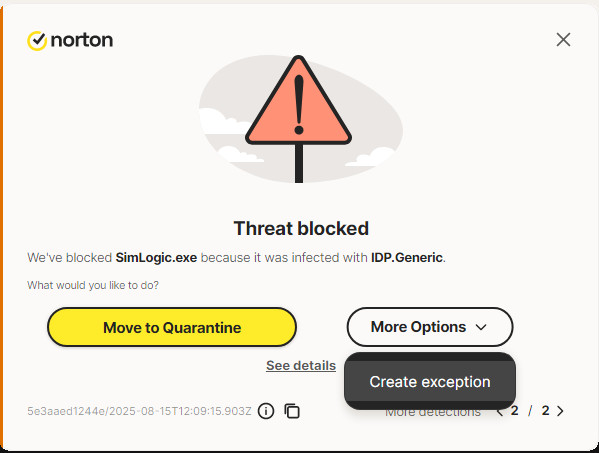

Details

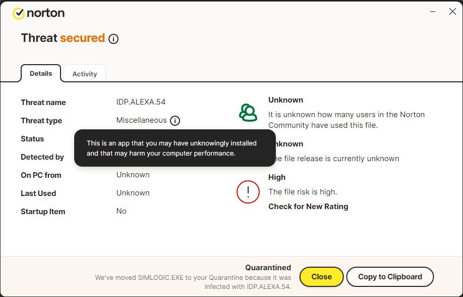

Threat name: IDP.ALEXA.54
Threat type: Miscellaneous - This is an app that you may have unknowingly installed and that may harm your computer performance.
Status: Threat detected
Detected by: Behavioral Protection
On PC from: Unknown
Last Used: Unknown
Startup Item: No
Unknown
It is unknown how many users in the Norton Community have used this file.
Unknown
The file release is currently unknown
High
The file risk is high.

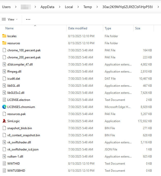

Activity
Path | Type | Status

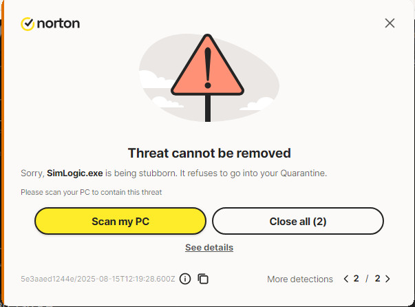

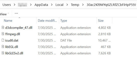

C:\USERS\user\APPDATA\LOCAL\TEMP\30AC2KL9MYQ6ZLRFZCBFIHPP59J\SIMLOGIC.EXE | File | Deleted
C:\Users\user\AppData\Local\Temp\2b4fc714-1a8d-4daa-9914-67aaf0927b7b.tmp.node | File | Deleted

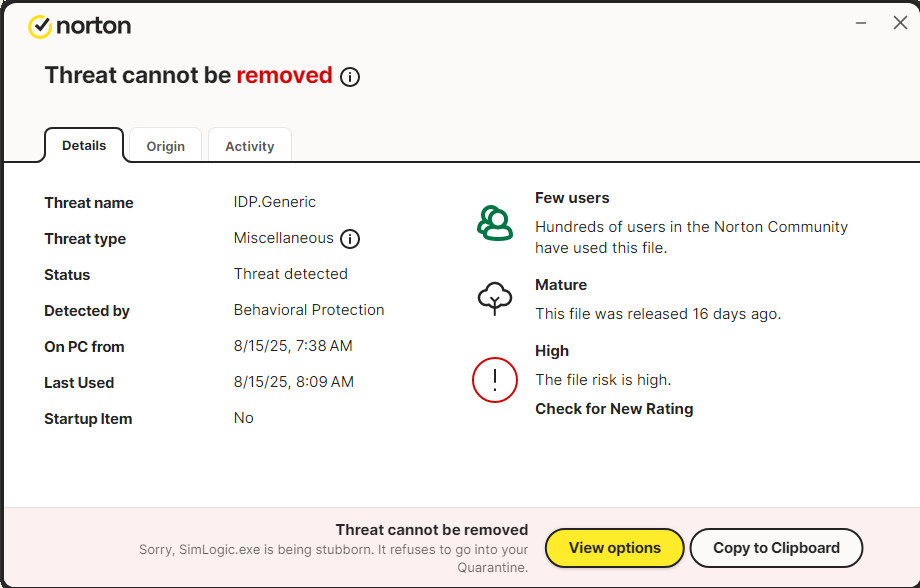

5e3aaed1244e/2025-08-15T12:19:28.600Z

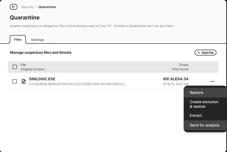

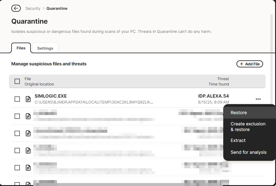

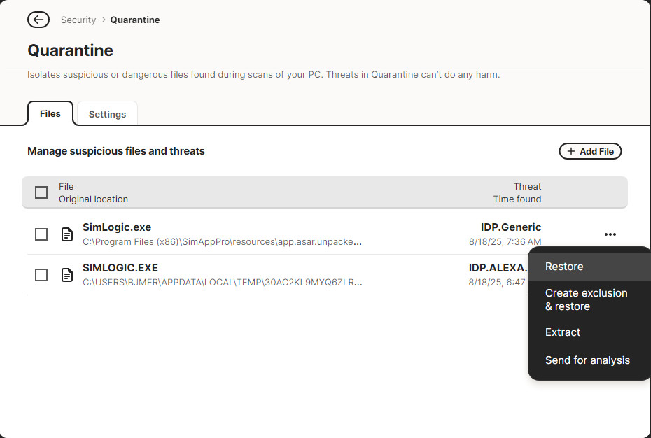

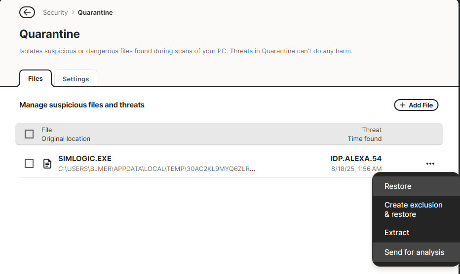

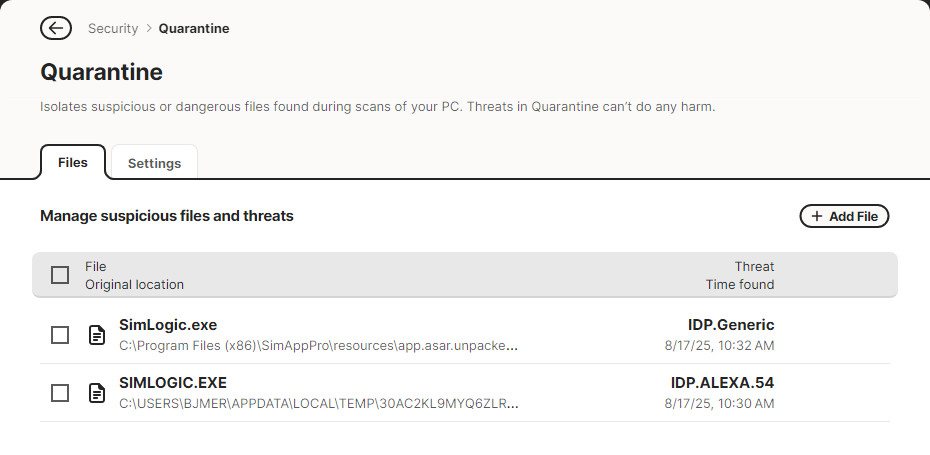

Threat cannot be removed
Sorry, SimLogic.exe is being stubborn, It refuses to go into your
Quarantine.

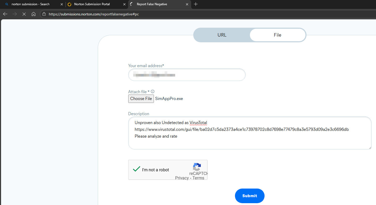

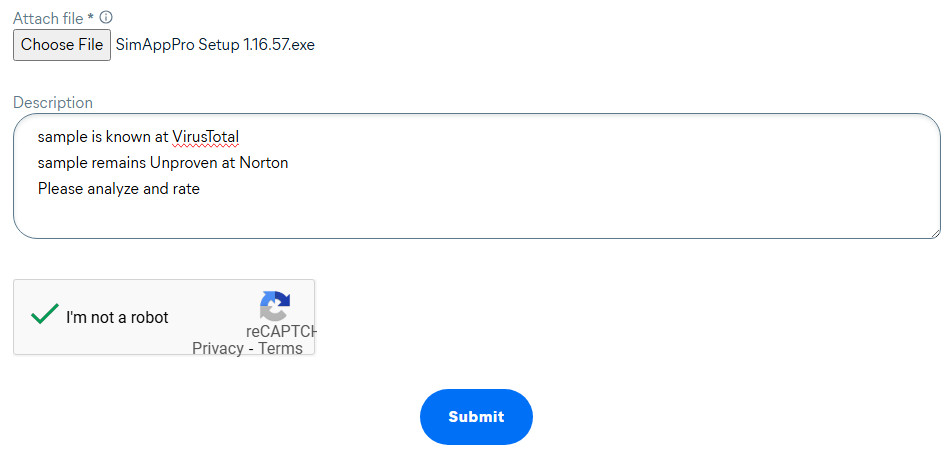

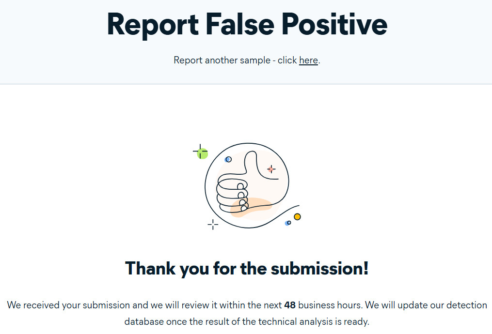

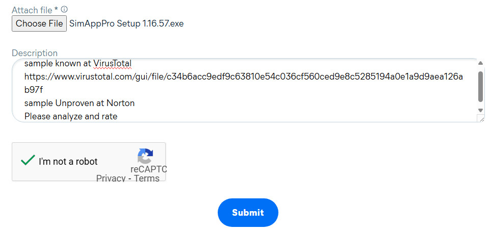

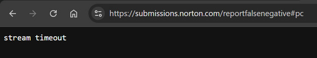

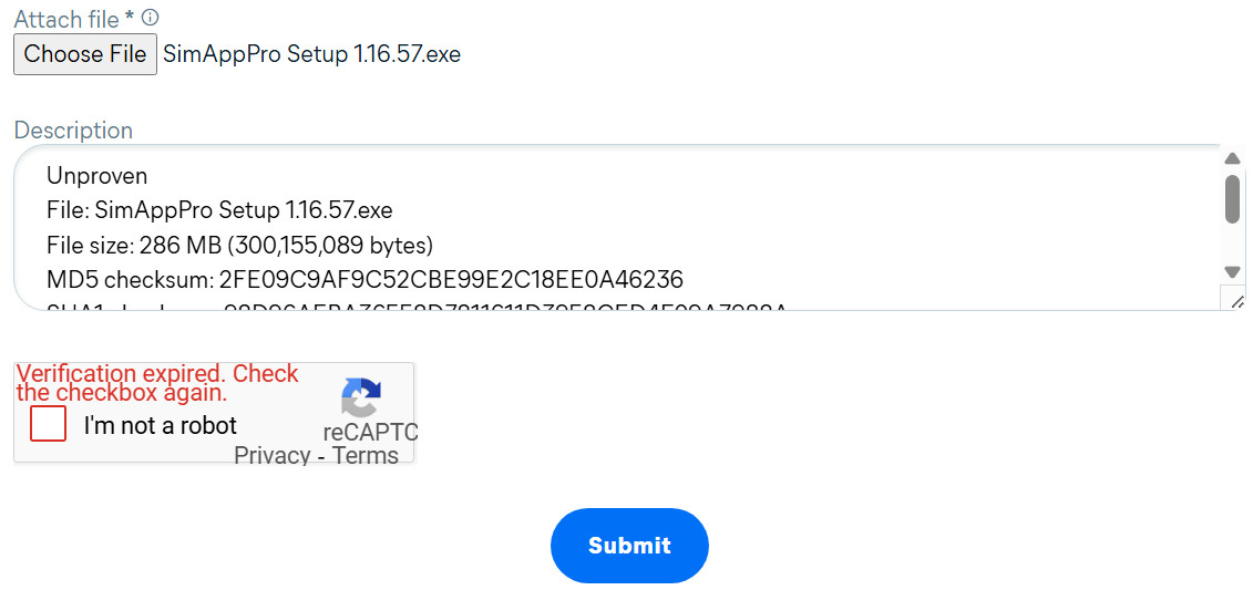

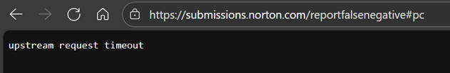

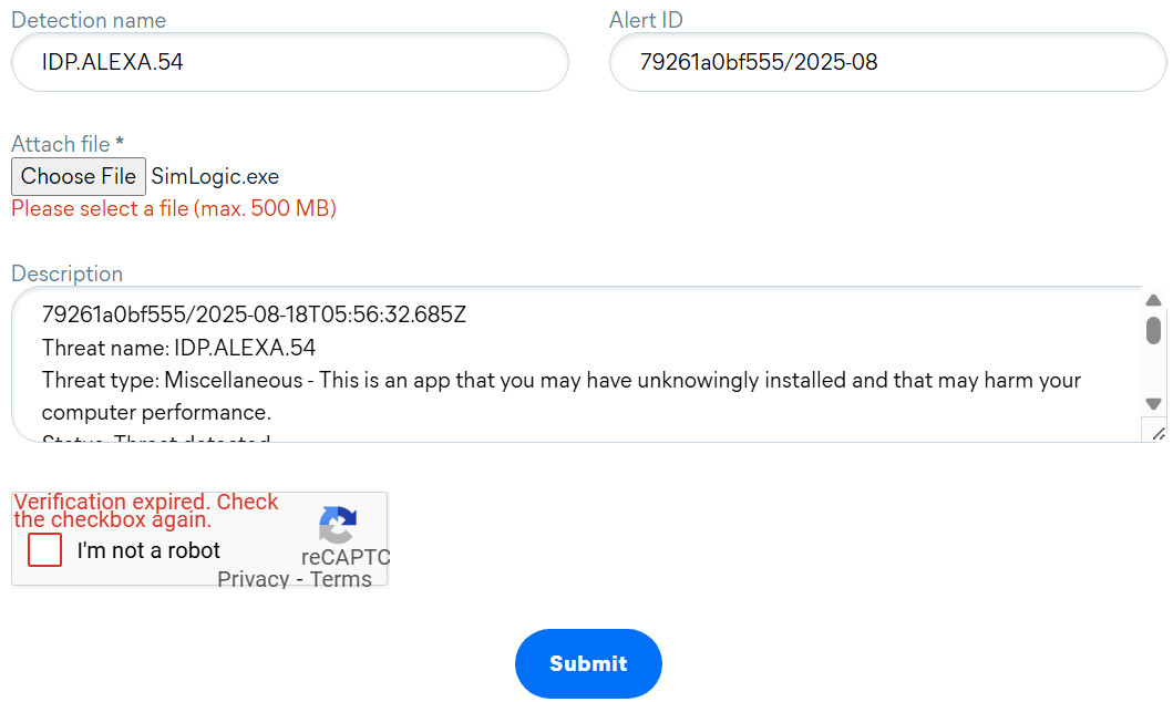

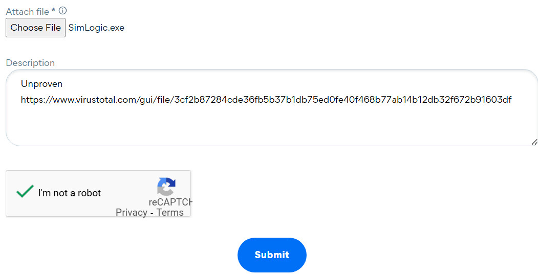

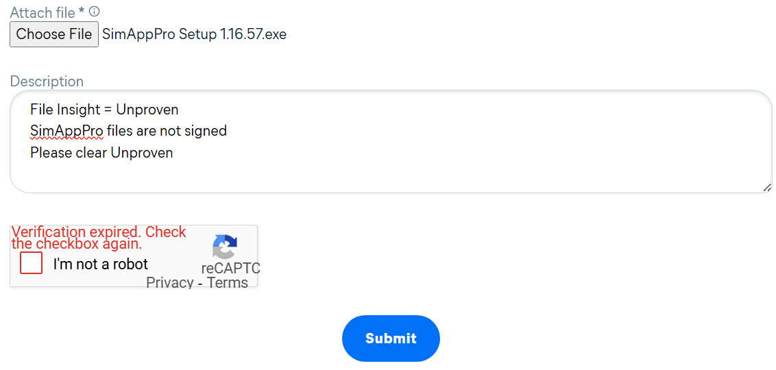

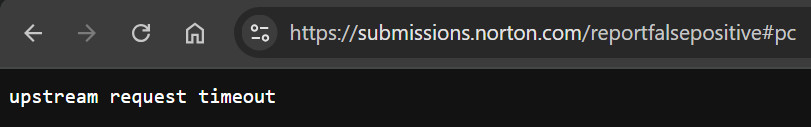

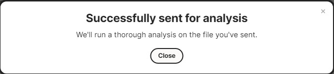

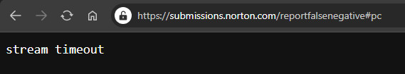

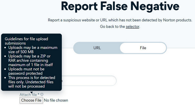

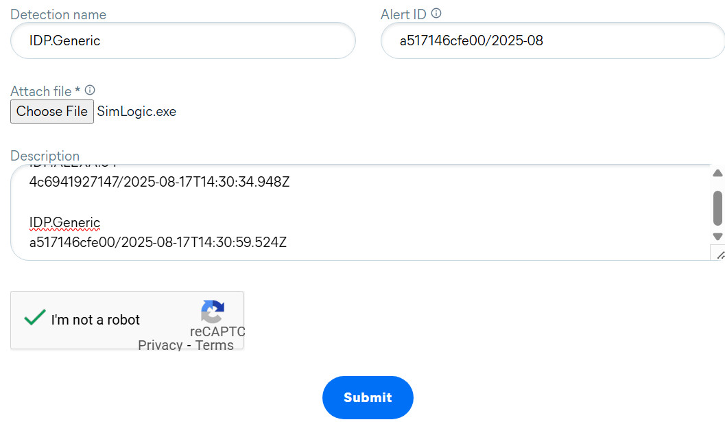

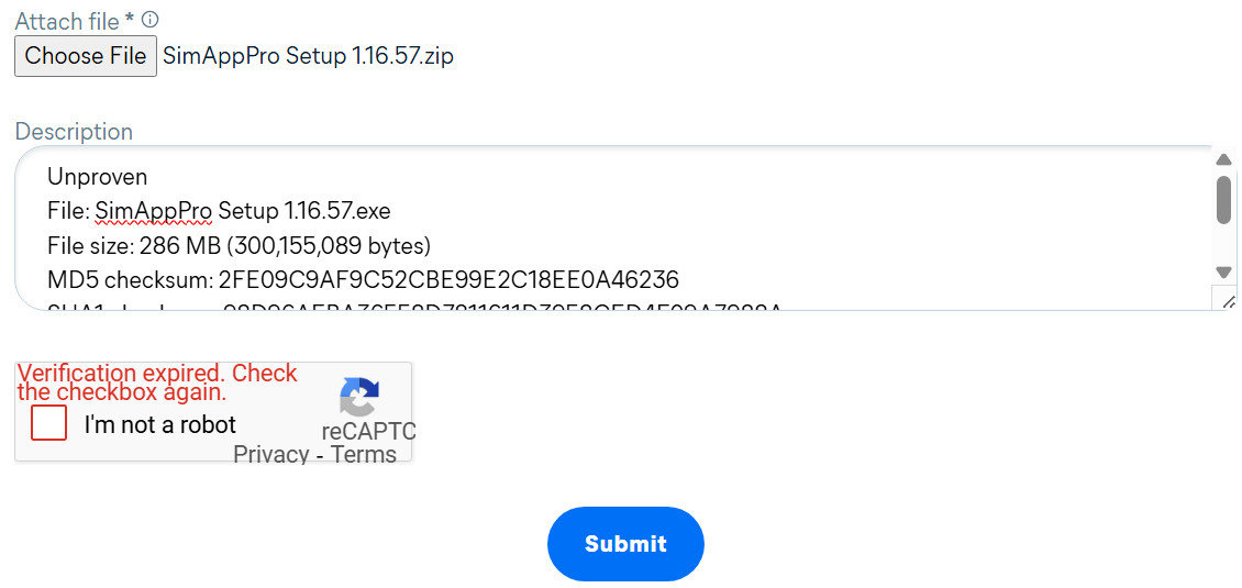

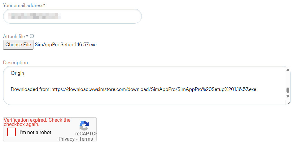

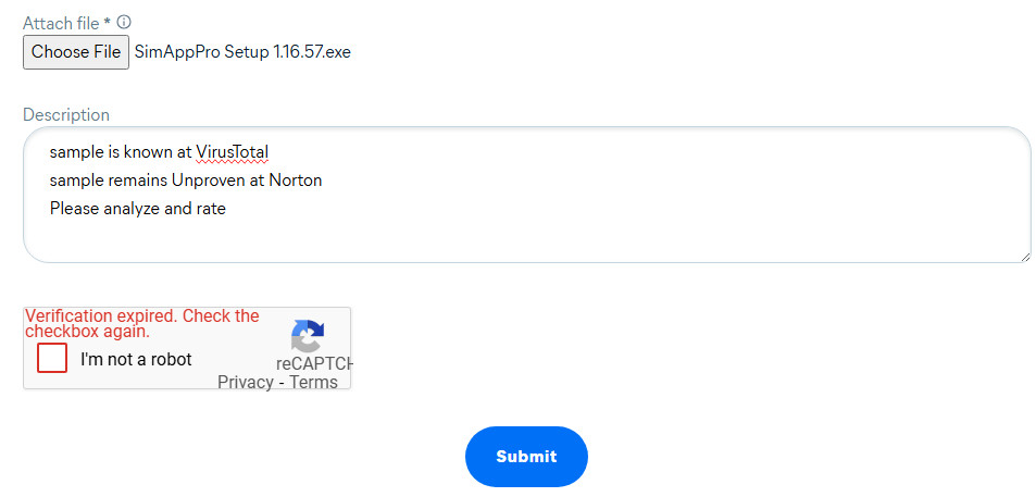

fwiw ~ trying to make False Negative submission…no joy at this time.
Maybe, sample is unknown at VirusTotal.
Maybe, Norton submission process remains hinky.
stay tuned
appears SimAppPro Setup sample is known at VirusTotal here
So, we’ll try submission/s again
stay tuned

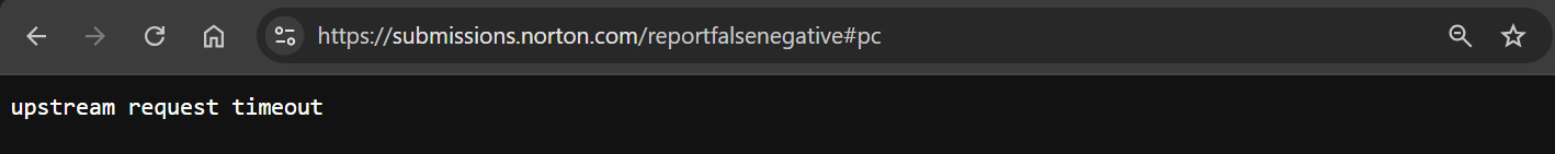

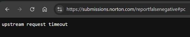

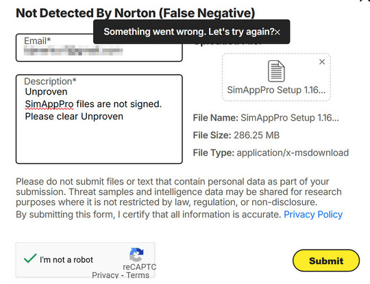

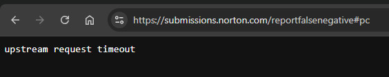

Well, appears Norton False Negative submission process remains hinky = times out.
1994
appears SimAppPro is known at VirusTotal here
I’ve experienced similar before…and needed to open support ticket.
Oh bother…

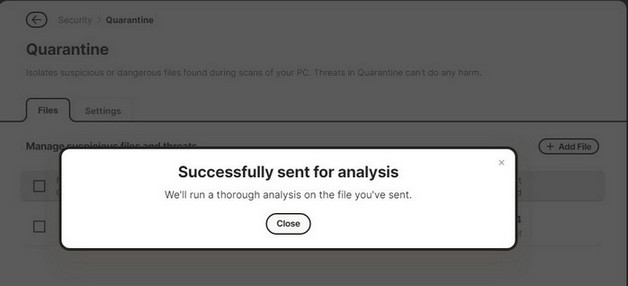

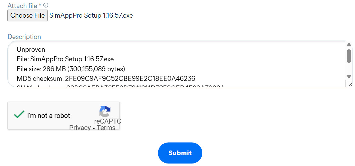

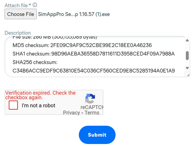

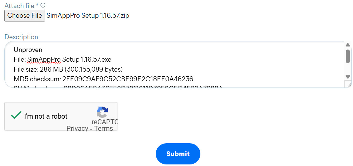

trying Setup sample again

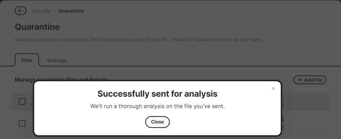

trying Setup submission again from Norton Private Browser with Shields and Extensions = off
Edit:

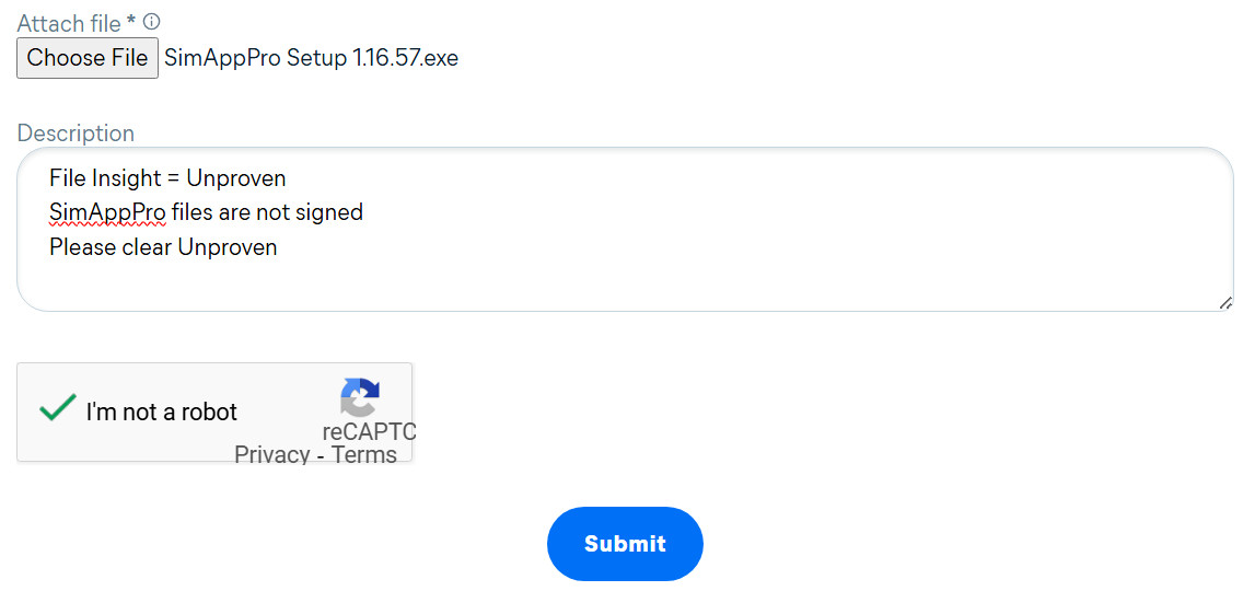

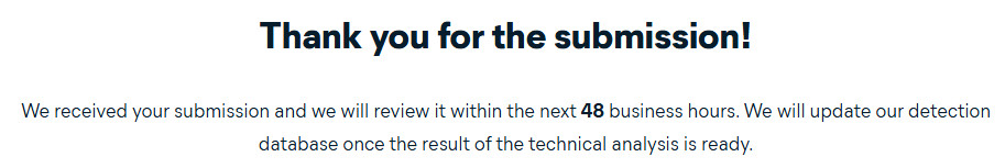

Send for analysis

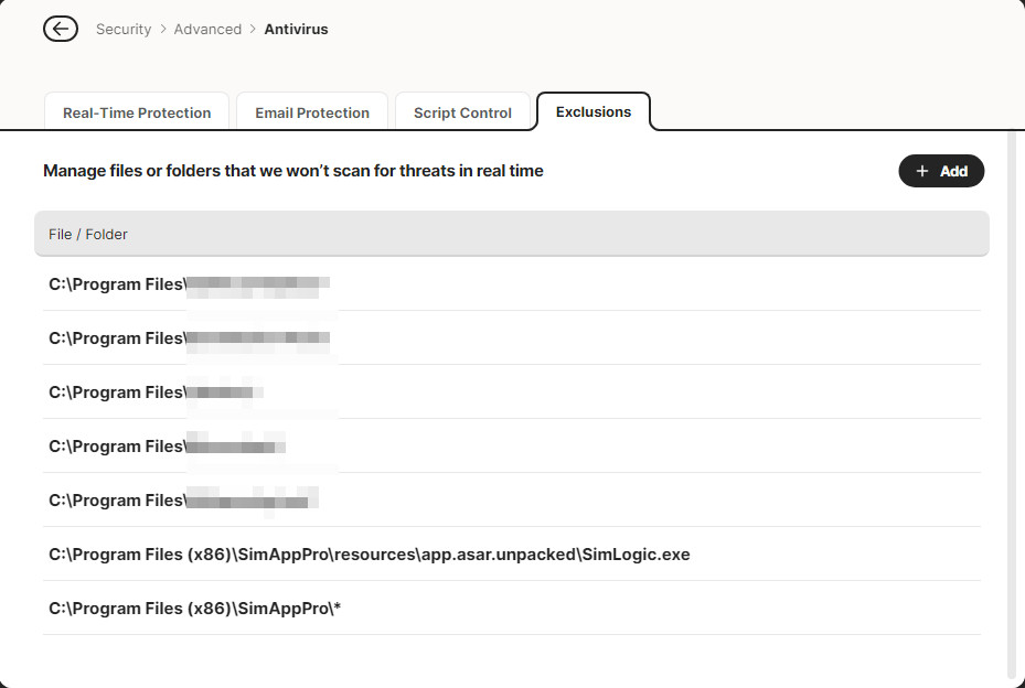

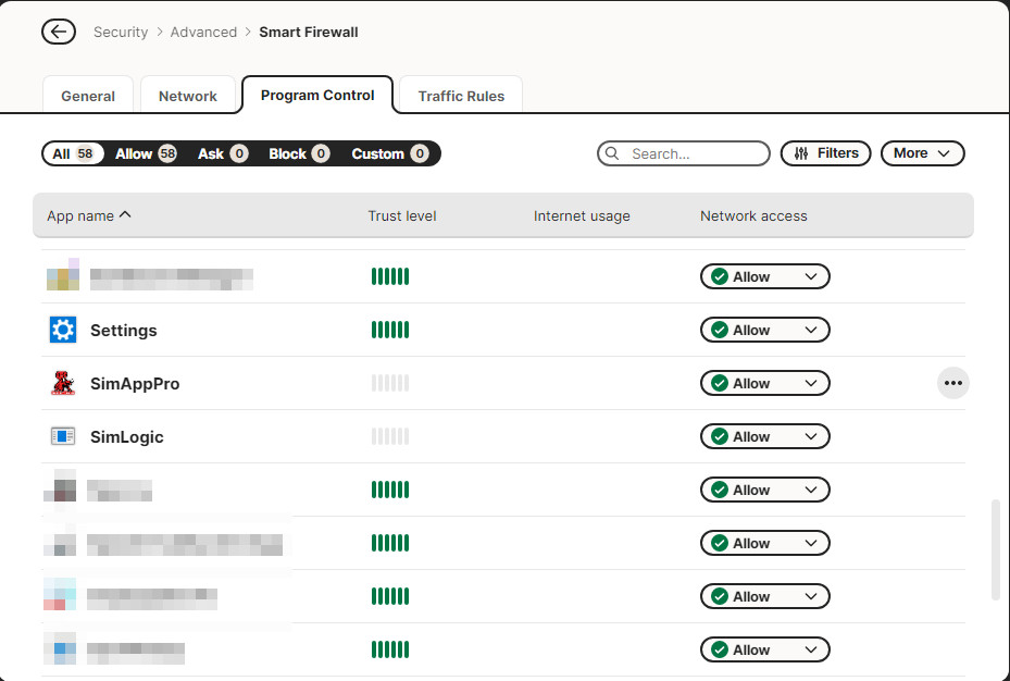

maybe, I’ll try adding Exclusions
maybe, I’ll try False Negative submission/s again.

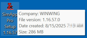

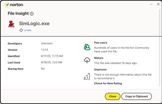

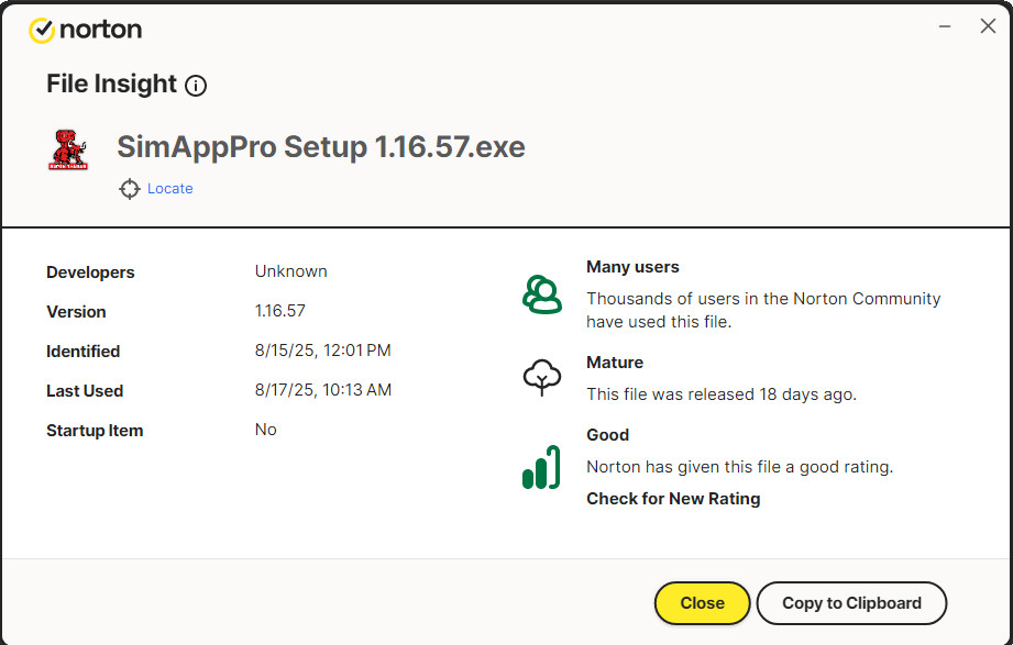

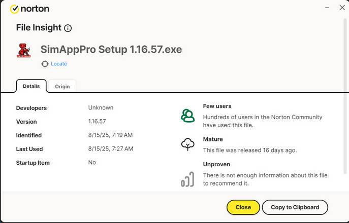

Edit: fresh Setup sample + Edge → Reset to Default w Extensions off

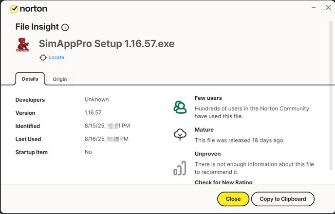

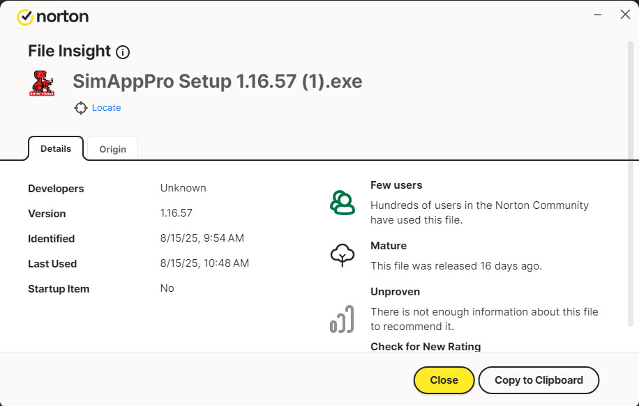

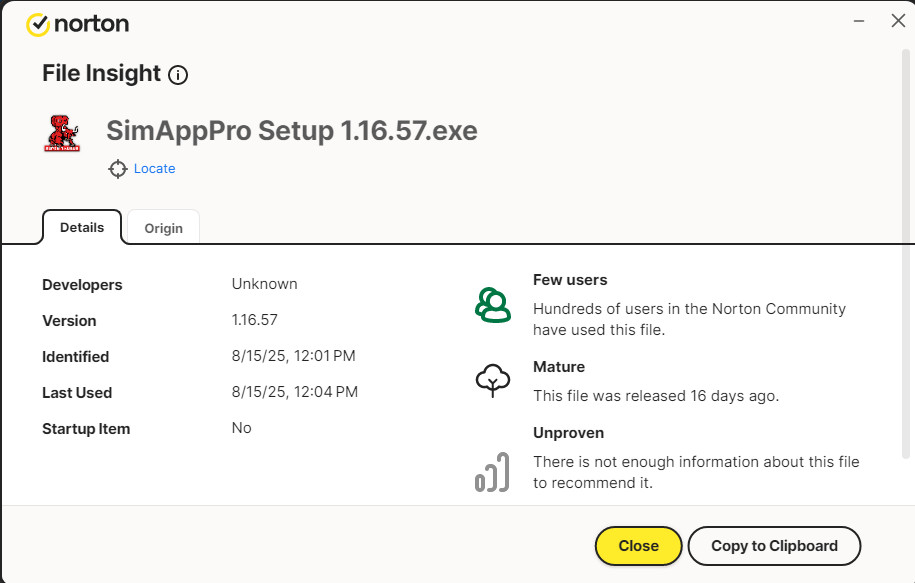

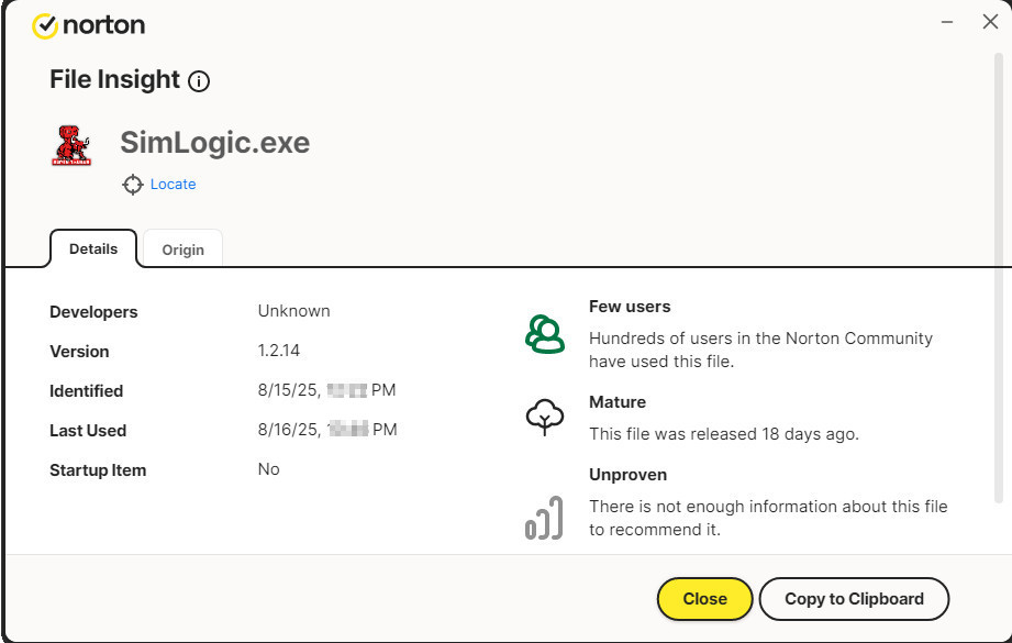

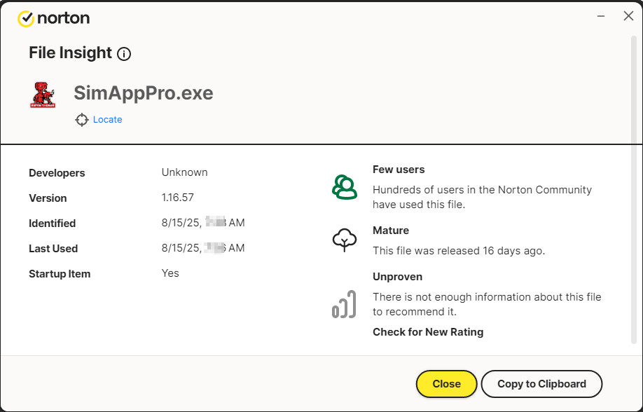

Unproven - released 16 days ago
Details
Developers: Unknown

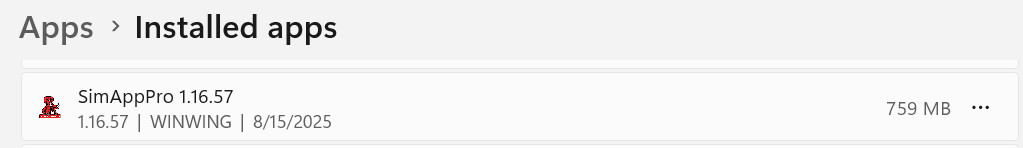

Version: 1.16.57
Identified: 8/15/25,
Last Used: 8/15/25,
Startup Item: No
Few users
Hundreds of users in the Norton Community have used this file.
Mature
This file was released 16 days ago.
Unproven
There is not enough information about this file to recommend it.

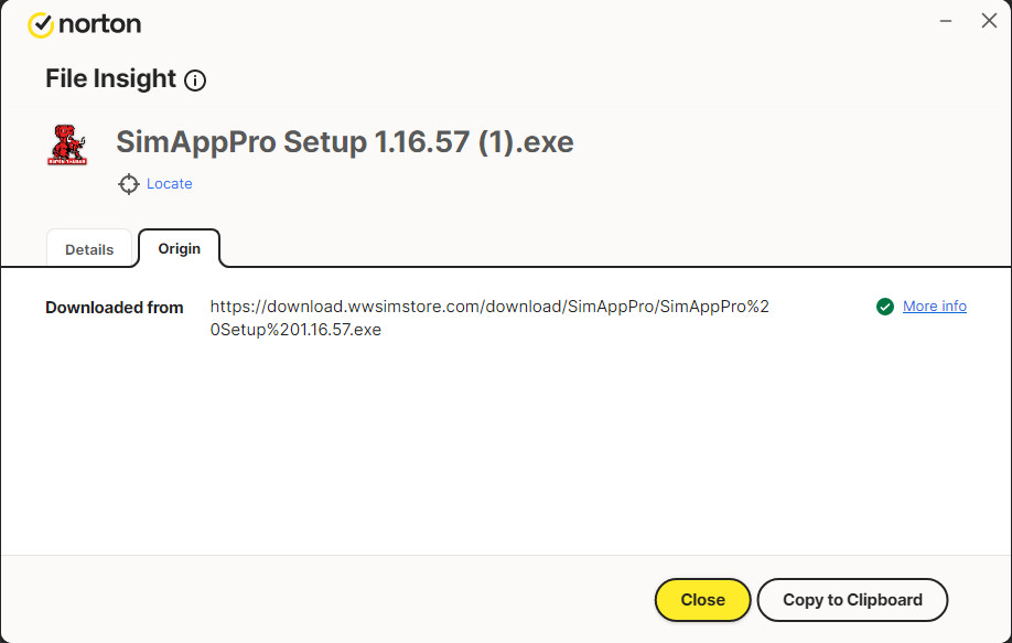

Origin
Downloaded from: https://download.wwsimstore.com/download/SimAppPro/SimAppPro%20Setup%201.16.57.exe
File: SimAppPro Setup 1.16.57 (1).exe
File size: 286 MB (300,155,089 bytes)
MD5 checksum: 2FE09C9AF9C52CBE99E2C18EE0A46236
SHA1 checksum: 98D96AEBA36558D7811611D3958CED4F09A7988A
SHA256 checksum: C34B6ACC9EDF9C63810E54C036CF560CED9E8C5285194A0E1A9D9AEA126AB97F
Date/Time: 8/15/2025

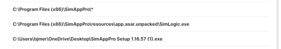

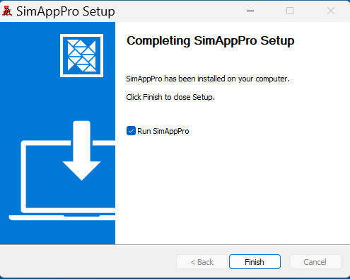

fwiw ~ at this time: Setup over-install

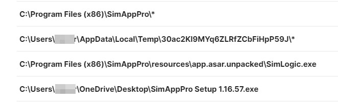

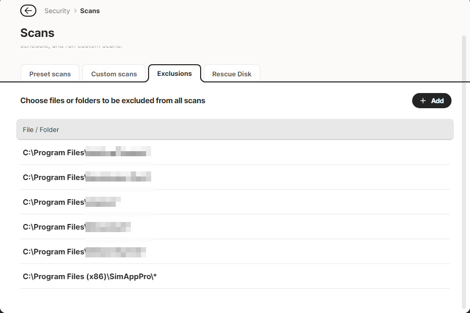

fwiw ~ as test:
fwiw ~ as test: with Exclusions

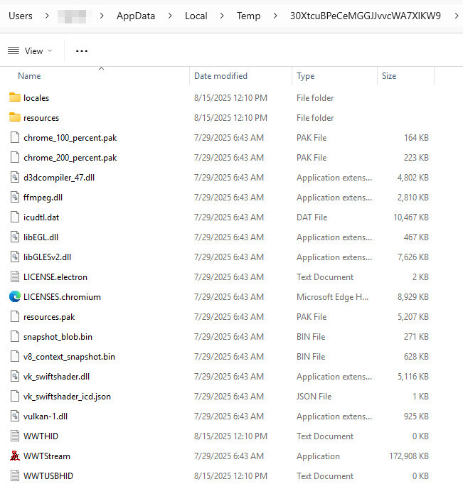

related Temp files
fwiw ~ that’s about as far as I can go with Antivirus and Scans → Exclusions.

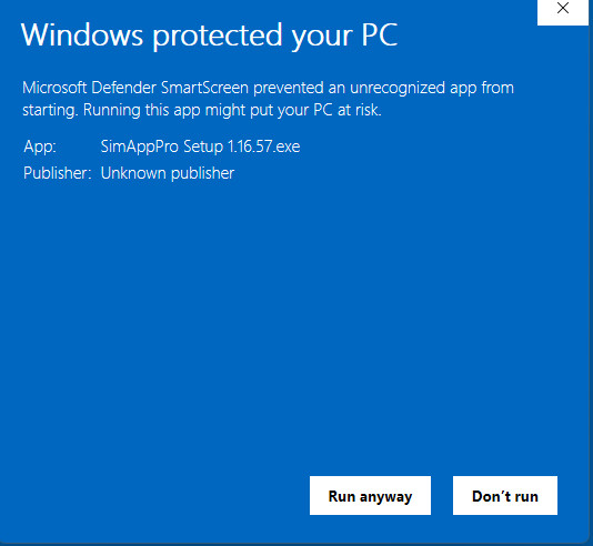

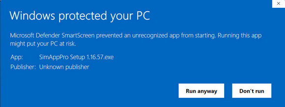

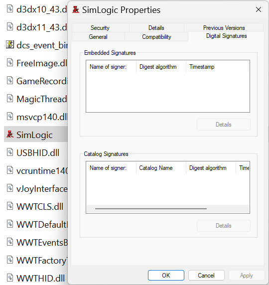

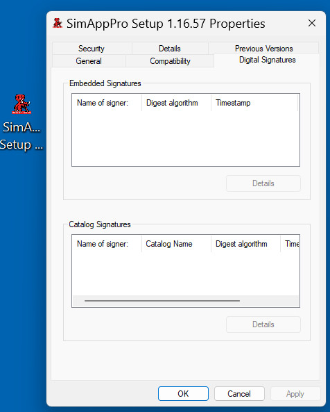

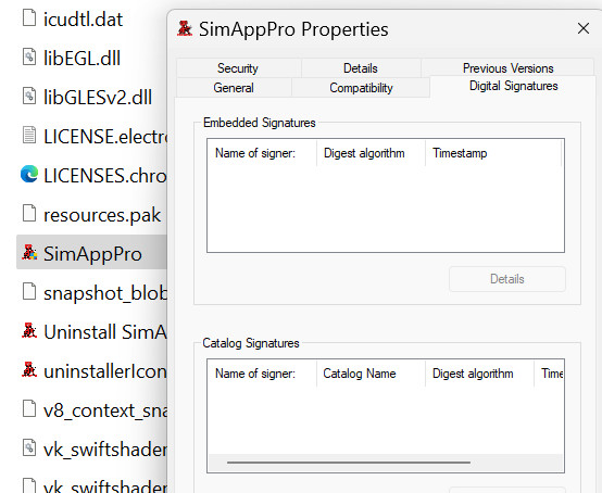

  • just noticed → SimAppPro files are not signed.
I had presumed us.winwingsim.com (big company and expanding) files were signed

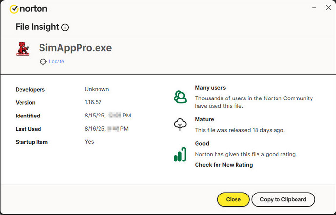

fwiw ~ I’m monitoring and waiting to hear back from my False Negative submission here &or from my Norton support Case ID nnnnnnnn here.
Note: at this time…
SimAppPro Setup → File Insight = Unproven
SimAppPro → File Insight = Unproven
I’m hoping once Norton clears Unproven rating…then Norton will not object to SimAppPro install/installed.
Note: SimAppPro files may need to be (should be) signed.

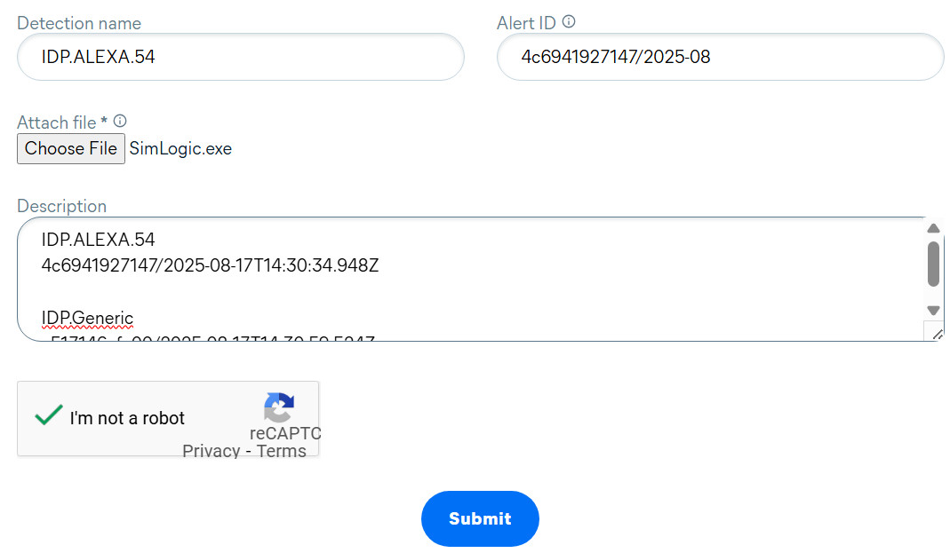

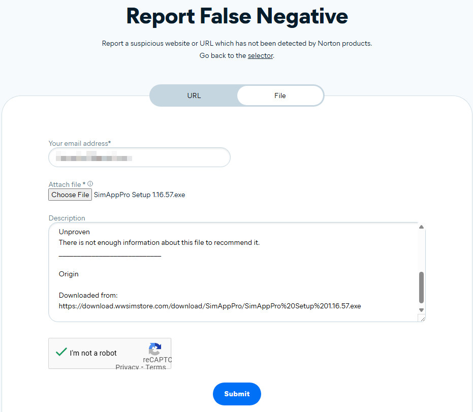

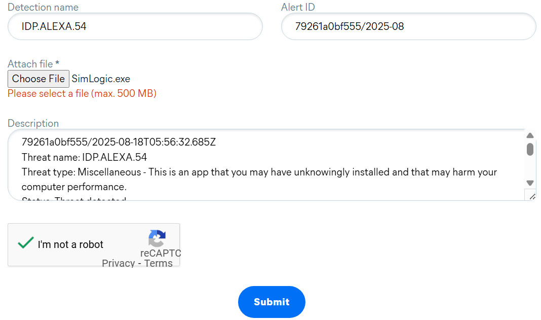

Note: at this time v24+ False Negative submission remains stubborn
@Gayathri_R , @MJay
Note: at this time v22 False Negative submission remains stubborn
@Gayathri_R , @MJay

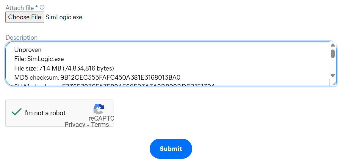

Chat support advised me to use False Negative for Unproven.
How may I submit False Negative for Unproven?

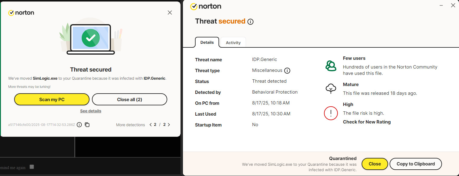

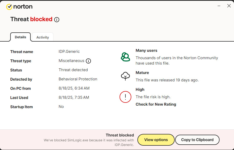

4c6941927147/2025-08-17T14:30:34.948Z
IDP.Generic
a517146cfe00/2025-08-17T14:30:59.524Z

79261a0bf555/2025-08-18T05:56:32.685Z

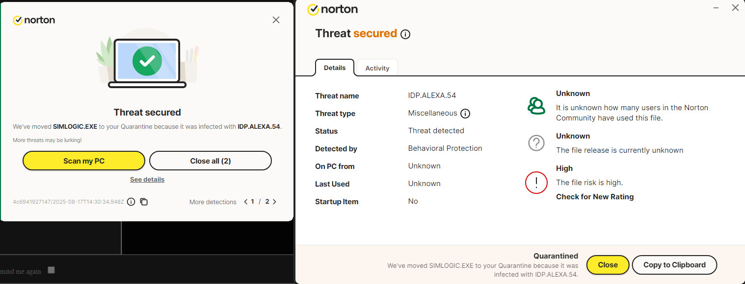

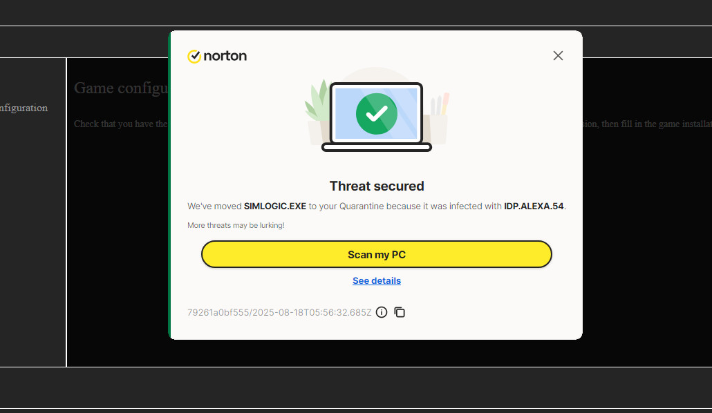

On PC from: Unknown
Last Used: Unknown
Startup Item: No
Unknown
Unknown
High
Activity
C:\USERS\USER\APPDATA\LOCAL\TEMP\30AC2KL9MYQ6ZLRFZCBFIHPP59J\SIMLOGIC.EXE | File | Deleted
C:\USERS\USER\APPDATA\LOCAL\TEMP\30AC2KL9MYQ6ZLRFZCBFIHPP59J\SIMLOGIC.EXE | Process | Terminated
C:\Users\user\AppData\Local\Temp\30ac2Kl9MYq6ZLRfZCbFiHpP59J\SimLogic.exe | Process | Terminated
C:\USERS\USER\APPDATA\LOCAL\TEMP\NSW9949.TMP\7Z-OUT\SIMLOGIC.EXE | File | Deleted
C:\Users\user\AppData\Local\Temp\7e20c1ae-c31c-4d8c-9550-455bb5414dd9.tmp.node | File | Deleted
C:\Users\user\AppData\Local\Temp\af61a2ea-972e-4f46-b3e9-011a3b318eb9.tmp.node | File | Deleted
C:\Users\user\AppData\Local\Temp\ba5ca2da-afaf-4fe0-b651-d1b8bbb8cf31.tmp.node | File | Deleted
C:\Users\user\AppData\Local\Temp\ae0f0fc9-446b-4f1b-8eb9-14912da1460d.tmp.node | File | Deleted
C:\Users\user\AppData\Local\Temp\c9a1b82e-34ef-474e-a896-a97d654aeb66.tmp.node | File | Deleted
C:\Users\user\AppData\Local\Temp\146e1e64-8fe4-45eb-b81e-57559463db7f.tmp.node | File | Deleted
C:\Users\user\AppData\Local\Temp\c210e68c-a046-4b43-83d6-a984740f5721.tmp.node | File | Deleted

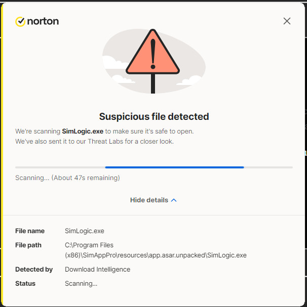

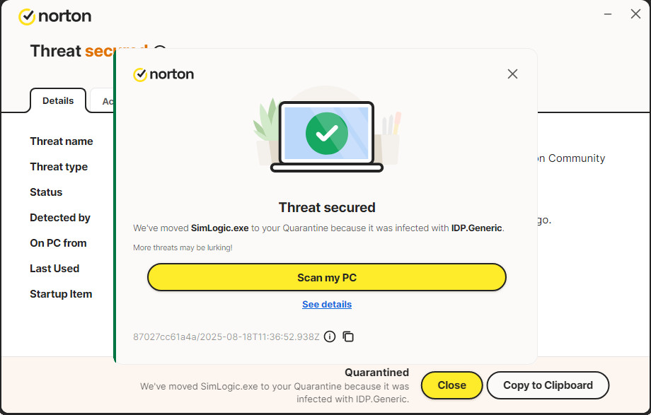

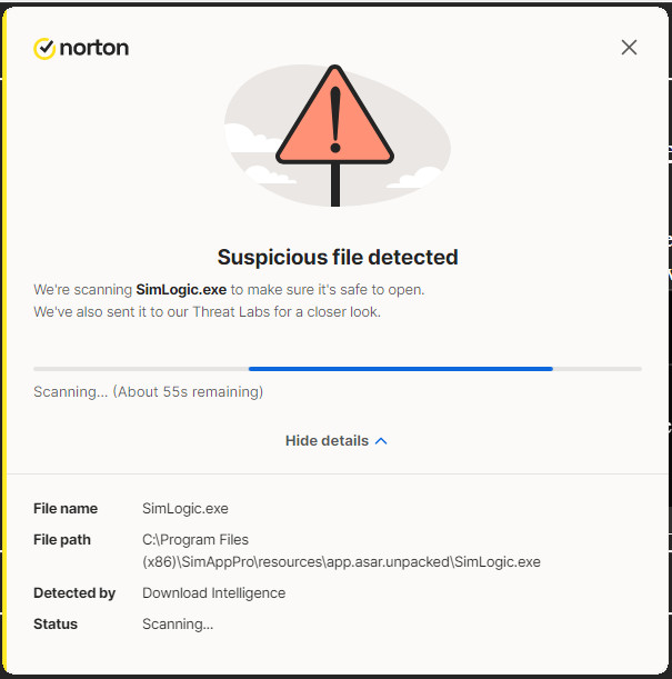

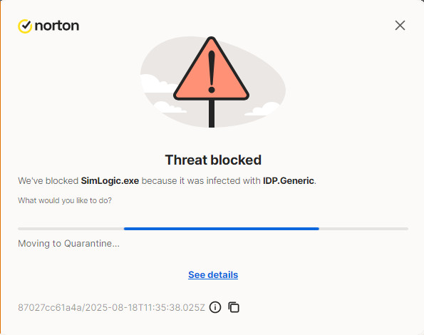

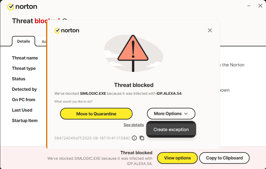

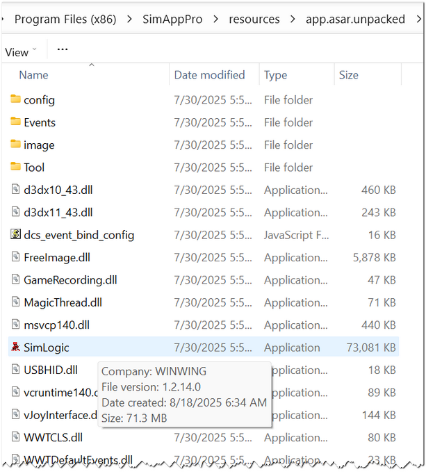

SimAppPro shortcut call … causes Norton to chew on \app.asar.unpacked\SimLogic.exe and what appears to be related temp files (since, I’d cleared Quarantine & System temp files)
564724045d7f/2025-08-18T10:41:17.084Z
Note: earlier related events here
subsequent SimAppPro shortcut call
87027cc61a4a/2025-08-18T11:35:38.025Z
Note: SimAppPro files are not signed

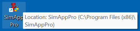

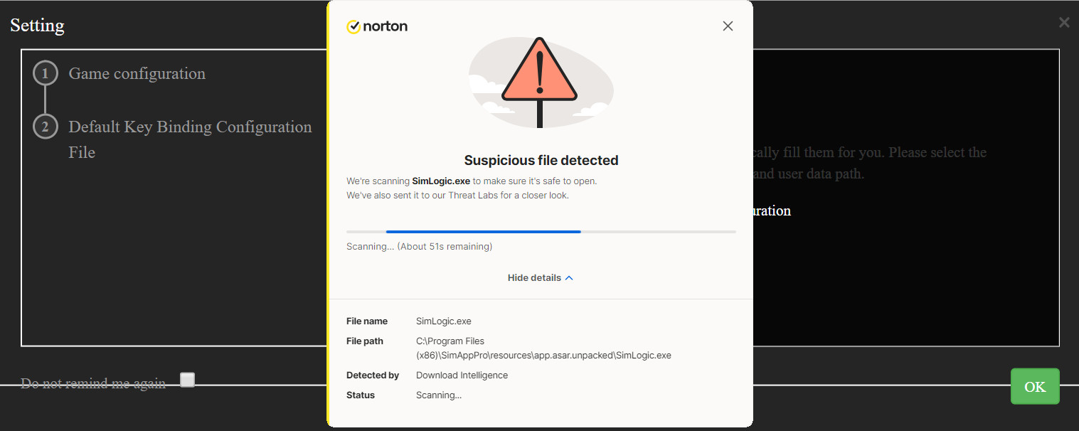

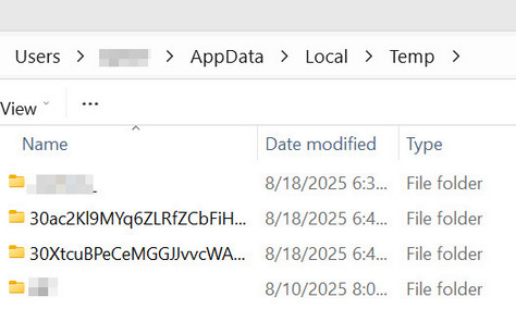

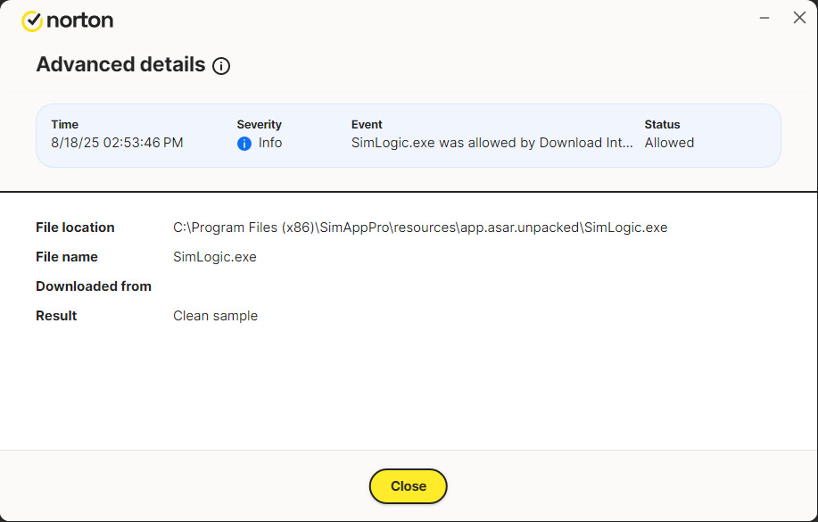

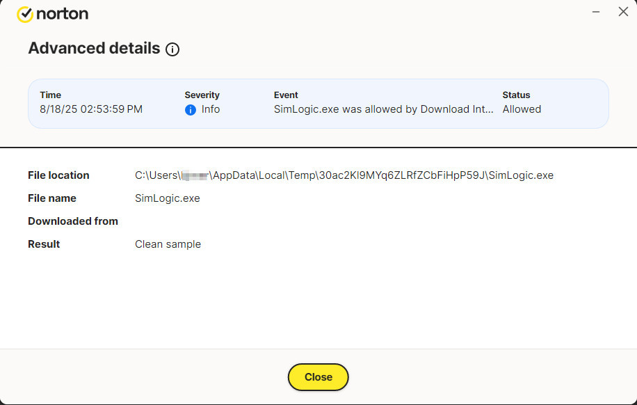

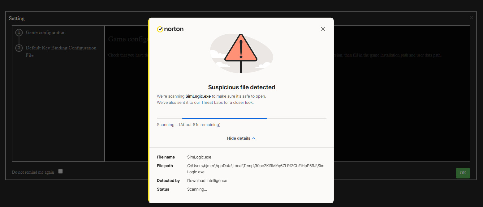

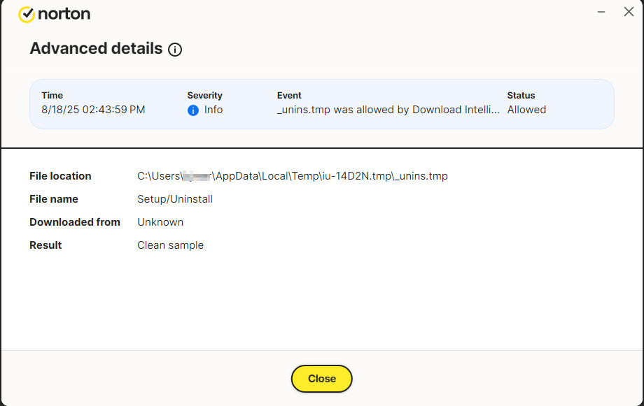

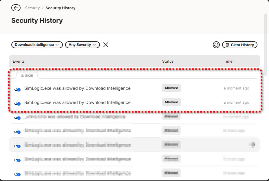

fwiw ~ SimAppPro desktop shortcut call = Download Intelligence (DI) continues to scan SimLogic.exe
and then without DI popup/dialog reporting DI findings.
Security History populates:
I’ve no idea if this scanning is normal or because I’ve not set up (done something) SimAppPro.
I’m wondering whether…if I do something with SimAppPro… then this scanning will stop.
I’ll need OP to chime in with their observations.

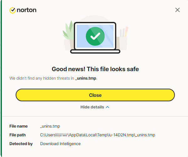

When Download Intelligence scans a file. I’ve seen…for example…

I’m curious what SimAppPro is doing your side…now.

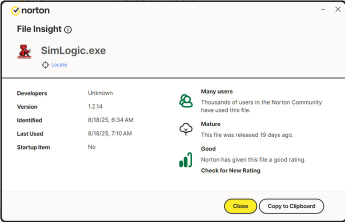

Now, that known Unproven are cleared.
Note: since SimAppPro files are not signed. Norton may never be satisfied.
Hello @bjm and @MrLee_Rose,
Thank you for the very detailed investigation and reproduction of the issue. I’m sorry for the delay and trouble with the file submission.
I’ve checked, and there should no longer be a detection from Norton. If you encounter any, please let me know, ideally with a screenshot.
Thanks again!
