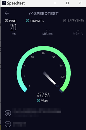

Smart Firewall blocks launch Speedtest
Issue abstract: Smart Firewall blocks the launch of the portable version of Speedtest by Ookla, which immediately starts after disabling Smart Firewall.
Detailed description: Download and run the test. Speedtest by Ookla v1.14.198
Product & version number: Norton VPN Ultimate 25.10.10528 (build 25.10.10528.959)
OS details: Windows 7 Ultimate (x64)
There is no internet connection. Check your connection and try again.

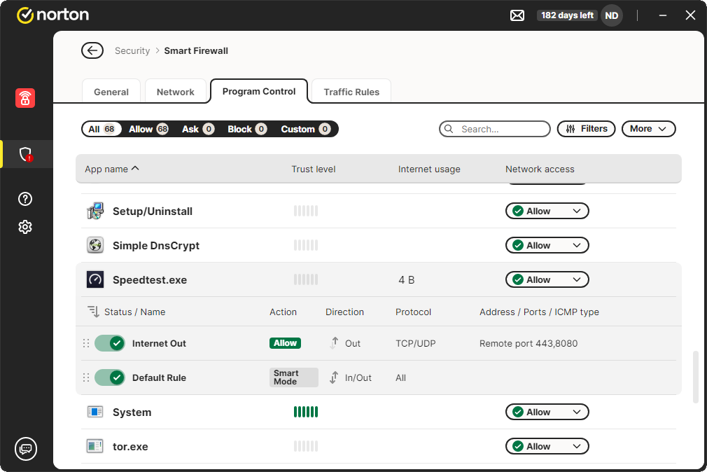

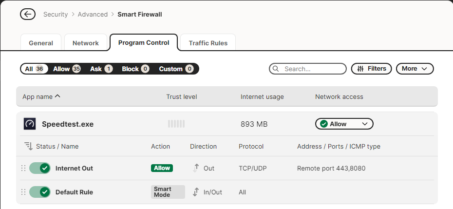

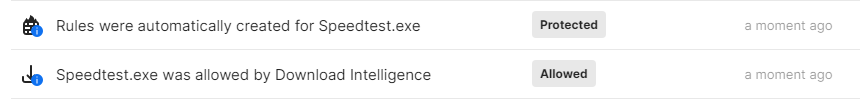

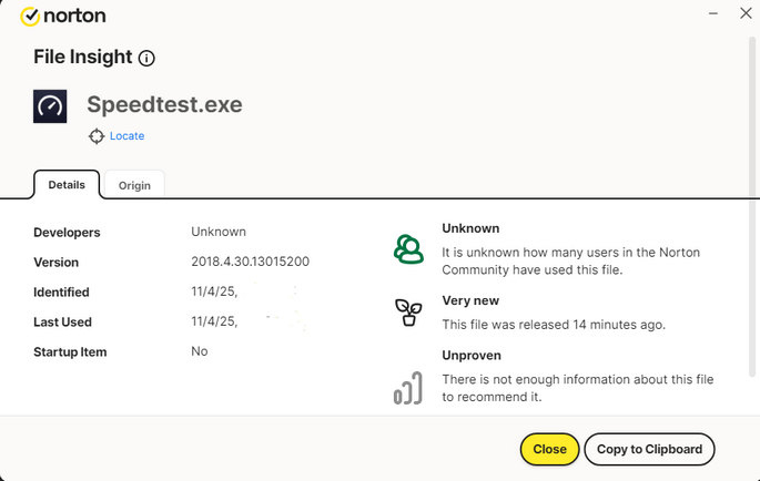

fwiw ~ my Norton 360 chewed on Speedtest.exe for a while…before…I saw Speedtest run.
Developers: Unknown
Version: 2018.4.30.13015200
Identified: 11/4/25,
Last Used: 11/4/25,
Startup Item: No
Unknown
It is unknown how many users in the Norton Community have used this file.
Unknown
The file release is currently unknown
Unproven
There is not enough information about this file to recommend it.
Origin

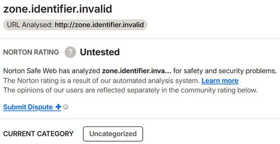

Downloaded from: http://zone.identifier.invalid
File: Speedtest.exe
File size: 48.1 MB (50,485,013 bytes)
SHA256 checksum: FABA6D2978B822E5F5666E4429AD86DD40152976AC1A7BCDCD885B477E392D5D
Date/Time: 11/4/2025
Speedtest.exe is not signed

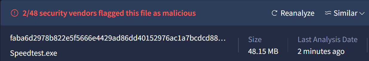

Speedtest.exe was not known to VirusTotal. VT report here

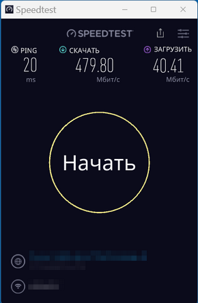

I think I’ve determined that the problem launching portable software (Speedtest and Tor Browser) is caused by Cyrillic characters in the paths. If I create a folder named тест on the D drive and place the portable program there, Smart Firewall blocks Speedtest from launching. However, if I rename this folder to test, the problem immediately disappears.
