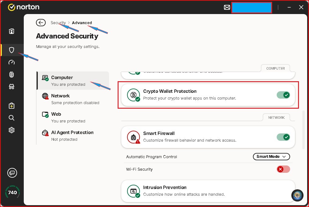

@Don54 I believe you may have gotten the latest version 26.6.11050 (build 26.6.11050.0). Installing it this morning there were red X’s on both the Norton and Defender system tray icons. They were related to the Crypto Wallet Protection setting being disabled by default. I just enabled it and the issue disappeard. Is this the issue you were seeing?
That’s exactly what happened in my case. However, I enabled the protection, and that ‘x’ disappeared.
Norton really ought to enable that by default, because users who aren’t very tech-savvy might think the product is buggy.
Indeed. Having never had a crypto wallet myself others may. Adding this function, for me personally, isn’t an issue.
Norton should ask for its setup via the setup process for NEW customers, those who are reinstalling their products. The issue has been brought to the attention of Norton in an earlier discussion this morning.
Thank you for your reply SoulAsylum. I did not see that as I started my troubleshooting routine by running Repair then Restarting the computers and the Red X’s went away and did not pursue it further as I figured what I did had fixed it. Upon reading your reply I went to Advanced Security and saw that the Crypto Wallet Protection is showing enabled and green so I guess what I did with Troubleshooting and Norton reinstalling 26.6.11050 (build 26.6.11050.0) and the restarting the computers re-enabled the Crypto Wallet Protection. I have to agree with @New_Style_xd that it should be enabled by default as this problem is the first time I have seen this happen. Thank you again for your help as always.
