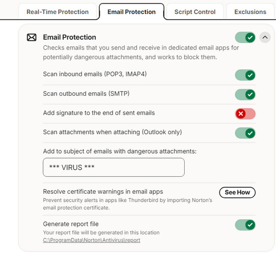

Care to share a screen snip. Curious, whether there’s a “Don’t show again” option with the notice.
I’m not finding a switch to turn off notice.

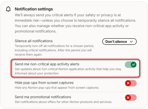

Curious, whether Send me non-critical alerts → off – as test – is worth trying.

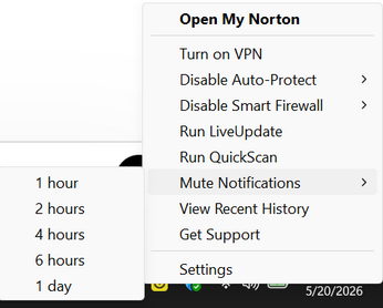

and 1 day is not permanent
