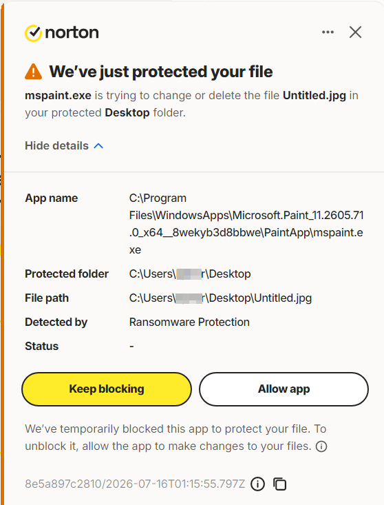

The official Microsoft Paint (mspaint.exe) is being flagged as a virus.公式のマイクロソフトのペイント(mspaint.exe)がウイルスと判定してしまう。

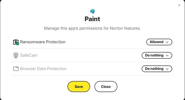

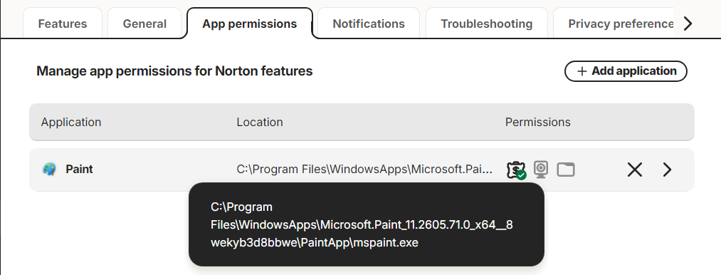

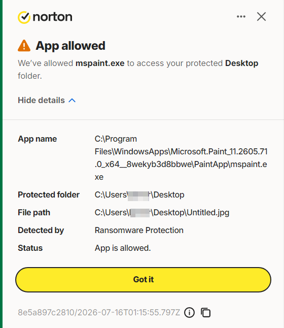

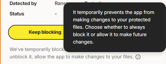

Suddenly, after the July 15th antivirus update, Microsoft Paint blocks saving images after editing them, flagging them as viruses.

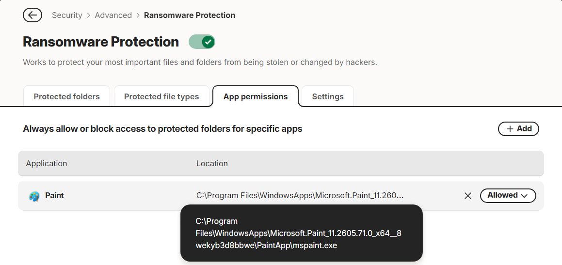

Norton uninstalled the Paint software without my permission.
Currently, I have excluded it from “App Permissions.”
The edited images are legitimate screenshots taken from games.
The app itself is also legitimate, downloaded from the MS Store.
Why is it being flagged as a bug?
This is software used worldwide.
Please investigate and fix this.

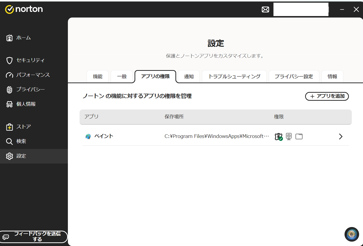

突然7/15のウイルスワクチン更新後からマイクロソフトのペイントで画像加工後に保存する際にウイルスと判定されブロックされます。
勝手にNortonがペイントソフトがアンインストールした。
現在は「アプリの権限」から除外しています。

Protect your data from Ransomware threats
Select a behavior mode for Ransomware Protection
As mentioned in another thread, it’s strange that Norton requires users to configure settings based on bugs.
Ideally, it should provide proper security services by default.
While the method described can be used as a temporary fix, it’s not the intended solution.
This could lead to more similar bugs appearing.
It should be common sense that Norton works correctly with default settings.
Developers should focus on fixing all bugs before creating new features.

HI @SEKIRAM
Issue should be resolved after resolving mspaint.exe as False Positive. Please check from your end.
Thanks.
Dear Developer, the issue has been resolved. Thank you for your assistance.
