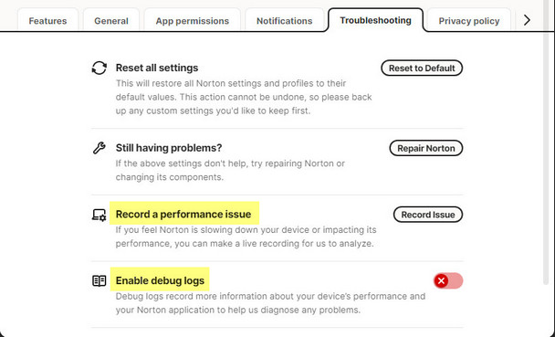

Does Norton VPN Ultimate have Troubleshooting options.
There is no such possibility. And such errors are not eliminated so quickly.
