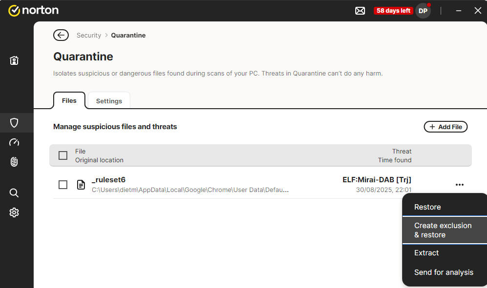

It’s the same on my machines, but I trust uBlock Origin and have excluded the file.

Just confirming that I’m seeing the same detection of ELF:Mirai-DAB in the UBO Lite ruleset6. But only on scans - it is not being detected by Norton on download when UBO Lite downloads a new copy of the file on launch after Norton has quarantined the previous copy.
I’ve also reported the false positive to Norton..
I have also reported a false positive detection.

Looks like the issue is resolved. I received updates of all the UBO Lite rule sets at 12:42 today (UK time) and _ruleset6 now scans OK with Norton - zero malware detections reported.
Meantime I had installed the basic free version of Malwarebytes to perform a “second opinion” scan and that also detected no malware in _ruleset6. But I did the Malwarebyte scan before I realised that the rule sets had been updated. Unfortunately, I no longer have a copy of the previous version to test with Malwarebytes to check if that would have given the same detection as Norton.
Having checked again, the update at 12:42 was not just the rule sets - it was a full UBO Lite update to version 2025.831.1814.
