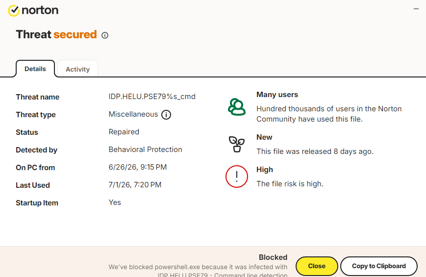

I just started getting this error today on boot. But I don’t know how to identify the program and when I click on “See Details” it just shows me another screen with ZERO information of what was trying to execute PowerShell script. And yes, I’m a software engineer and use JetBrains tools.
When I copy to clipboard I get this:
Activity
Path | Type | Status
C:\Windows\SysWOW64\WindowsPowerShell\v1.0\powershell.exe | Process | Terminated
C:\Windows\System32\conhost.exe | Process | Terminated
C:\USERS\ROBAI\APPDATA\LOCAL\TEMP__PSSCRIPTPOLICYTEST_HRBGTWTH.G4N.PS1 | File | Deleted
C:\USERS\ROBAI\APPDATA\LOCAL\TEMP__PSSCRIPTPOLICYTEST_5EUN1XFL.OEK.PS1 | File | Deleted
C:\USERS\ROBAI\APPDATA\LOCAL\TEMP__PSSCRIPTPOLICYTEST_RBD2N25A.BPS.PS1 | File | Deleted
645A917389B470269DF99A4A0BF978F0 | File | Deleted
This message is pointless and doesn’t help me at all? What the heck does Norton expect me to do about this to determine if it’s valid or not and setup and exclusion? I already have exclusions for Visual Studio and JetBrains folders.

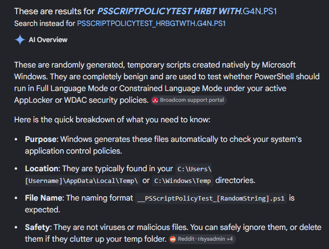

So a google AI search reveals these files are standard temp files Windows creates and are benign … so the question is why is Norton flagging them … I thought Norton used AI also to determine false positives … I mean heck, if Google can, why can’t Norton?

Additionally your screenshot of the detection references powershell v1.0 which is seriously antiquated. Windows keeps that folder naming intact for backward compatibility, but I have to ask what PS version are you using?

Anyway, the items flagged have NOTHING to do with JetBrains, they are standard Windows temporary scripts as outlined by Microsoft. But Norton does NOTHING to show me what’s in the PS scripts that they deem a threat? If Norton is unable to determine a real threat vs. standard processing, then what sort of AI processing are they using … it’s clearly not working.
And finally Windows has PowerShell natively part of the OS installed and it’s version 5.1. And the folder name is NOT the version of PowerShell being executed, it’s simply a compatibility reference, if you actually look at the PowerShell.exe located in the SysWOW64\WindowsPowerShell\v1.0 you’ll see it is NOT version 1.0.
