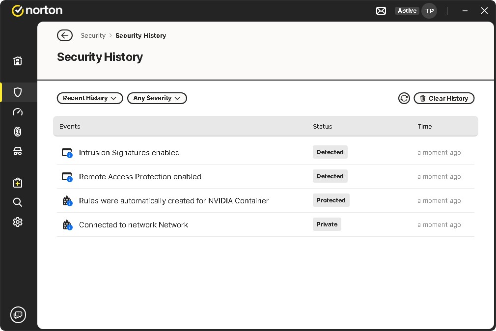

Yes, I do understand that NetBIOS is an old protocol with security limitations but I kept it enabled as it allows for simple network discovery of other devices on my local network, in particular my Synology NAS, when using File Explorer on the PC. I have now enabled an alternative to NetBIOS discovery by turning on WS-Discovery in the Synology settings (it’s OFF by default). I now only turn on NetBIOS to check whether each new version of Norton has a fix for the bug that crept in with the first release of version 25 - the bug that floods the Security History if NetBIOS is enabled. That bug was a significant driver in the early posts on this topic. Irrespective of the merits or otherwise of NetBIOS, the Norton product should be able to handle NetBIOS being enabled without repeatedly setting up firewall rules for it multiple times per second and flooding the Security History..

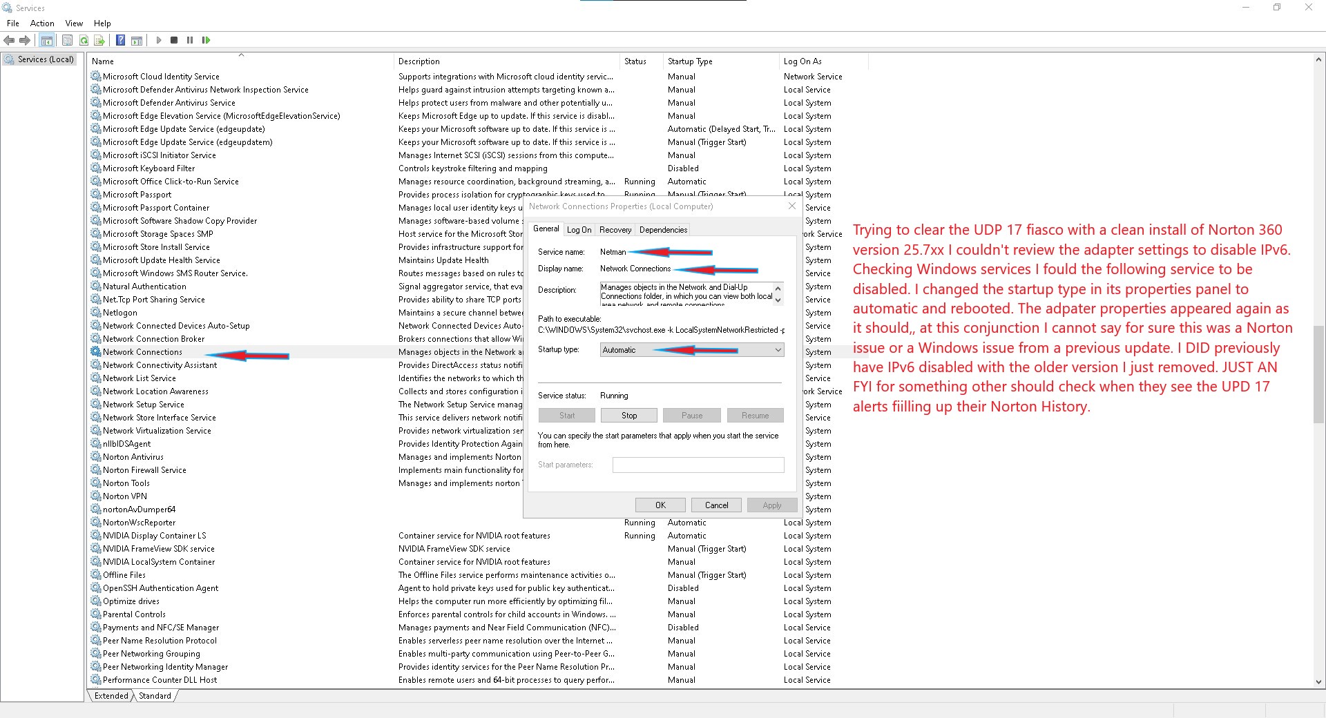

FWIW!! Need a memory jog here, I just did an removal of the older version 22.24.8.36 N360 and did a clean install of the latest version 25.7xx . The UDP 17 crap is once again filling my history. Disabling IPv6 on my network adapter and a reboot didn’t change things. Having been away from the latest version for a long time I need a memory jog for what others have done to fix this mess since we did it way back. Reading this entire thread, of 318 posts is tedious at best. TIA!!
On a side note, I DID find that after the install the service for viewing and changing the network adapter settings was disable in Windows services. I changed the startup type, saved the changes and rebooted. Something other may want to watch for when doing updates to their Norton installs.
Well, I INDEED had a hard brain-fart moment lol. Forgot to disable Netbios over TCP before the restart. Checked history and the UDP 17 crap is no longer being logged.

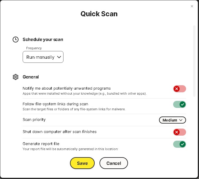

Just some info for those who are doing new installs. In Norton main settings under scans, there is a cog icon that will appear near the right side of each scan type when hovering your mouse there. Make sure you set your scans to generate a report when they are done. There is a link shown where these reports can be reviewed as well. Please review the below screenshot:
