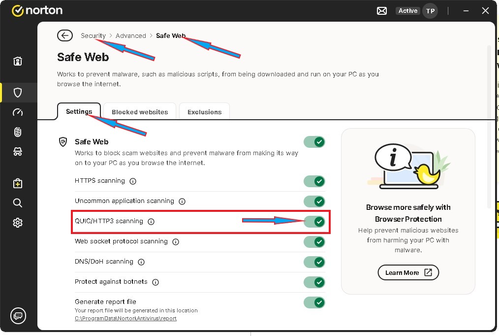

It happened again after flushing DNS. I cannot reach any website with any browser. Games also cannot go online. I can ping 8.8.8.8 and other IPs. The only way to get it working is to restart the PC. Disabling N360 doesn’t fix it.
This is happening on 2 PCs with N360 installed. My work computer, with a different antivirus, is not experiencing the problem. It is also connected via ethernet to the same router. So I know it is a recent N360 update that is causing this. When will this be fixed? Should I move to another brand of AV?
Disable the setting shown below and restart the machine. Recheck for anything changing. I’m not seeing the issue appear on Opera GX or Edge, current versions.

I will try that and let you know if the problem is resolved. Will turning this feature off lessen my protection?
Thanks for taking the time to help. Appreciate it.
Thanks for the post back, let us know if anything changes for the better. Changing that setting won’t put you at risk. Here is what that scan is used for. HTTP3 IS NOT in widespread usage as of yet, in time it will be so I believe Norton is getting ahead of the game on that. Conversely, I also suspect that scan to have a lot to do with the UDP 17 scans in Norton firewall filling up our Norton history. There is a workaround for that as well, but the issue is it shouldn’t be happening. If I can ever nail down QUIC/HTTP3 as the cause that will be a wonderful day indeed.

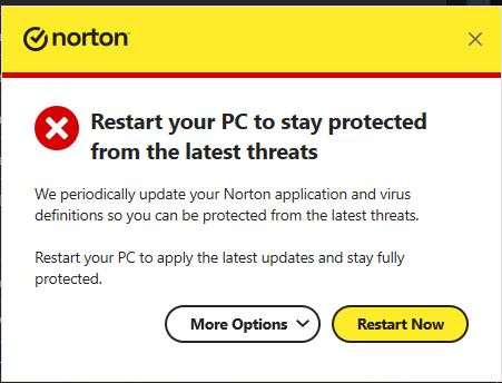

Had a scare today. Running v22 with Live Update OFF. Lost my Verizon FIOS and when it came back this was on my screen. I did NOT initiate this at all. I noticed a Microsoft Security update had been installed at some point requiring a reboot. I was hesitant to reboot for the patching of the OS, but I closed the Norton alert with the X not selecting a choice and after reboot thank God v22 is still there. I made sure LU was still unchecked and it is. No idea what happened.
Update: I contacted with Norton via chat (a real person). I took at least 30 minutes to explain the full details. The agent listened, I gave screenshots, info etc. He/She promised to escalate the issue to the developer team. But he/she assured me confidently that blue info notifications are normal in this case.

Seems turning off Quic/Http3 scanning helped. I do not experience the issues anymore and overall web browsing is faster. Thanks for the help.
You’re most welcome!!

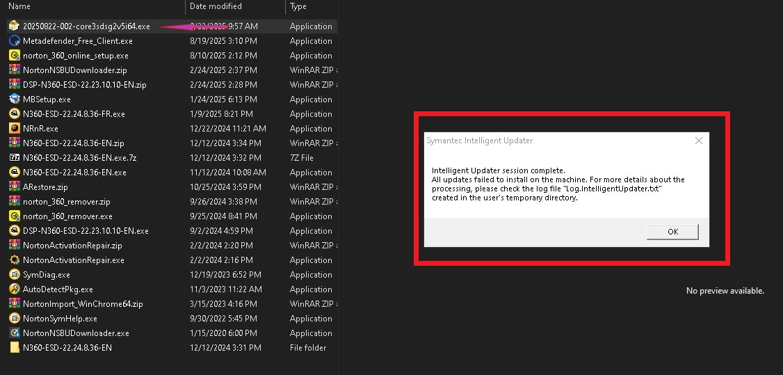

I tried that when I noticed Norton wasn’t downloading definitions, Seems like they removed the definitions downloaded number in norton,

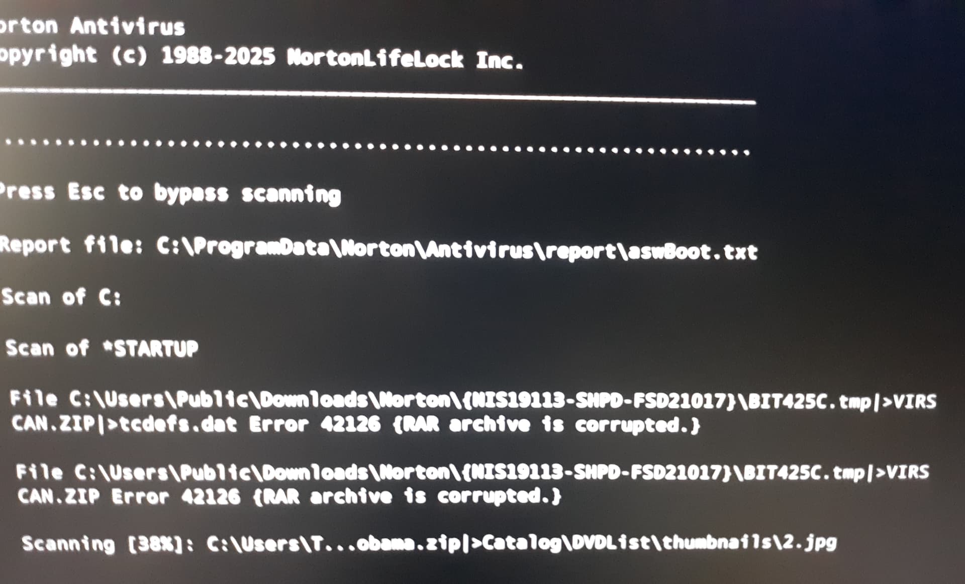

I tried those for 64 bit and it failed, then tried to run a startup scan and saw this error related to the install failed after doing googling research.
broadcom mention of virscan.zip
I removed and reinstalled norton, but with them hiding definition download numbers, can’t tell if it is downloaded and working now.

@frugalfreak What version are you on, please refresh my memory. If you are version 24.xx or 25.7.xx, the definitions from Symantec Intelligent Updater DO NOT install on those versions. Please see my below screenshot as a reference. I’m thinking the updates for these versions are solely web cloud based is the reason. The way the new versions are structured to use those services is the most likely culprit whether its by design or something that needs to be addressed by Norton.
Log.IntelligentUpdater.txt (6.3 KB)
Here is the installation log from my machine. The required registry keys are being blocked by Norton for the Intelligent Updater installer to perform its job. I have asked for clarity on this from Norton. Hoping to have a clearer answer soon for you all.

I see. Just trying to help as always. I was just pointing out that if you are on the most current release the intelligent updater won’t install definitions for that version. I have asked Norton why that is the case either way. From what I see there are missing registry entries the IU looks for that are not present with the current Norton release. Therefore the failure to install.
